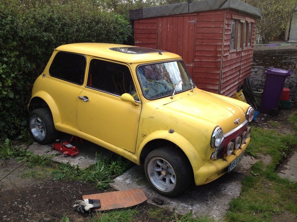

Here it is now:
Yes, it is in a sorry old state. It did have a Monsoon car cover on it for a number of years but the cats wrecked that to the point where it was useless so that was removed about two years ago.
The car is fully goodies though. I'm not so emotionally attached to it any more and think it's time to either sell as is, or sell the parts off it.
But for now (and purpose of selling) I'd like to get it fired up. The Engine is a 1380, single HIF44 carb, Med head, etc. Can anyone offer any advice or step-by-step check point in trying to start it? The engine was last started about 2+ years ago. About 18 months ago I emptied the oil out of it so first thing is to put oil in. Fuel is obviously stale - not even sure if the fuel lines are ok. I've an electric fuel pump in the boot. What is the best/simplest way to get a little bit of fresh fuel to the engine? should I empty the tank? Should I flush out the lines to the carb somehow?

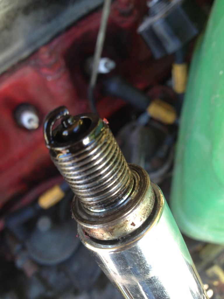

Just going to nip down the station and get some fresh stuff. While it was emptying, took of one of the plugs (No. 4):
Looks a bit oily! Will clean them off. check the gaps. Thats it really.

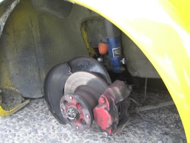

By the way, this was the little fella in his Hay Day:
and this is what happened when the wheel came off doing 70 on the motorway:
I've lost to much sweat, blood and flesh to stop now!
kona
Posts: 587
Re: Reviving an old mini - trying to fire it up
Post by kona »
Did the bolts just shear off there!?

kona wrote:Did the bolts just shear off there!?
I think so. It all happened pretty quick. We were in the outside lane of the motorway doing about 70. There was a shuddering noise for about 4/5 seconds and before i had chance to react, bang! The wheel came off!
I think what happened was that I may have not tightened the bolts up before we set off. They worked loose at that moment and then pressure of the loose wheel sheared the bolts off. As opposed to the bolts failing. Who knows...

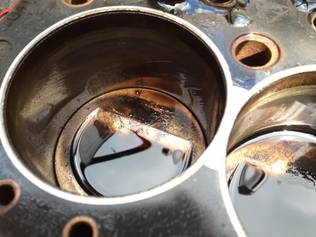

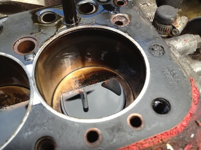

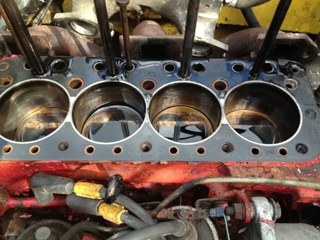

Ok, so managed to get the head off.
Here's the bores:
I'm not sure the pictures do it justice but they look fine. Which is all good! The oil in the dish is the bit that I put in the chambers to lubricate.
I don't want the engine 'open' any longer than I have to so tomorrow I'm gonna get the head to Lloyd in Delgany to confirm/fix the valve stem oil seals. The chambers on the bottom of the head could do with a de-coke before it goes back on too.
