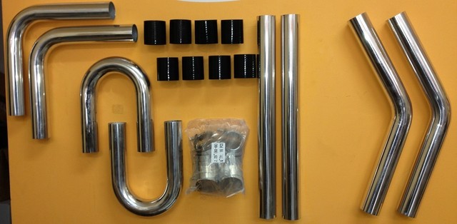

Posts: 2838
Re: Project minza
Where did you get the pipes from? presume there for the intercooler
