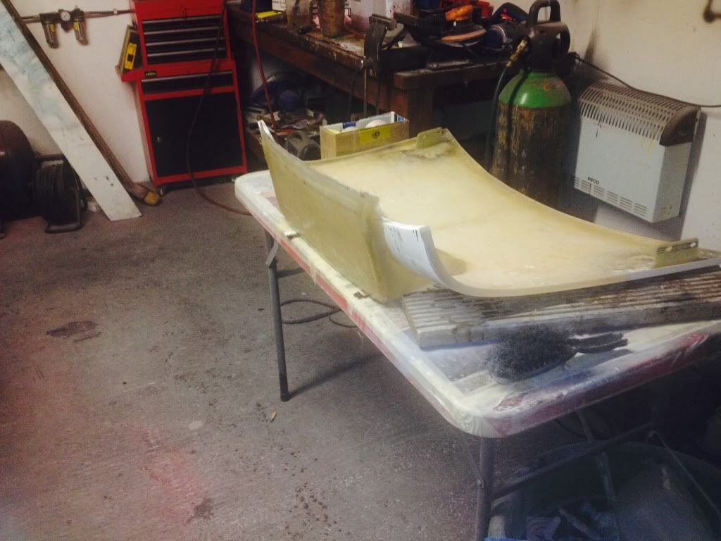

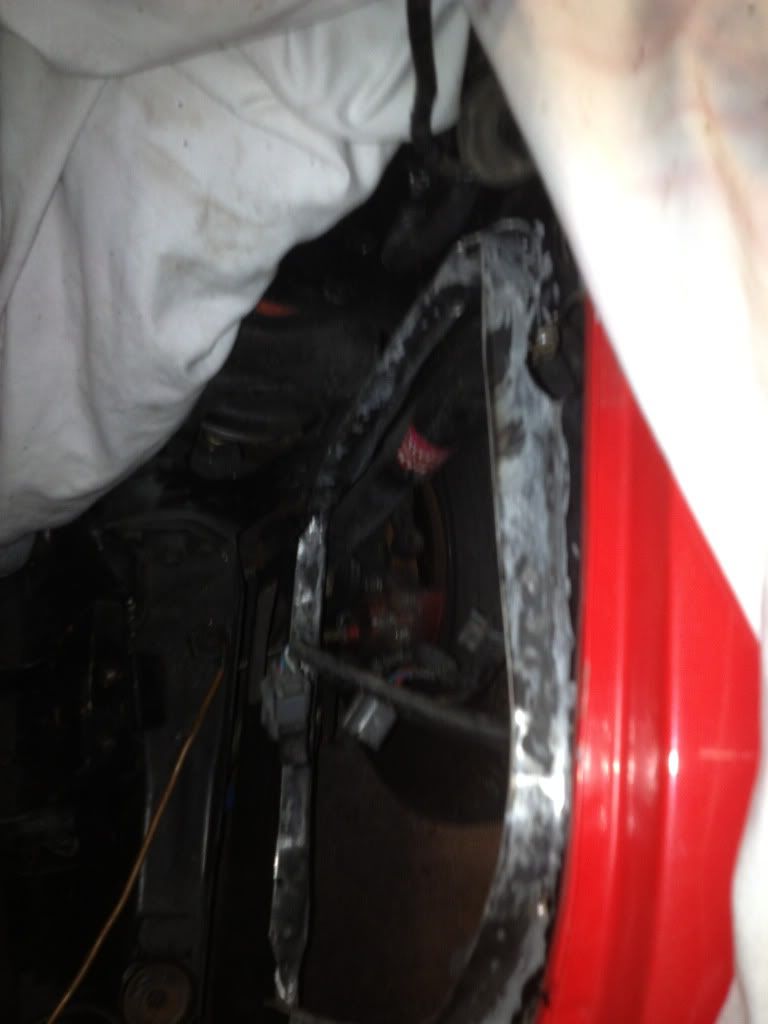

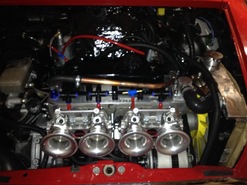

Right an update.
Just can't leave it be. Have that famous rattle at idle, which disappears when I sink the clutch.
So out withe the engine to sort out the idler gear bearing.
While I have it out I cut a big hole into the side inner arch for extra cooling.
As am gonna put back in a side mounted rad. That way u can run a 7 port elder head which I ordered.
Can't wait to see if it will make as much power as they claim.

Re: 92 mini aka bibsi

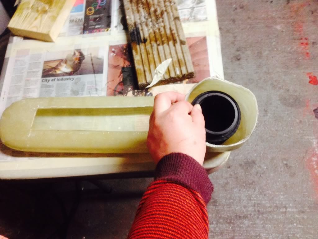

Here are some pics
And while I was grinding off the edges this happened.
******* sore but one can't stop now.
Just rolling back the edge to give the panel some strength.
Does any one know where I can a sheet of grille mesh in stainless steel.
Cheers fellow mini fans.

I always use the mesh that u use when plasting a house ask a builder they mite have bits living round

Molly is that stuff out of stainless steel?
- DaveC
- Posts: 1532
- Joined: Sun Feb 06, 2005 10:52 pm
I think it comes in stainless or galvanised, Expamet or expanded metal lath
- Posts: 264
- Joined: Tue Mar 01, 2011 9:08 am
- Whats your location?: ballymote co.sligo
- What Minis have you?: 1293cc mini :-)
Im not sure but it doesn't rust
Cheers guys off to the builders I go.

Bargain of the century 6 euro for a sheet 8 *2 of this stuff.
Seen the mesh for car grilles for like 30 what a rip off.
Thanks guys.

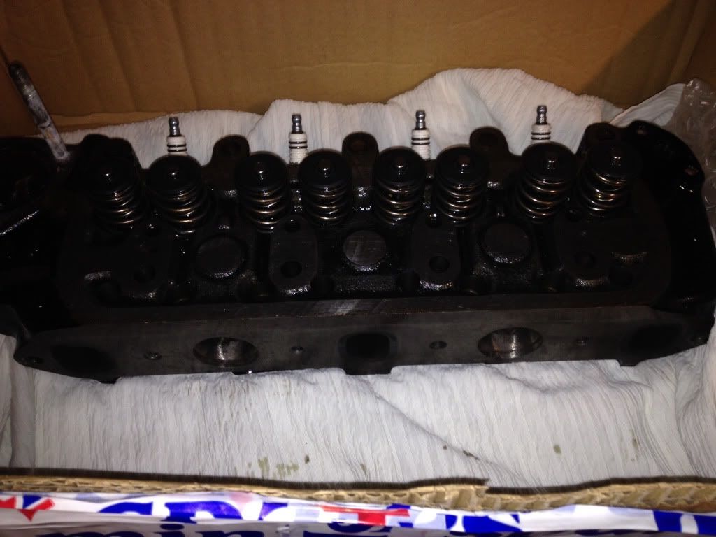

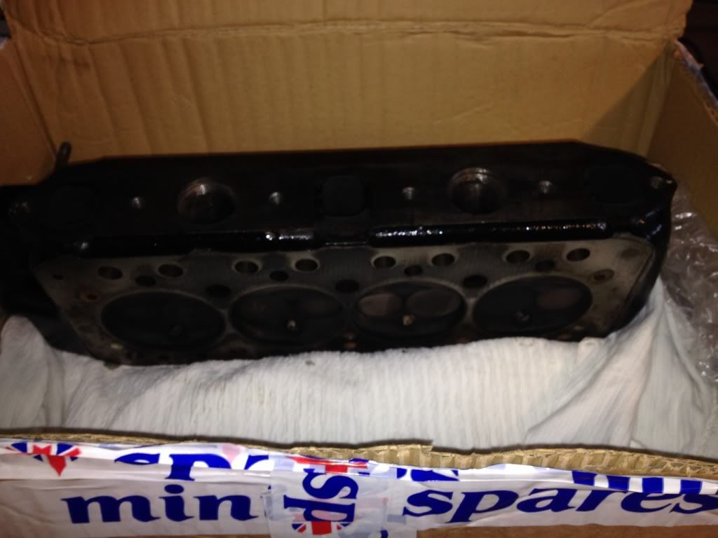

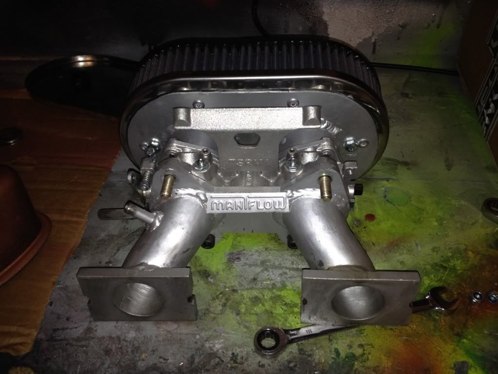

Hi Fellow Mini fans
i am selling some items from this build as i'm changing my setup to a 7 port head.
see the for sale section as well.
Maniflow intake manifold with
Jenvey 45 throttle body and trumpets with K&N air filter
Injectors not included
330 Euro
Cylinder head with porting done by myself.
Spec is 21EN hardend Stainless steel valves 35.7 inlet 29.5 outlet.
220lb double valve springs.
3 Angle valve seats on Inlets and exhausts.
This head was used for about 2000 miles only without any sign of trouble.
340 Euro
Pickup only as postage for items would be ridiculous.
Gave 89.4 HP on rolling road with standard 1.3 rockers and a RE13OT cam from CalverST in uk (Engine Size 1293cc AE Hepolite pistons). Have graph from rolling road to proof it.
Thanks for looking.

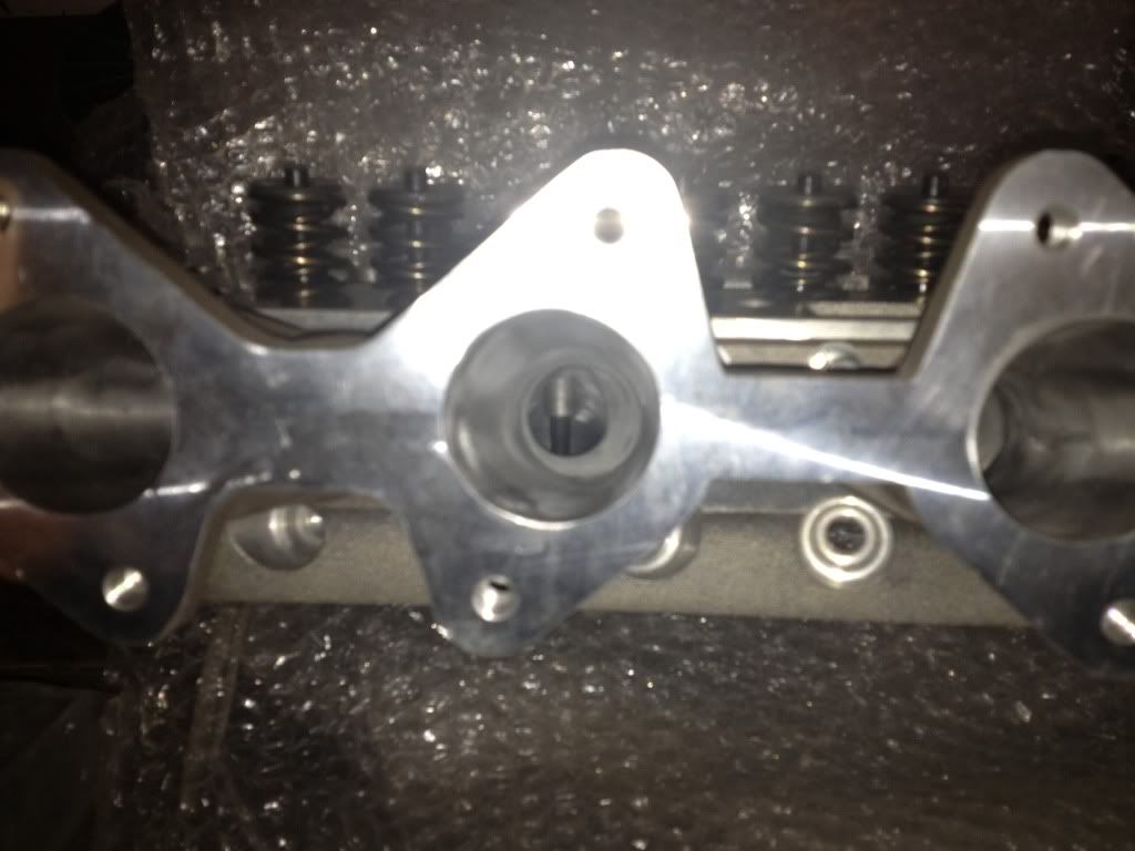

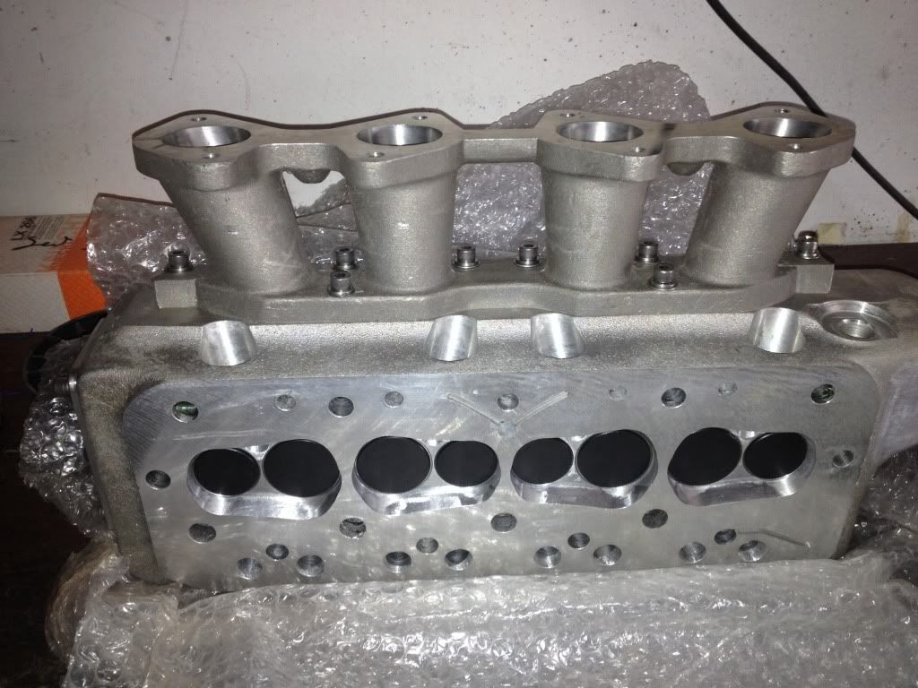

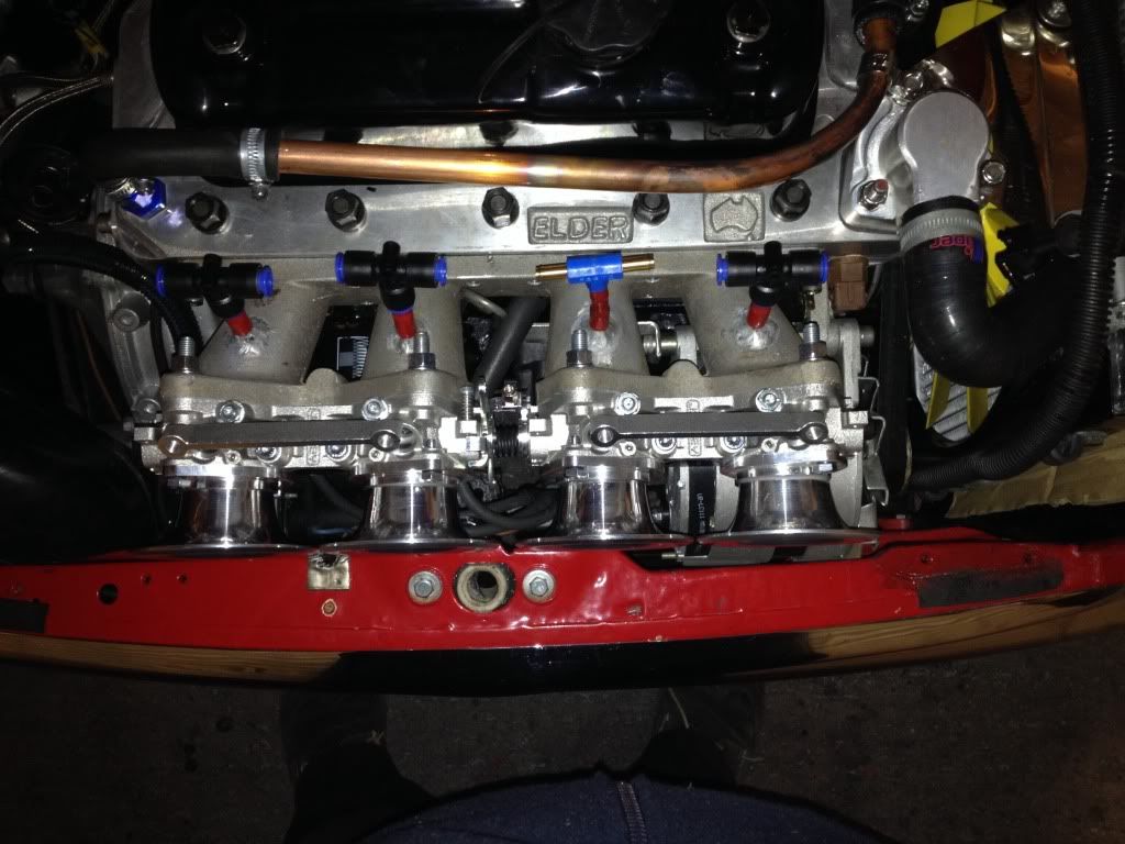

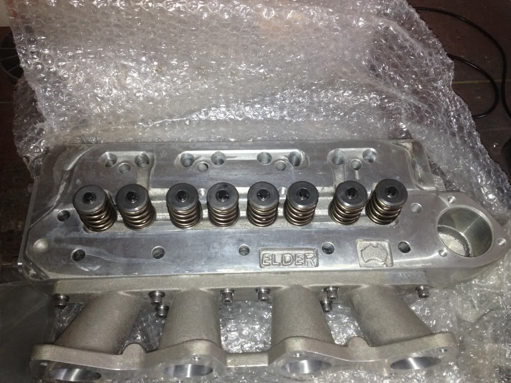

After a long wait the new 7 port head has arrived.
Post apparently lost it and once i started asking questions the head arrived 2 days later. Typical.
Anyways here are some pics of the Ken Elder head:
thats one straight shot to the back of the valve.
different shape then the usual heart shape. The valves are further apart then normal.
The head is about 18mm thicker then a standard 5 port head. just as well they supply new head studs.
Head of to machine shop to get some additional holes drilled and tabbed for sensors and cooland takeoff for heater etc.
might have it running by this weekend.
Right an update
The head is back from engineering shop have second hole drilled and tapped for ecu coolant sensor.
Drilled and tapped the coolant takeoff in the front for some fancy an8 fitting.
Head is on the block and as I went to torque it down I realised that the rocker posts will need spacers. Looks like I'll be waiting another while now as I have non and it's nearly cheaper buying them then making them.
Pics to follow soon.
The intake with injection bodies and trumpets are damn close to the bonnet too. Must figure out how I will get an air filter in there without cutting the bonnet.
What do other people do with 7 ports I wonder.

Short update
Have the ken elder head on and the injection throttle bodies installed.
The lot just fits under round nose bonnet but the bonnet catch and spring lock pin are in the way.
By the time I have the air filter on that it's gonna be tight. Locks like I'll be needing one of those fiberglass bonnets too.
oooow, that does look nice!

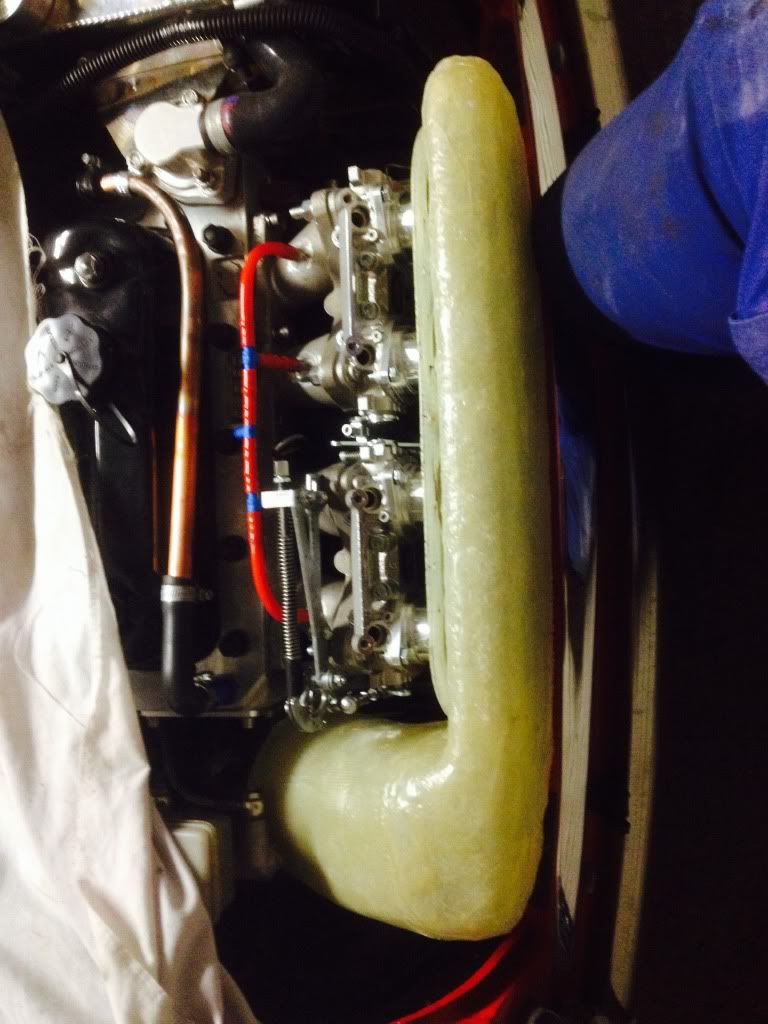

Right an update. Made another air box from fiberglass using the lost foam method.
Here's some pics
And roughly in situ
Super tight fit.
Fiberglass bonnet will need modifying too.
More later
Here's some pics
And roughly in situ
Super tight fit.
More later

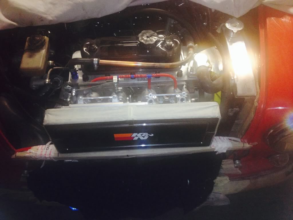

Right ditched the idea of that air box and went and bought a k&n one as I would have to mod the bonnet anyways
Here is the start of the bonnet.
Might have the bonnet finished this weekend.
Don't know how I'm going to keep it closed yet though
Duct tape and cable ties!coolmini wrote:Might have the bonnet finished this weekend.
you could try some Aerocatch panel fasteners, like these - http://www.murraymotorsport.ie/products ... -plusflush
personally I'd stay away from the spring hook set up, the bonnet will make the mini look like it's trying to eat the car infront at any speed and will have your heart in your mouth as to whether it might just fly open on you (speaking from personal experience)
Cheers but they won't fit as the box section is too wide. I have some here and dough. Homer moment. Have some dezus fasteners too but I hate the whole alignment part of them. Any other ideas ? Was thinking of the bonnet belt type straps. Are they any good?
- Posts: 2820
have to say have loved the enginering up to this point but this bonnet is not looking good. 8 port heads have been around a long time without big bonnet bulges, work on it
