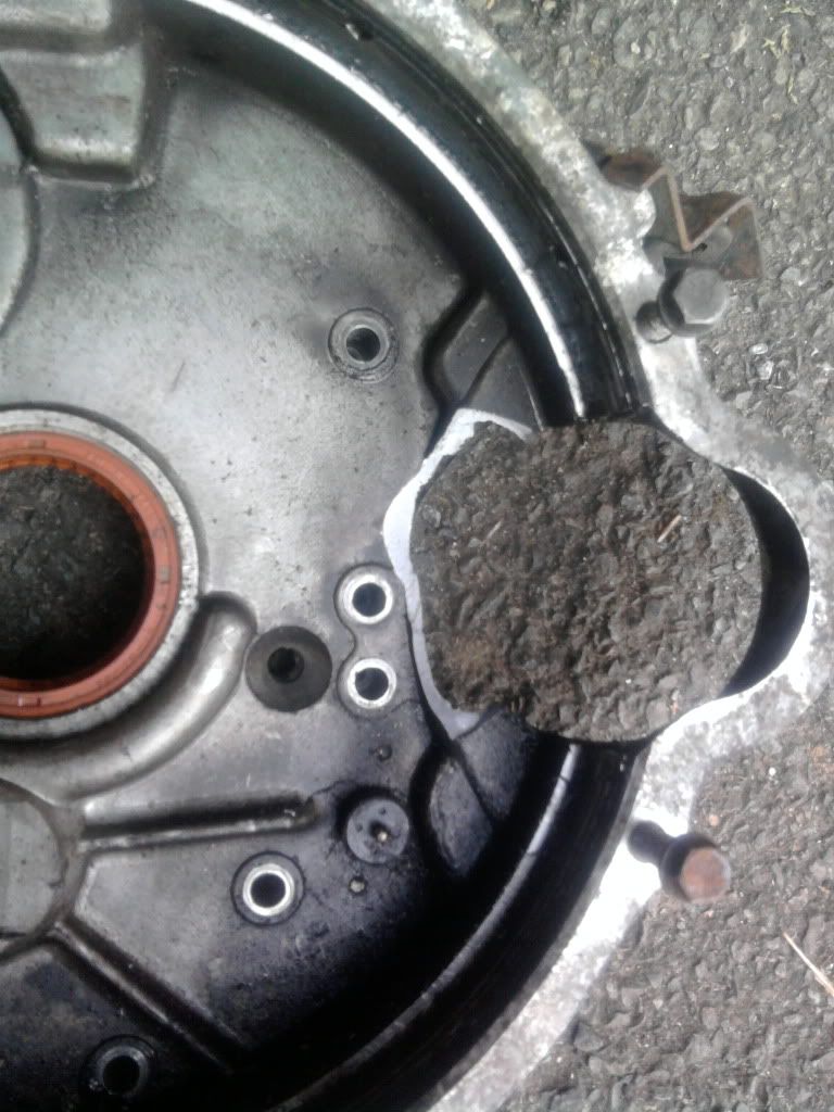

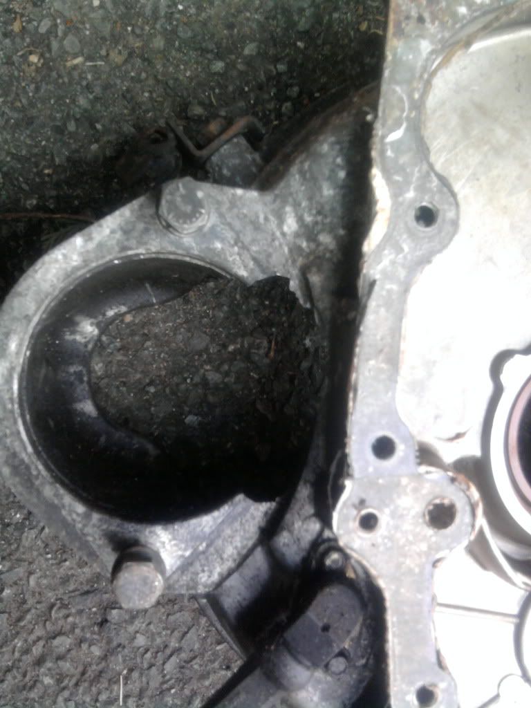

wahay after a bit of heat she popped, its a standard metro flywheel. i didn't use the bolt with the puller because the laser kit comes with like a block of round bar for it. the lump that broke off i have attached a pic of... can anyone say if its repairable or scrap?? are there replacement items redily available? are mini and metro ones interchangeable??

Hi davey I remember Reading on another forum if the housings your swopping are both A or A+ it should be ok but one of the lads on here would know for sure. I did the exact same damage as you but not as severe as for buying one somerford mini should have them, doubt they'd be cheap though

if u are stuck for a housing i have plenty of them here

There is a difference in the size of idler bearing

jocelynn, would you have a metro 1275 housing??... i will try and find out if a+ mini housings will fit and let you know how i get on.... thank you for the offer
TMG, i take it the a+mini won't fit mine?

Re: flywheel puller
You can change the bearings from the damaged one over to the new one but you need a special blind bearing puller to remove the old bearing and sleeve without damaging the casing.
Re: flywheel puller
All Metros are A+ as is your housing but I think yours is SPi or MPi as it has a crankshaft position sensor and I don't belive these were ever fitted to Metros. If your running injection you'll need a housing with the sensor

The Marcos Graveyard wrote:You can change the bearings from the damaged one over to the new one but you need a special blind bearing puller to remove the old bearing and sleeve without damaging the casing.
There is an easier way to remove the bearing, find a socket that is as close as possible to the internal size of the bearing, then pack the bearing full of grease, hold the socket over the bearing and hammer it in, the pressure from the grease build up will force the bearing out, done it loads of times so i know it works.
