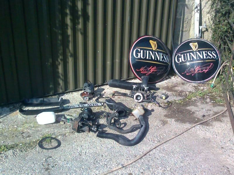

A good day for washing and drying:
All part of being ready for the bodyshell's return.

That's gotta be good for the headlight lens.

I'll be changing them. I don't like the flat lens and whatever way they were doctored previously, the light height adjustment didn't work.The Marcos Graveyard wrote:That's gotta be good for the headlight lens.

where are you putting the huge Guinness stickers?

Earrings for Majella.

i taught they were new fancy hubcaps for the mk1???keith wrote:where are you putting the huge Guinness stickers?

There the IMOC IMM'11 door badges but only for members DRIVING there

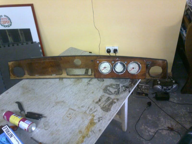

My old wooden dash had been damaged by water getting in behind the wide widescreen rubber and looked like this:
I bought a 2000 dash from Emma (Em1) and a clock from Bert and transferred everything over so now I'll be using this:
The original MPi oil temp gauge doesn't serve any purpose and as Woody said earlier, they never appear to move so I've to think of something useful to fill that gap.

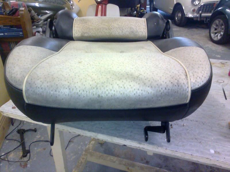

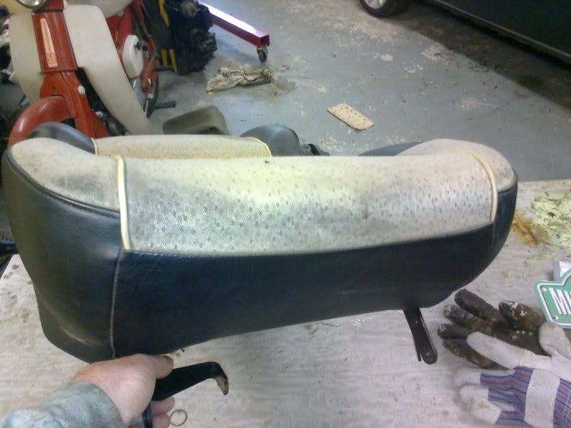

The seats looked like this:
and now look like this. It's not a great photo but the Lidl cleaner made a big difference, especially once it was hoovered afterwards:

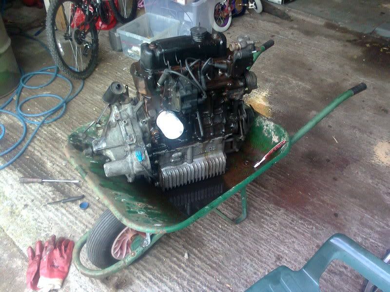

The trusty wheelbarrow is put to use again, this time for engine de-greasing:

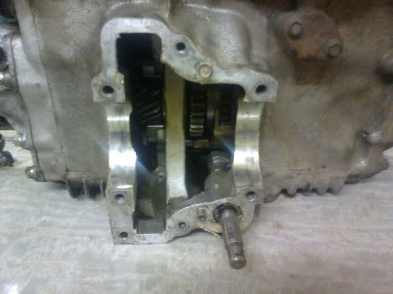

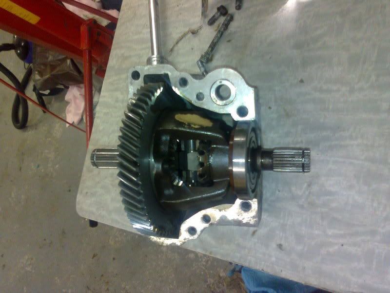

I've removed the diff housing to take a look inside. Mpi's came with a 2-pin diff which has a reputation for shattering as I know from when the original gearbox calved (local technical term) last year. This was due to Rover specifying a lighter oil than 20w50 which increased wear in the diff. Even though this diff looks fine, I'm changing it for a stronger 4-pin diff for reliability. Call it preventative maintenance.
