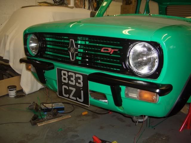

I had an idea of the way I wanted to style the car and it was to remove as much of the chrome as possible from the Mini and retain the green and black theme.I always liked Escort half bumpers so I decided to make my own.I got a solid front bumper,cut it in half and used the off cuts to make end caps for the bumpers.I then got them sand blasted along with the under-riders so that the matt black paint would stick to the chrome.
Bumpers awaiting paint.
I also got the grille and rear bumpers painted at the same time to ensure they all had the same mattness.Here are the bumpers and grille on the front of the Mini.

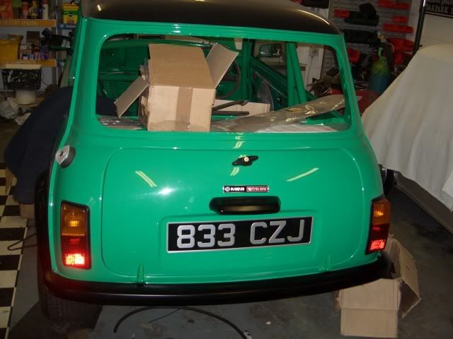

I also treated the rear light cluster to the same treatment along with the number plate light holder.
I also gave the GT badge the green and black treatment.

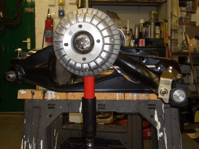

I removed all of the suspension gear from the rear subframe and along with the radius arms and back plates,I sent the whole lot off to be blasted and powdercoated in black.I built up the frame with all new copper pipes,braided hoses,Hi-Lo's,Minifin drums,adjustable camber brackets and Spax shocks.New cones will be fitted at a later stage.
I also used DSN billet alloy subframe trunnions and handbrake quadrants just because I like the look of them :D

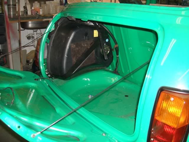

I fitted an MPI tank I picked up at the IMM in Birmingham and maybe in the future I will add a twin tank.

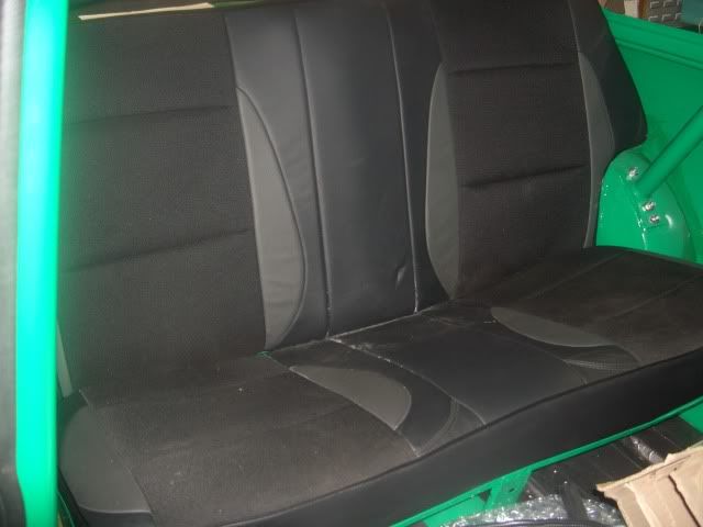

I bought a set of MG ZR seats on ebay and I got a guy in Dublin to take the cover off the rear seat and fit it to a Mini rear seat. I also got him to fit a back headcloth as well.

Is the badge above the rear reg light a 1275gt badge?

StanO'Toole wrote:Is the badge above the rear reg light a 1275gt badge?
looks to be ahrght...

The Mini will be on 10" wheels Dave,I bought a special set way back when the celtic tiger was on the go.To answer a couple of the other questions.The badge is indeed a 1275GT badge and the colour scheme is Java Green BLVC208 and the black is the same as used on RSP Coopers.I got the side and rear windows back from the window tinters yesterday and fitted them.I went with a 50% tint on the rear and side windows and a 65% tint on the door windows.I also got the engine fitted and started on the gear linkage but I could not finish it as I am missing a bolt for the gear box end.I also started making my own interior panels.I am having problems with my camera and I will post pictures as soon as I sort it out.

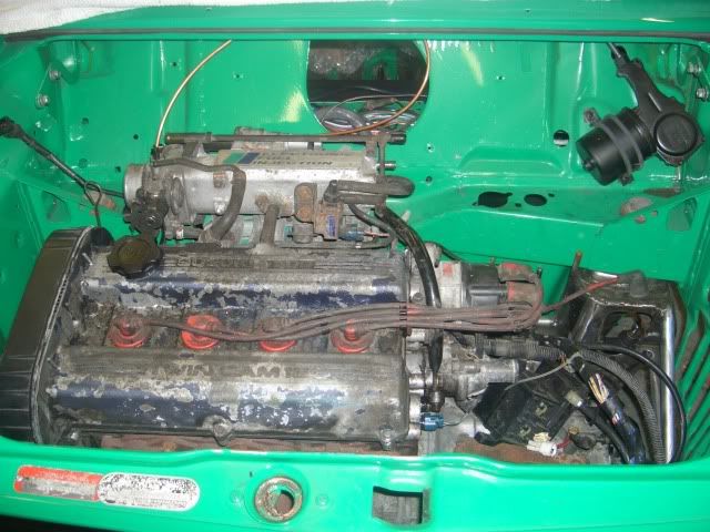

Here is a picture of the engine in the car.It is a tight squeeze at the bulkhead but after a bit of fiddling I managed to get it into place.I am hoping to have a front mounted rad as there is room for it.

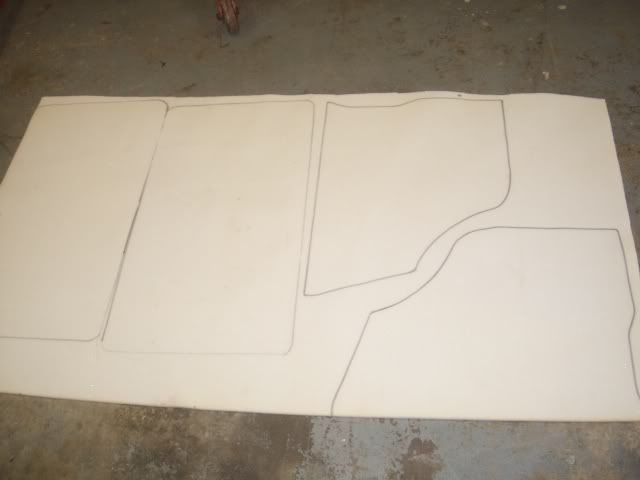

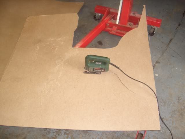

I started the interior panels as well.I got an 8x4 sheet of hard board from a local builders merchants and using old panels I cut out new ones using a jigsaw.
I then got some 1/4" foam from an upholstery shop and cut this out in the shape of the panels.
I used EvoStik 528 contact adhesive and stuck the foam to the hard board.I them got vinyl that the trimmer had given me to match the rear seat and I cut out the patterns to match the panel.I used the EvoStik adhesive to stick them to the foam and I have to say I am pretty happy with the end result.I have only finished one quarter panel but I hope to finish the rest during the week.

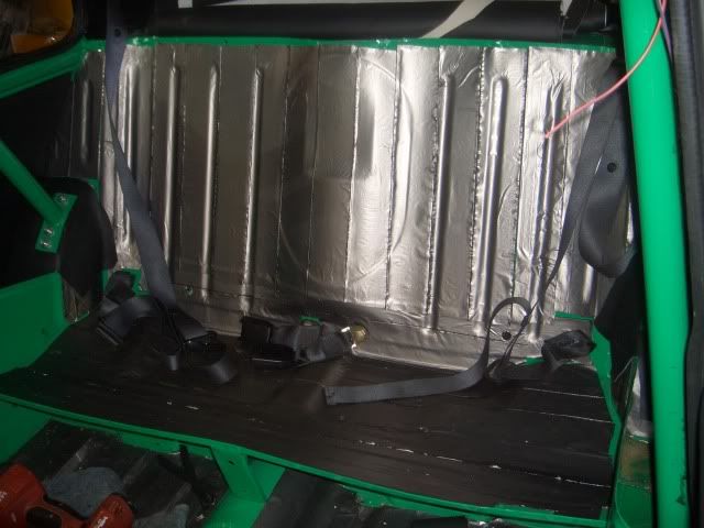

I finished the door and quarter panel cards but before I could fit them I needed to put on some sound deadening.Here is the quarter panel.I also put sound deadening material on the inner door skin and also on the door behind the door card.
Here is the rear seat pan with sound deadening material fitted and also the rear seat belts.

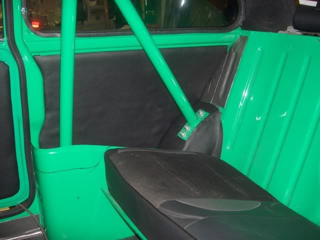

This is one of the quarter panel cards fitted and I also cut and fixed some vinyl to the rear inner arch.
This is the back seat fitted with the belts.It is a really difficult job to get the seat back into place with the cage in place

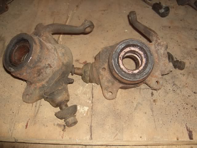

I have had the front hubs ready for a while and this is what they looked like when I stripped them off the car.

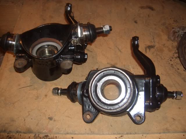

I kept the old ball joints in place and just knocked back the lock washers and I used a hole saw to cut two big washers from a sheet of steel and used threaded bar to keep them in place over where the bearings would be so that no powder coating would get into the inside of the hub and when I got them back I stripped off all the blanking stuff and rebuilt them with new bearings and ball joints.

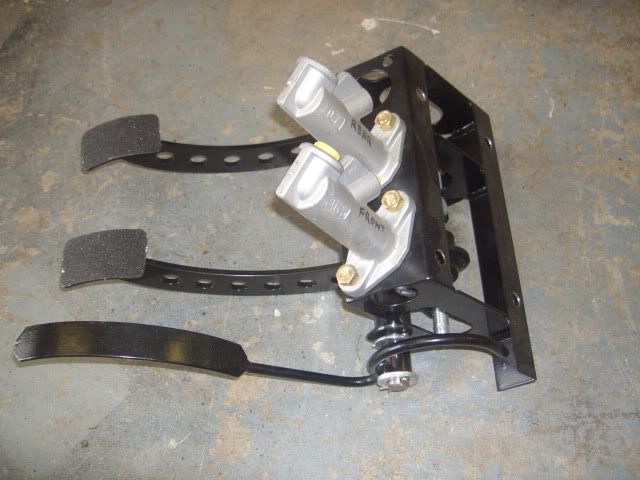

Because the inlet manifold sits so close to the bulkhead I decided to use an OBP pedal box with front to rear adjustable bias/This will be positioned under the parcel shelf and I needed to fit the seats to try and get a nice driving position.I hope to have this fitted in the next week as I want to get the accelerator cable sorted and also get the clutch working.
