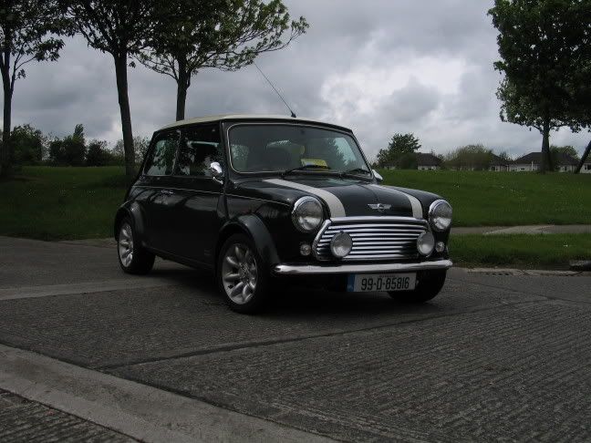

Just bought new spots for my mpi. It's a cooper, but specifically a Mini John Cooper LE. Anyway, they have 2 spots as standard. With regards putting on the new spots, from what I can tell I would need to cut the cable and wire it to the new one. Is it as simple as cutting the existing cable, and then connecting the new wire from the spot to that (how would one do this - i.e. should I use something to crimp them together?). Or should someone like me get a professional to do it?

@Buddy - on the LE MPI there is only 2 spots, for high beams:
So basically all I'm looking to do is remove those two and put on these:
That's it, just a straight swap. The wires running into the spot lamps are thick black insulated but seem to be 'hardwired' into the lamp (i.e. it looks to me I'll have to cut the cable). On the spots I bought there is just a small single wire running out of them.
So: I thought that I would have to cut the existing cable at a point close to the spot, somehow connect that cable to the new one from the new spot, and that's it? I don't know if that's safe to do and don't want to cut the cable and then be told I've fupped up! Likewise, I'm not sure how to crimp the cables to make sure there's no connection issues etc. (as a side point @keith - when/if I cut the spot lamp wire would I find there's 2 wires within - one for supply and earth? If so and there's only one wire coming out of the new spot..... how do I know what's to be connected? If you know what I mean!).
