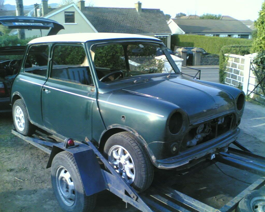

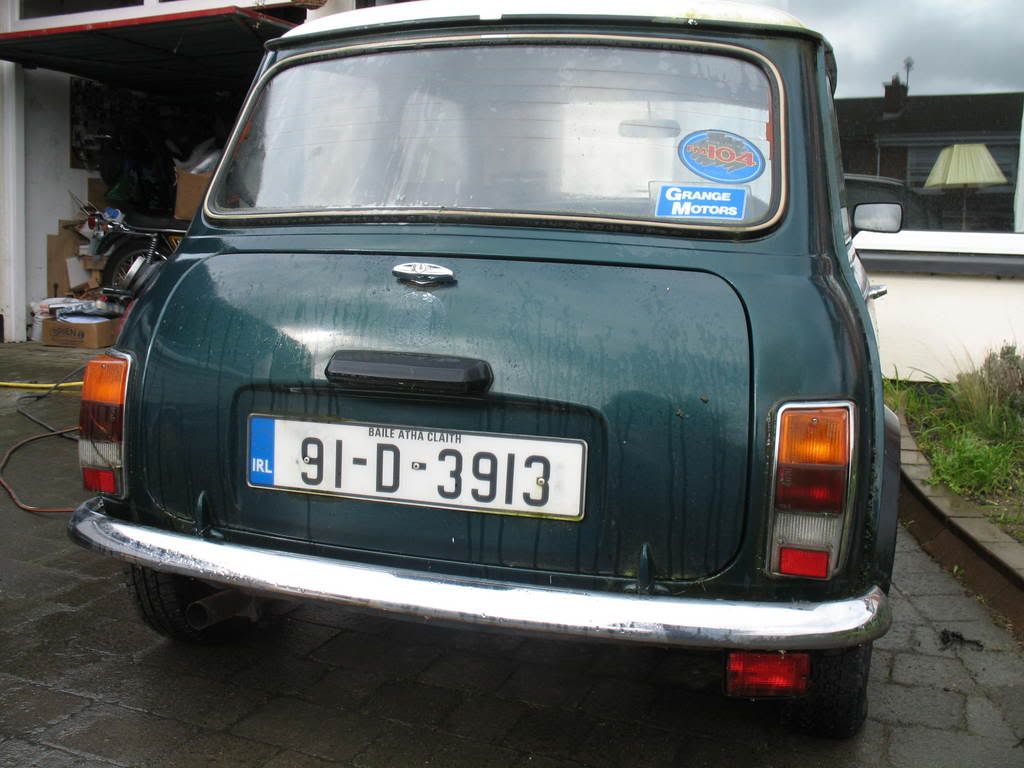

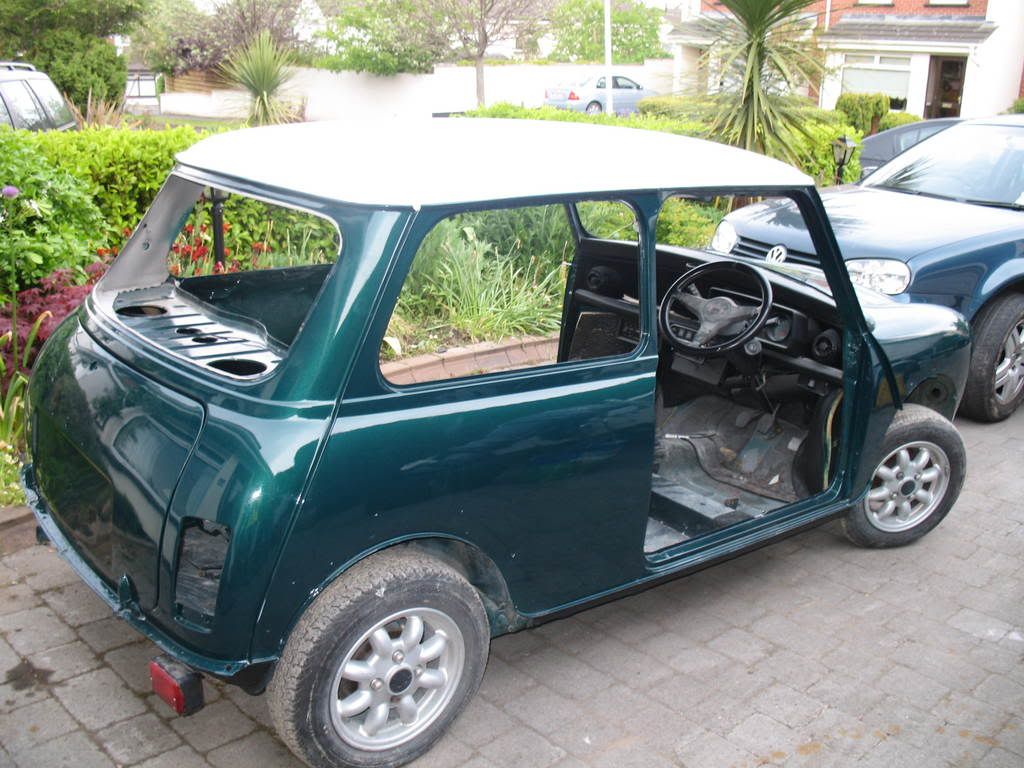

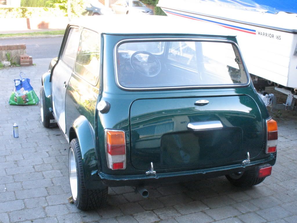

Thought i better show a few pics of my mini.

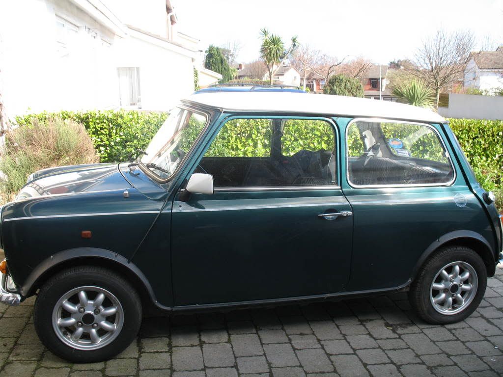

Original '91 carb'd cooper when i got it, this it before it went for re-spray and tidy up.
Stripped out ready for respray
When i got it back

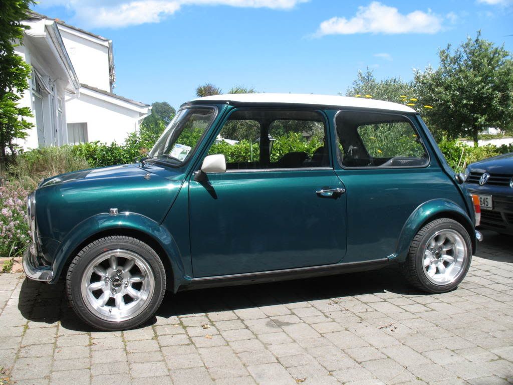

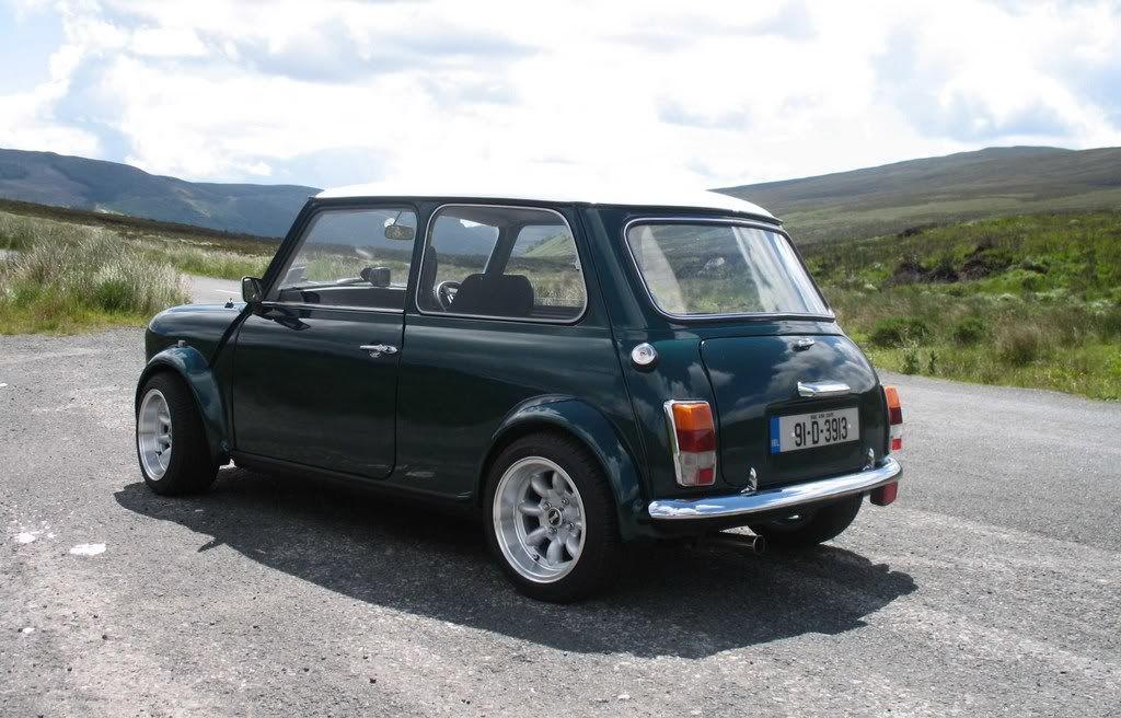

Went for the 13x7 sportspack look, which i now kinda regret, probably change to 10's in the near future.
Recently changed to Anthracite 13x7's, similar to these

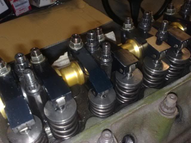

Engine:
Very standard 1275 with stage one kit fitted but i have started collecting bits for my 1430 build
Fully prepared blocked bored to 73.5mm
Cooper ‘S’ rods and Omega pistons
MED fully worked 84.3mm stroked crank
MED Rally spec cylinder head with 37mm inlets and 30mm Exhausts valves
Double valve springs
Swiftune high lift roller tip rockers
Piper HS270 cam
Duplex timing kit
Aldon electronic ignition
Standard gears
Four pin dif
Only recently started building this engine up, hopefully have it all up and running for the MTM.

The respray looks really well. How much did it set you back do you mind me asking? And where? Thinking of getting it done myself

just curious how come ya regret the 13x7 look???
Re: 1430 Cooper
mustard wrote:just curious how come ya regret the 13x7 look???
Think its more the ride handling Paul

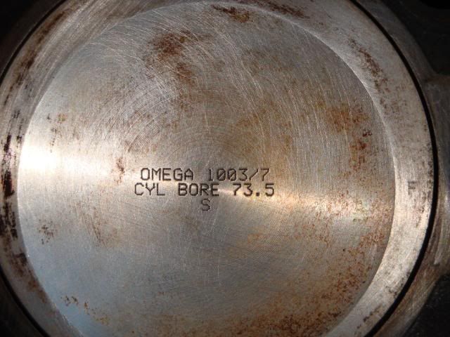

Bored to 74mm and you have 73.5mm pistons?Not goina be much compression in that engine!
Regret cutting nearly half the (then) perfectly good front wings away so i didnt get tyre rub!!
I know its a mini and all, plus i need new front cones but the 13x7 give a seriously uncomfortable ride!!

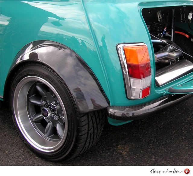

Still like the look of them though, me's thinking about (when the engine is done) of switching to
carbon fibre look miglia arches, love the look of these with the cut lip...

BERT wrote:Bored to 74mm and you have 73.5mm pistons?Not goina be much compression in that engine!
Sssssshhhh Image

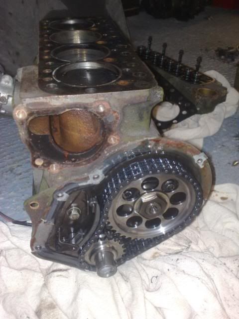

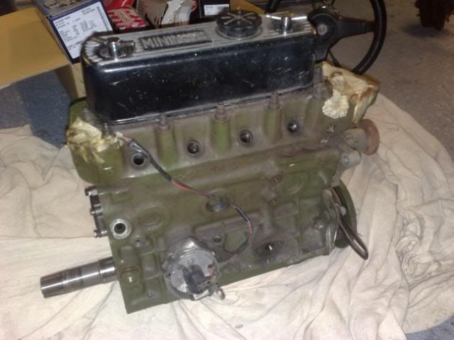

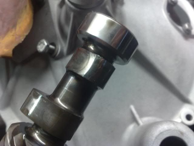

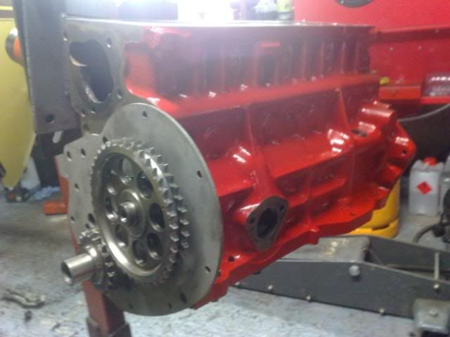

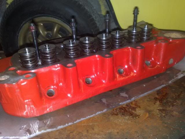

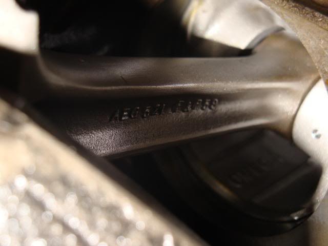

Got some pictures uploaded,
This is the engine when I got it, it had been rallied for a short while and then sat up.
Started stripping it down the other week
Found one of the cam lobes completely worn down, didn’t mind as I was replacing it anyway.
Everything else looked ok,

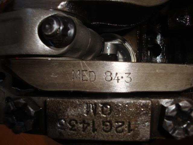

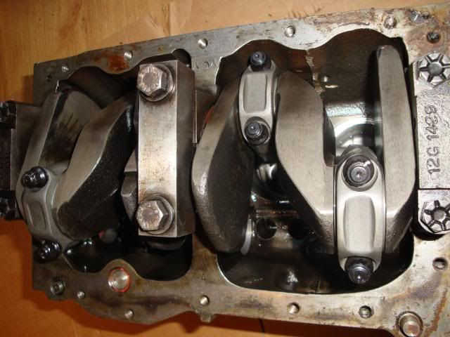

Cooper S rods
MED crank and centre main strap

Re: 1430 Cooper

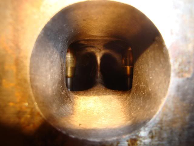

nice lookin engine Sid, cars looking great too, some nice acceleration as it is so this new one will be a right stormer!
its got some nice porting work done on the head too!

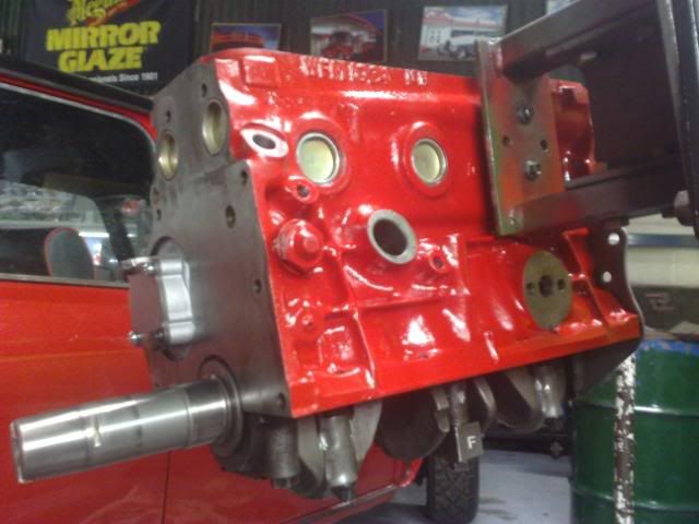

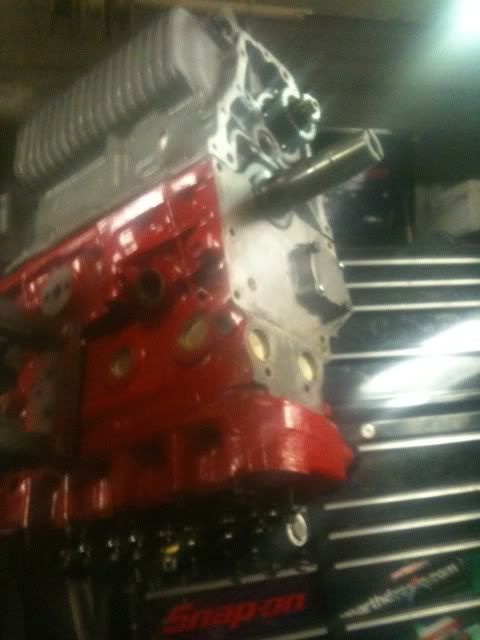

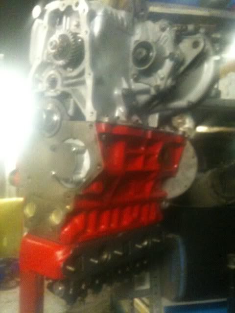

Engine painted up and new cam fitted ready to get timing sorted!
Re: 1430 Cooper
Oh yes! Engine looks class Sid.
Re: 1430 Cooper
sweeeet!!!!!! :mrgreen:

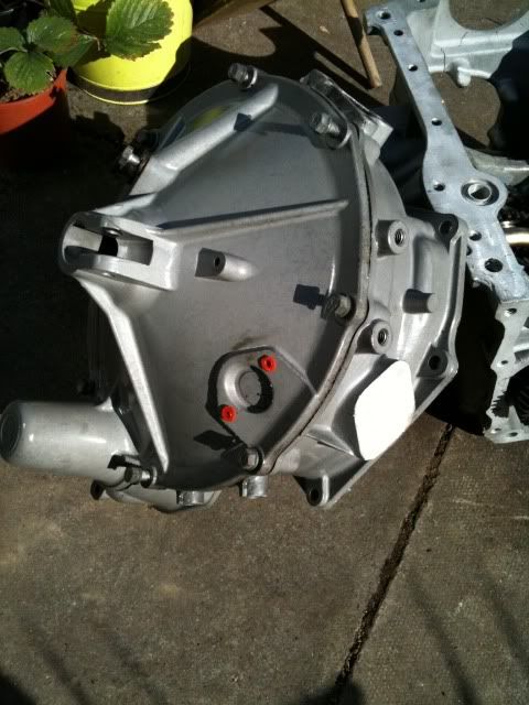

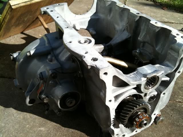

Small bit of progress lately, got the gearbox back off Llyod after getting reconditioned,
All casings where sandblasted and then laquered. Gearbox mounting holes drilled out
to accommadate 5/16 bolts
Engine is now on the gearbox, but still waiting on getting my rocker post spacers.
Was meant to be getting them through Llyod off MED but they were taking ridiculously long
Ended up getting them off Paul Hickey so should be able to get the valve timing sorted soon.
Back to work tonight :( but have a shift off the following weekend so hope to get some
serious progress then, will keep ya's posted!!
