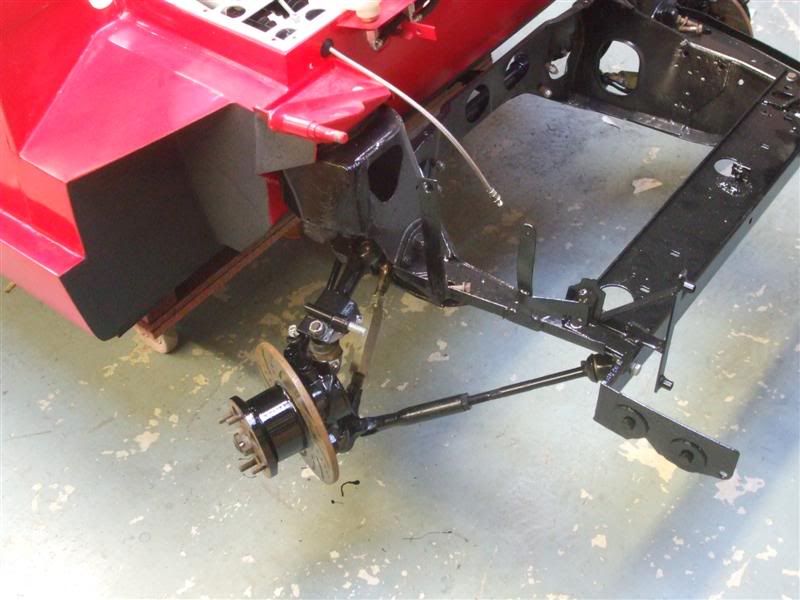

Modifications to suspension included on car adjustable bottom arms and caster bars, new pickup points for the coilovers, complete refurbishment of the brakes
Front upright.JPG (52.21 KiB) Viewed 12326 times

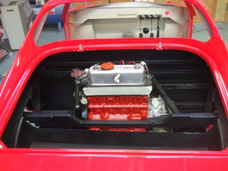

Engine in and working, 45 webber on 6.5" ali manifold, custom exhaust and manifold
Engine 1 (Small).JPG (42.81 KiB) Viewed 12267 times

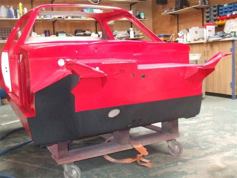

Rear view, spoiler required, some modification to boot lid and scoop
PICT0094 (Small).JPG (71.77 KiB) Viewed 12263 times

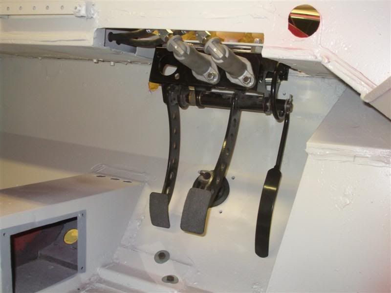

I wasn't happy with the brake setup so I installed a pedal box,

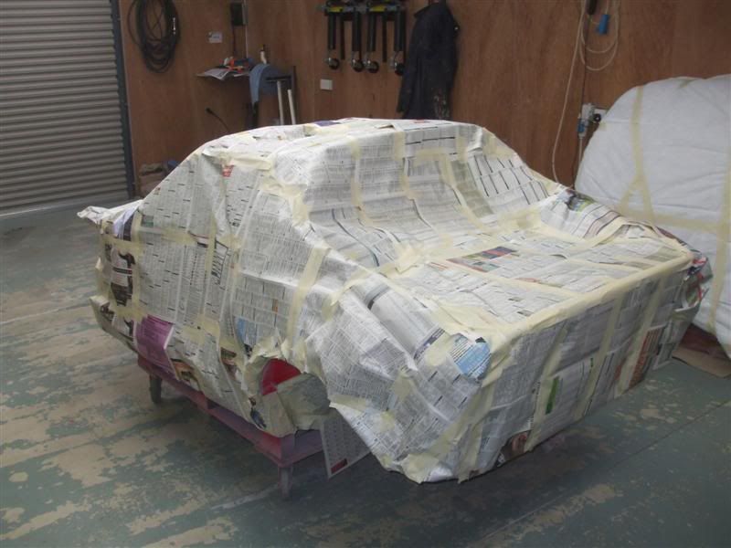

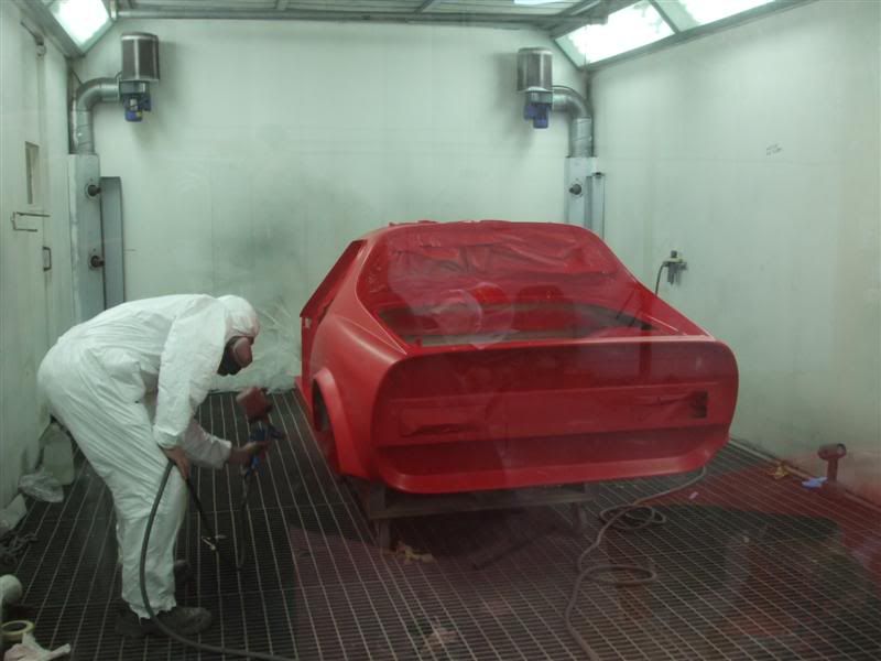

I then packed all the bits onto the truck and took it off to be painted,
Parts in primer,
Spraying the car,
Parts painted,

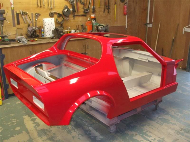

Ok so it now safely back in the garage,

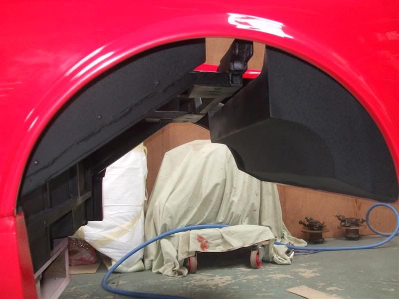

Now I needed to apply the stone gaurd to the wheel arches and spray the engine bay (to save money)
And the finished result,

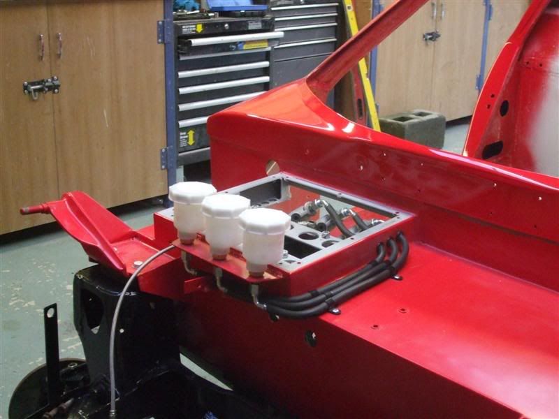

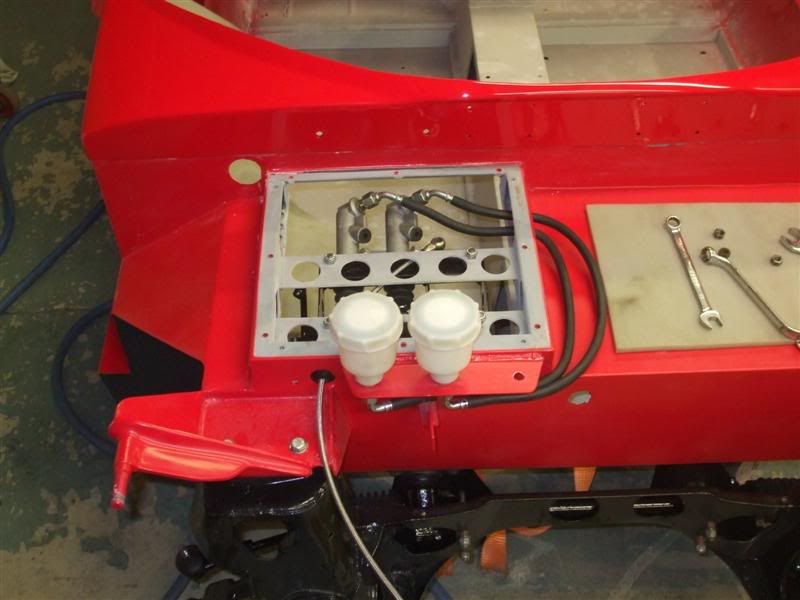

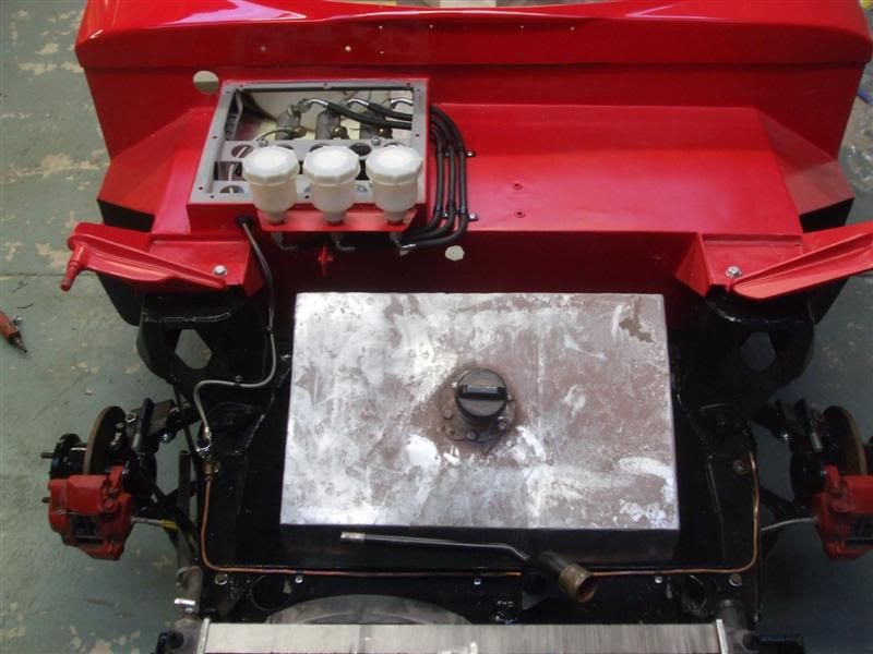

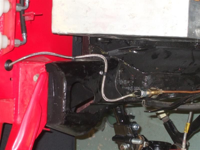

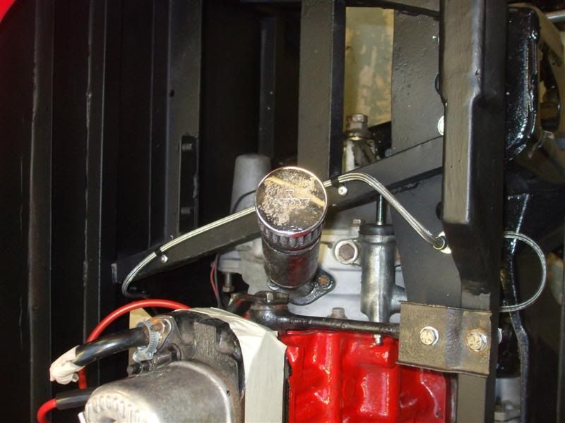

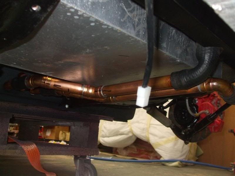

Right a few more progress photos,
Front brakes plumbed,
Clutch plumbed,
Started on the cooling pipes,
