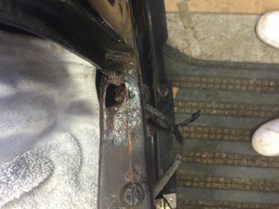

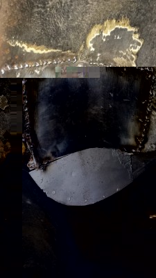

Well today unearthed a bit of rust. Ah I suppose it was to be expected out of a mini. I grinded back most of the scuttle due to the bubbling and found that it was pretty solid. I stripped out the rest of the interior and that is when the fun began. I took off the black and red part of the part and found a pretty big hole on the passengers side heater vent. The drivers side heater vent isn't too bad but surface rust from what I can see. So I decided to dig further, I took out the front windscreen and the passenger side corner scuttle isn't in great condition. The top rail for holding the dash is rotten as well. At least I have her in dry storage now. Here are a few photos of todays work and the rust I found today.
hole in the bonnet and the cross supports are falling off. Minifix has sorted me with one though

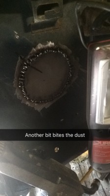

Just a small hole on top of the front panel

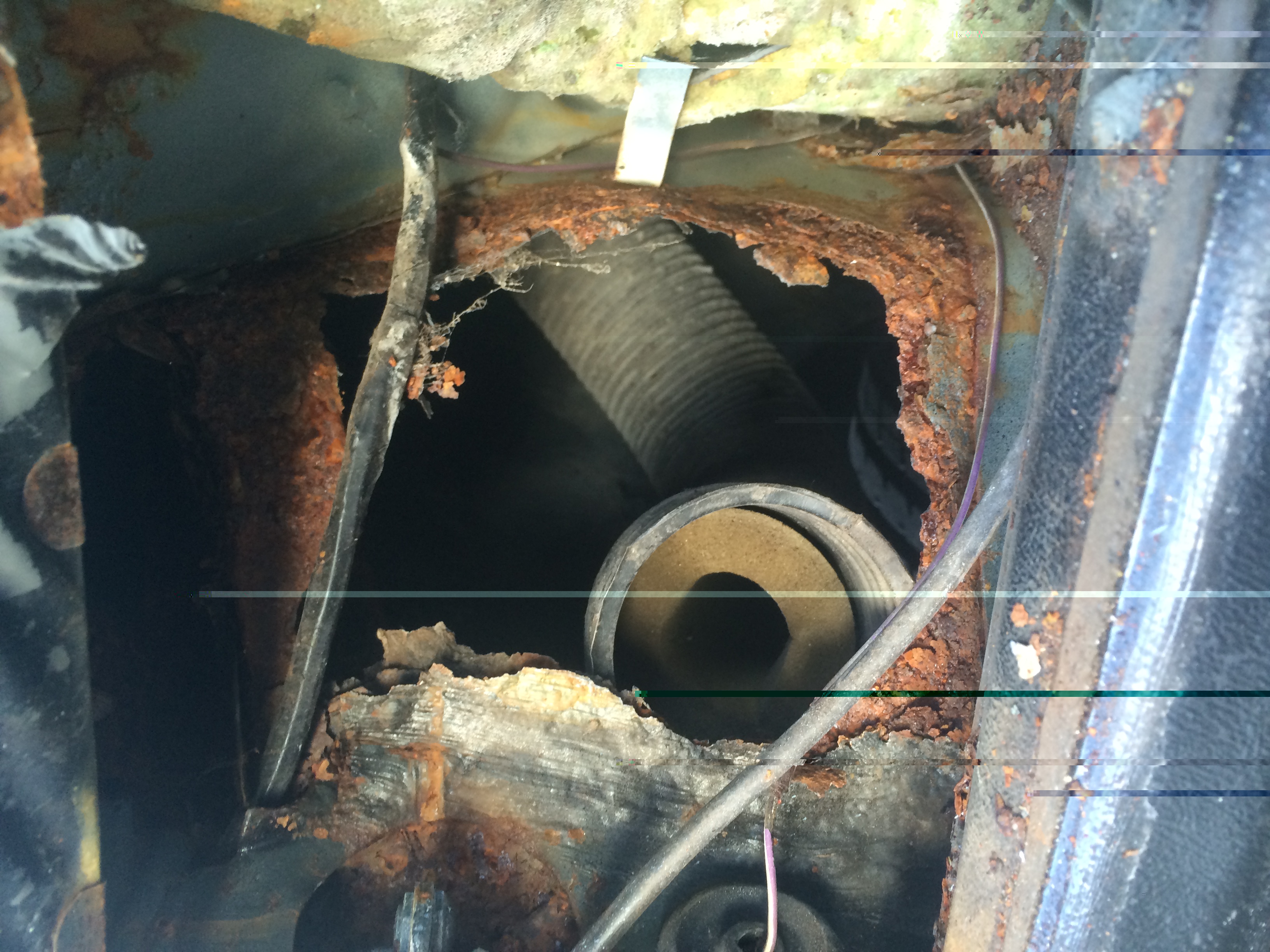

Some of the rust I found
Dad has the mini fever again. Could end up with another mini around the place lol

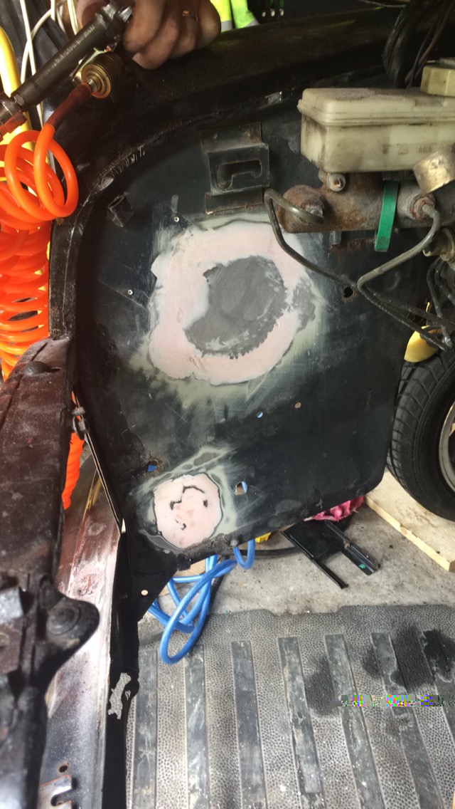

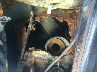

The rather large hole I found at the vent

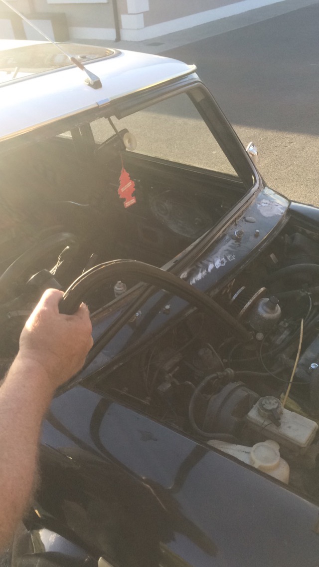

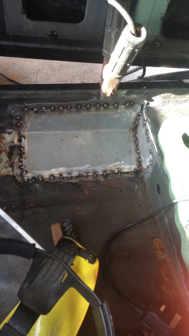

I decided to start some welding on the mini as it had to begin at some stage so why not start now. I started with what i'd call an inner cill some may say it the rear floor pan I'm not going to get political about it. Anywhom I cut out the patch and the outer cill had surface rust was solid so I put on rust preventative and a zinc prime before welding on my patch. Considering it's my first time I think it went ok? I'll let you guys judge and if you have any tips feel free to share them :D . anyway enough talking i'll let the pictures do the talking.
Re: Project Lexi
Rather than welding spots, you should try and weld along the joint, seam weld.
It looks like the car had oversills fitted before , the question is did they remove the old rusted sill or just put the the new sill over the old one?

woody wrote:Rather than welding spots, you should try and weld along the joint, seam weld.
Hi Woody,
Thanks for your reply and tips. In relation to the seam welds I haven't quite mastered that. Due to the simple fact that it burns through everytime. It is probably just my settings on the welder I need to change #newbie
About the sill. I'm unsure to be honest. Further inspection will be required. When you say "over sill" do you mean they put a sill over the outer sill or inner ?
Darragh,
Re: Project Lexi
You should practice some welding off the car first.
Over sills are wider than the standard sill and some people do a quick fix by welding over a rusty holed sill rather than remove the original one.

woody wrote:You should practice some welding off the car first.
http://www.minispares.com/product/Class ... o%20search
Ya I will definitely have to practice my seam welds off the car.
I have more to be doing along the sills. Think il replace the outer sills for piece of mind and see what lurks underneath

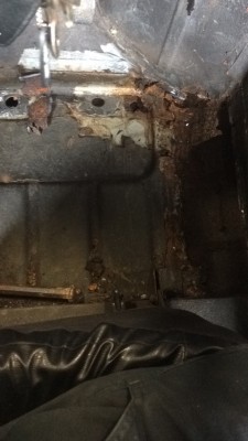

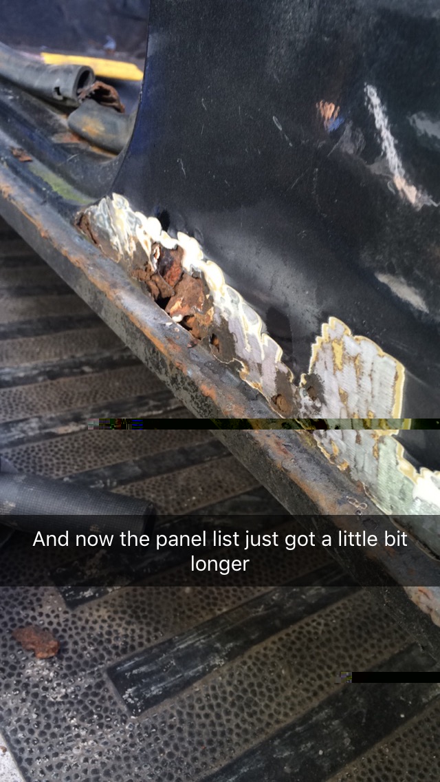

Well so far today I've been digging out rust and undoing mistakes from a previous owner/ whoever patched it last. I've made a small list of panels I need.
-scuttle
-inner scuttle passengers side
-upper dash rail
-front floor pan on drivers side
- 2 outer sills
- possibly 2 wings if I'm replacing the whole scuttle
Anyone got any tips on matching panels when welding so they match well?

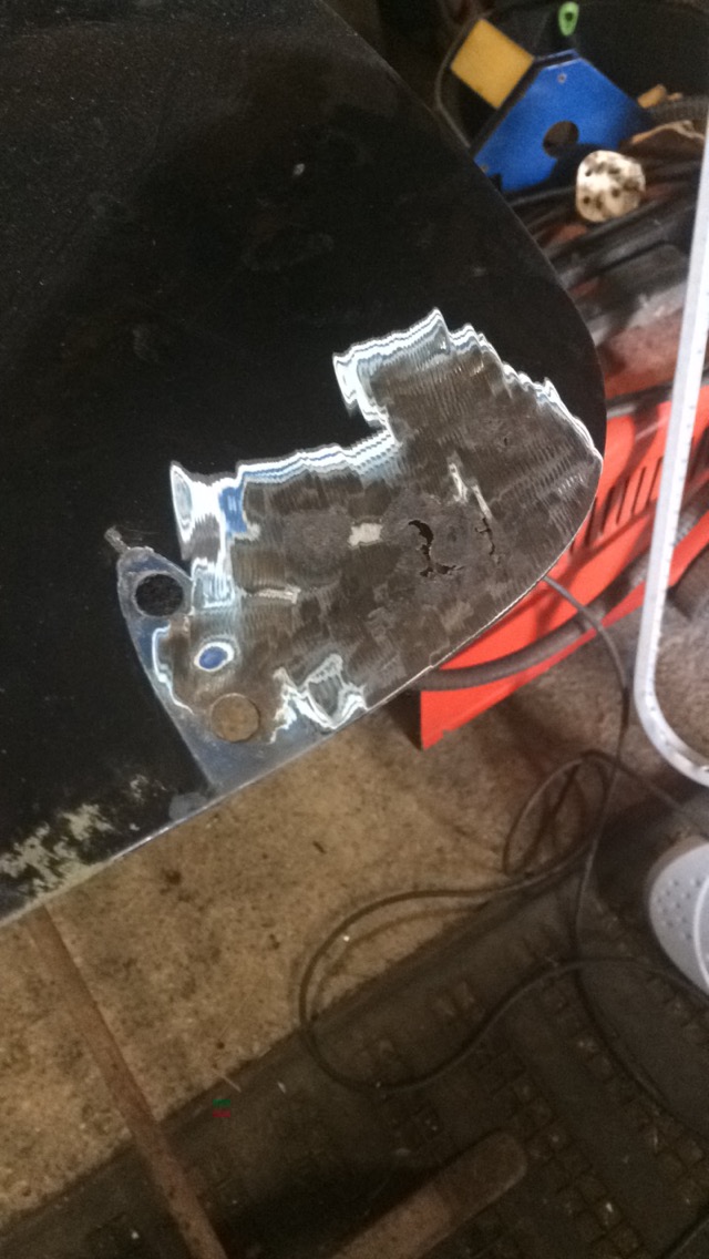

I finished exams today so full steam ahead with the mini. I took off the bootlid today and grinded back the bubbling on the skin. As seen below they're the holes in it. Don't know whether to re-skin it or patch it. It isn't bad like.
Opinions??

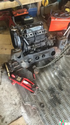

This is my last update til after the IMM. Dad and I dropped the front subframe and engine. We aren't looking forward to putting them back in but that is a long way off yet.
Anyway see ye at the IMM :D

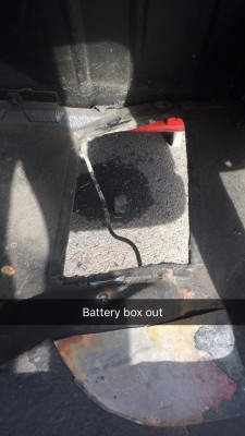

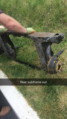

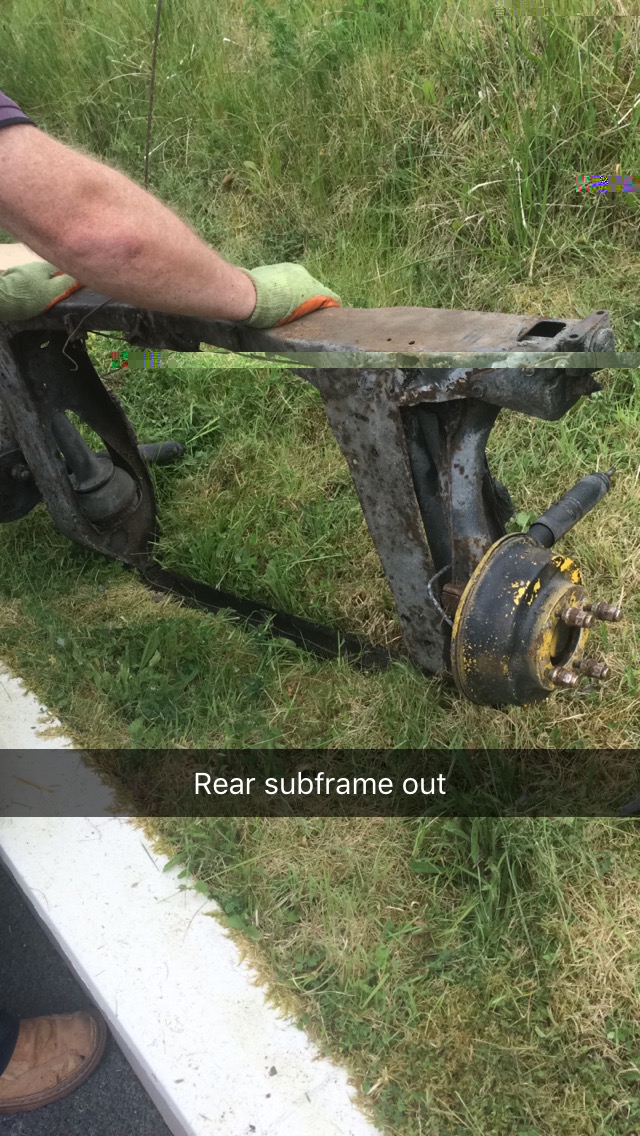

We dropped the back subframe today and repairs began.

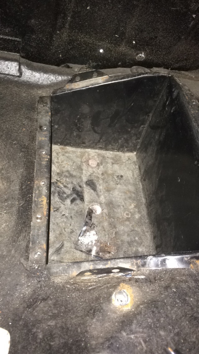

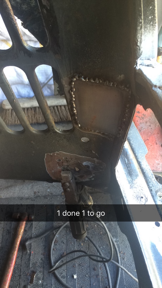

I welded in a new battery box and put a new plate on the back of the rear valance. As you can see I need to patch up the arch as well.
Ran out of sheet metal so had to finish up for the evening. I cant wait to get this welding done it's a pure pain in the bottom :(

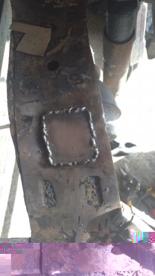

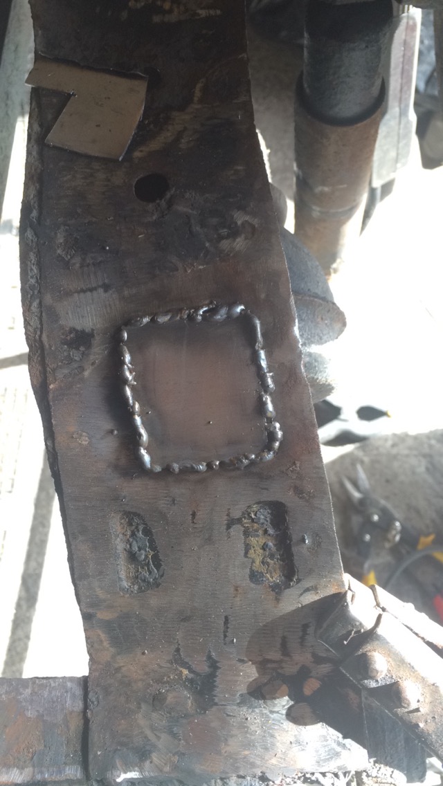

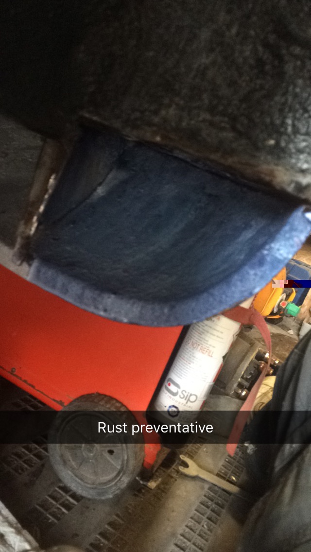

I did a couple repairs on the rear subframe but I only took one picture sorry. I'll take other Monday.
I also welded up a couple holes in the engine bay, I welded up a vent I have no use for now as well. Once again I forgot the pictures but I've still a few.
