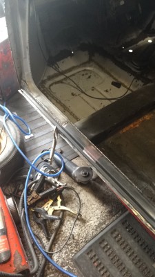

Not a lot done with the mini. I'm waiting on the door steps to arrive so I can crack on with the welding. They're arriving on Wednesday and it'll be full steam ahead then. By the end of the week I'm hoping to have the door steps in, the other quarter repair and the outer sill. Bit optimistic but hopefully. Then the dreaded front has to go on, I have so many questions about putting on the front.
Here's a couple pics of a few small bits I did

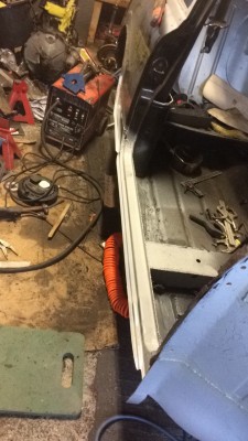

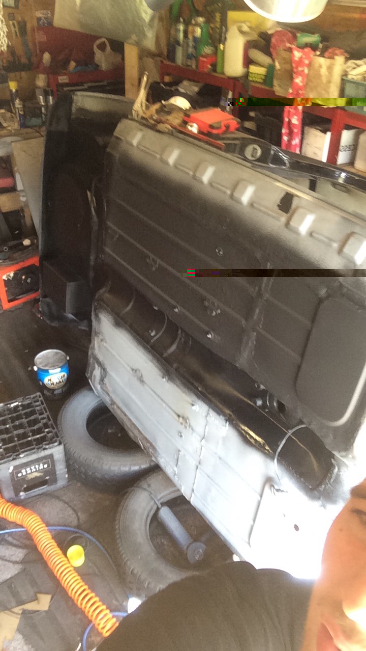

Been a busy day in the shed
Got a delivery from minisport today. Nice way of spending over 500 pound. However they forgot to send a few bits that I ordered so I best get onto them, anyone ever have this happen to them ? :roll: I also ordered two sets of bump bushing for the front subframe by mistake so if anyone needs a set don't bother ordering them you can have my set.
Got the door steps in the delivery so them, the quarter repair and sill were top of my priorities for this week.
Ended up getting in both door steps and the quarter repair so that just leaves the outer sill to go on.....apart front the whole front that is :roll:
Any whom here is a few pictures of the progress

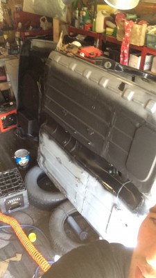

Got the underneath sealed

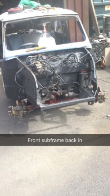

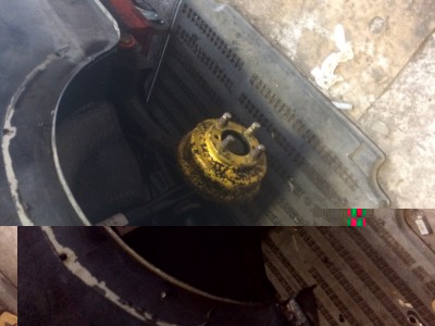

Well it has been awhile since I updated.
As you can see I've replaced the scuttle and inner scuttles
I also got a new door and new rear subframe
I installed the rear and front subframe today. Happy how the rear turned out. Mounts I had to replace and done a homemade Job on fix perfectly. I also changed the bumpstops after I took this pic.
Hole car is now poly-bushed. Gonna stick the engine back in and get it rolling again by the end of next week.
I also have a new arrival I'm collecting on Saturday. Stay tuned to see what it is. Big plans for it ly ahead
Here is a few pics of my work.
Darragh

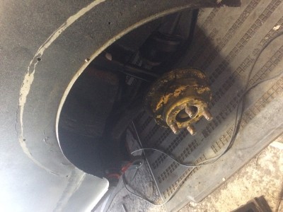

Today I managed to get the radius arms in with new hi-lows, cones and shocks. I also swapped the bushes on the front lower arms. As you can see some things need a lick of paint to make them look nice but everything works which is the main thing.
Next job is to get the doors on, steering working, wheels on and engine in. Then she's off to body work for the front and paint.

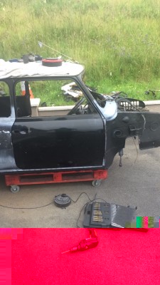

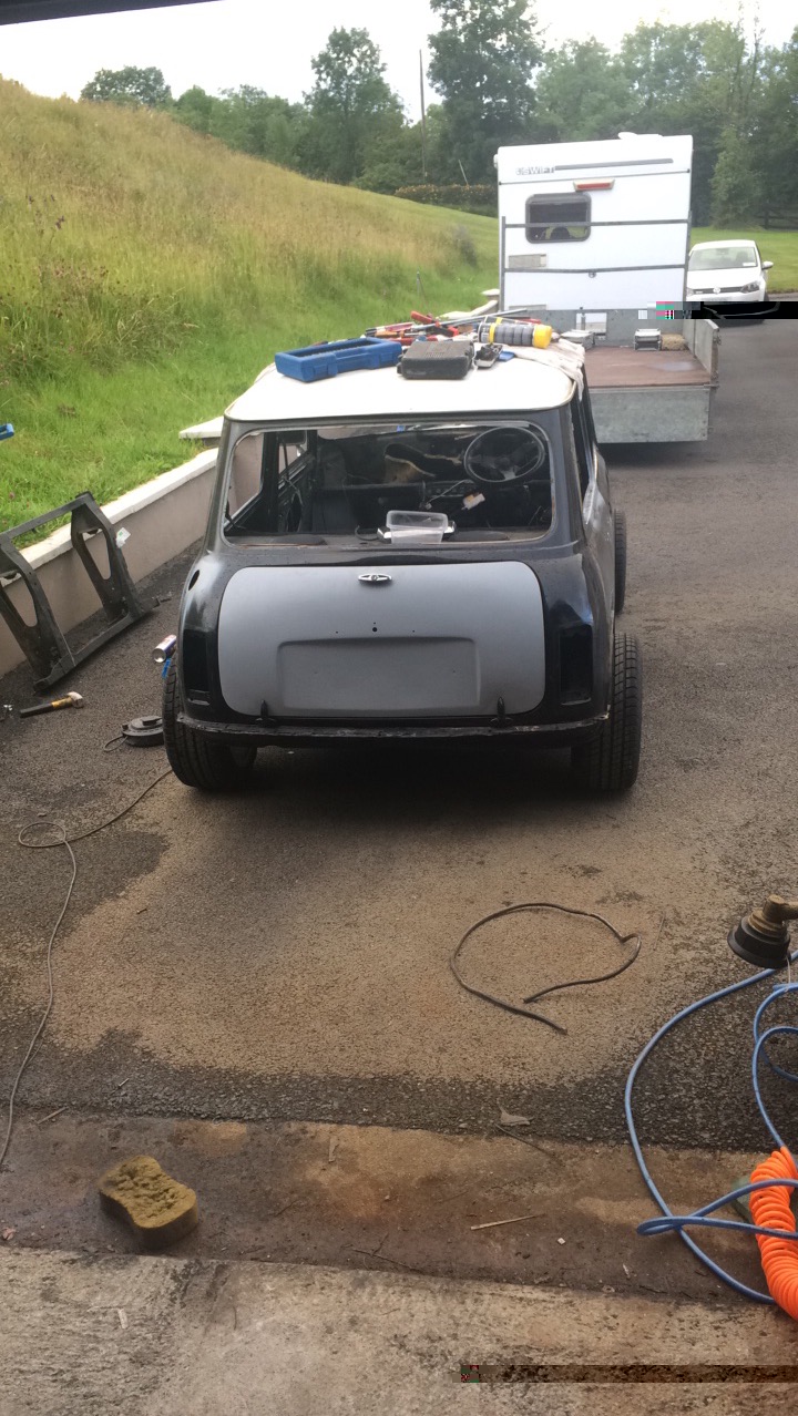

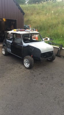

Got it on wheels today, got the doors and bootlid on as well.
Collected the trailer for what I'm collecting tomorrow I'll put up a picture tomorrow when I get it

Well I've been out in the shed since about 9 this morning to get this engine in place. Dad was coming in the door from last nights work but I managed to drag him out for awhile. She isn't looking to neat at the moment but nothing a bit of elbow grease and shiny bits won't fix. The paint dribbled a bit onto the gear box but I'll clean that up.
Darragh
