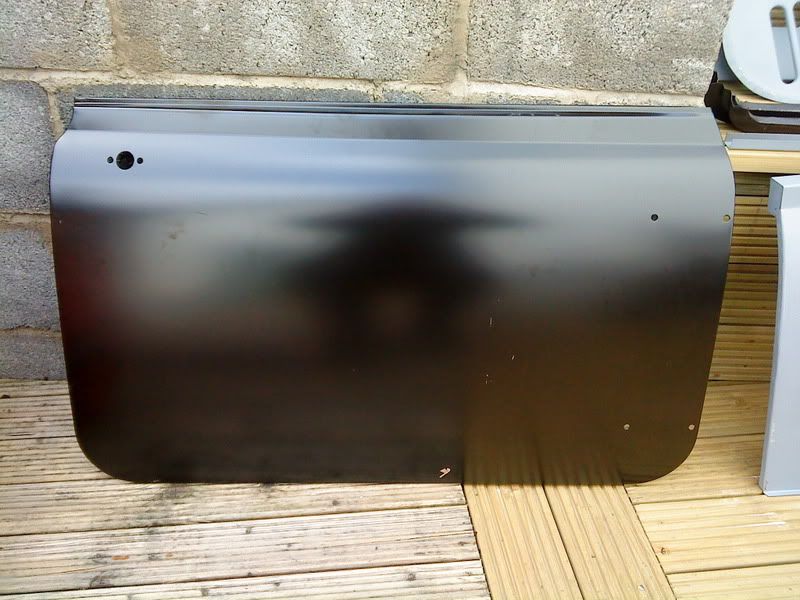

I have been looking at Somerfords prices for door skins and the have 3 options
1. Genuine skin @ £54
2. Non-Gen skin @ £32
3. Non-Gen Aluminum skin @ £66
Apart from weight what other advantage is the aluminum one ???
Re: 1972 Pickup project
It won't rust ?????
You'll probably have to bond it to the frame
You will have to use etch primer to prime it.
Aren't they just for racing purposes though ?
If the aluminium ones are aimed at racing I would think they are thiner and easier to dent. Need advice from the racing gang.

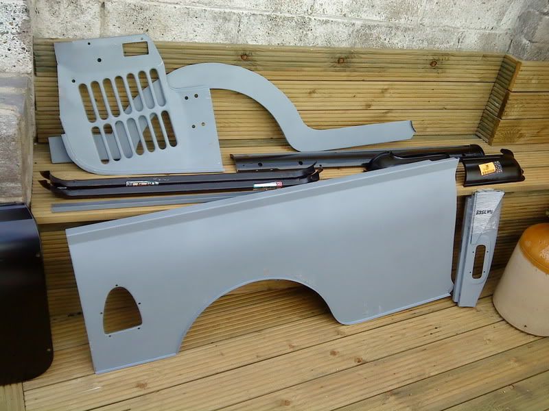

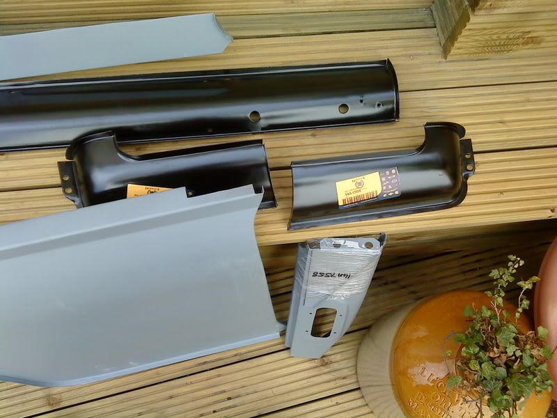

Well I am getting the finger out after a long time.
Today, arrived 2 box's of panels from Somerford with loads of goodies and I am hoping my new mig will be here early next week to get started.
