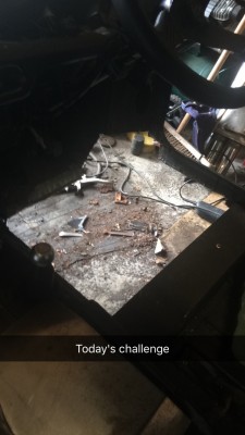

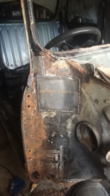

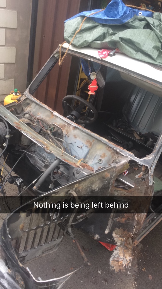

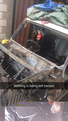

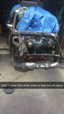

Todays topic is rust,
Cut off most of the front. The wings, Scuttle, inner scuttles and cut away on of the arches. I also took off the doors for more access. Hoping to have both arches repaired by the end of next week.
I have another question for one of the mini wizards on here. Dad started to strip the rear subframe today, when he took out the trumpet and cone he could get them to seperate. I have hi-lo suspension bought but I wanted to reuse the cones if possible. Basically my question is how do I separate the trumpet from the cone ? I didn't think they were attached
Below is some pictures of todays progress

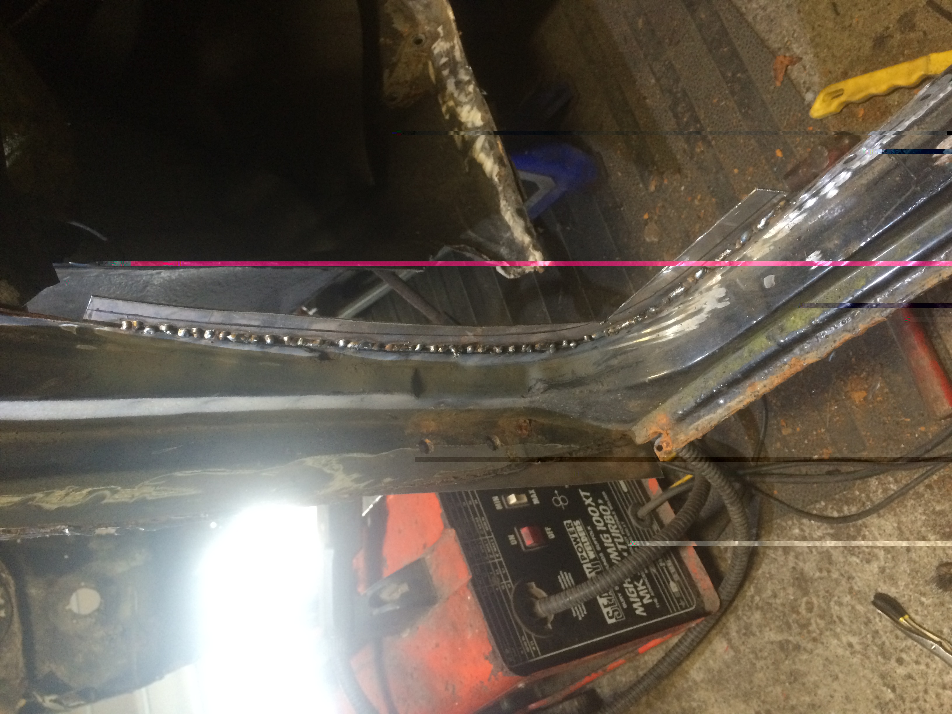

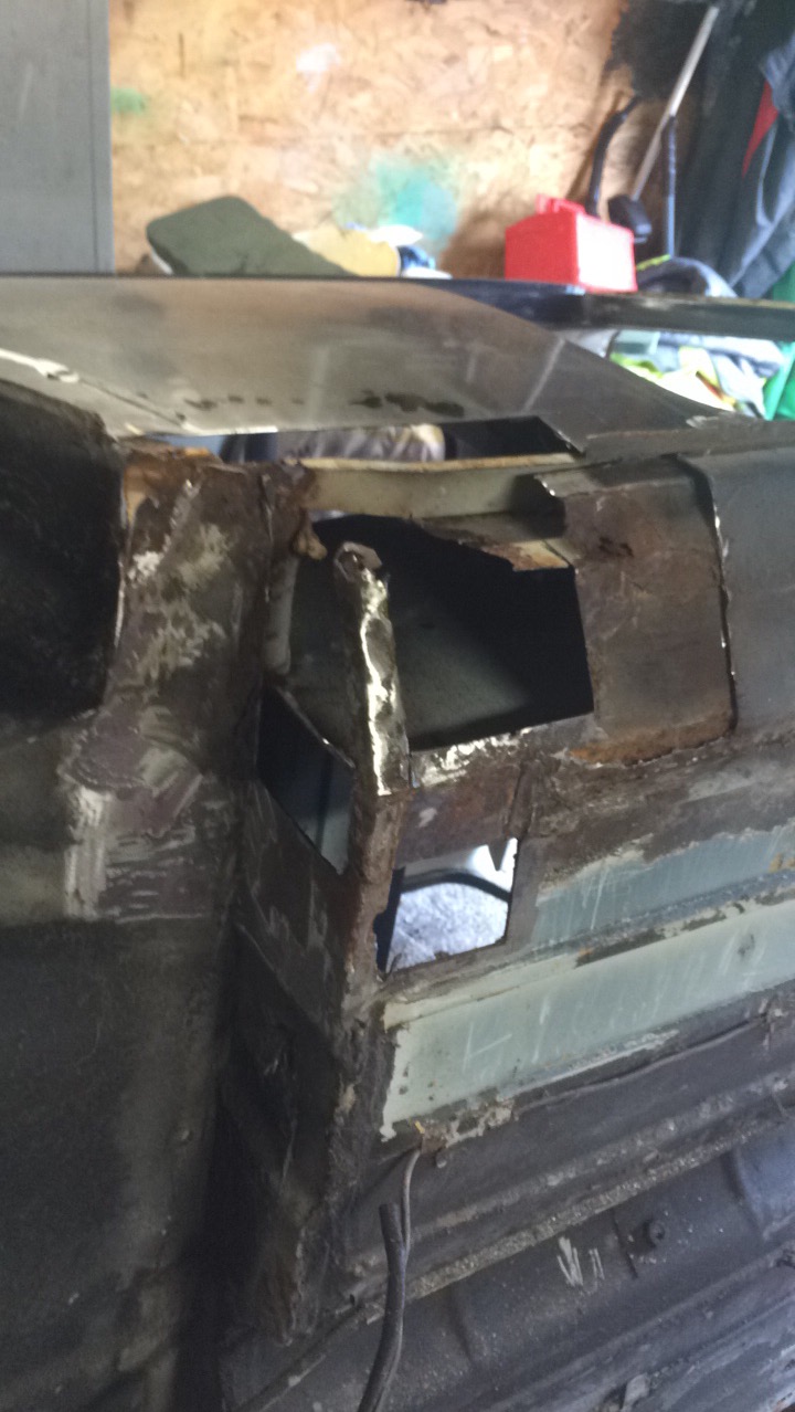

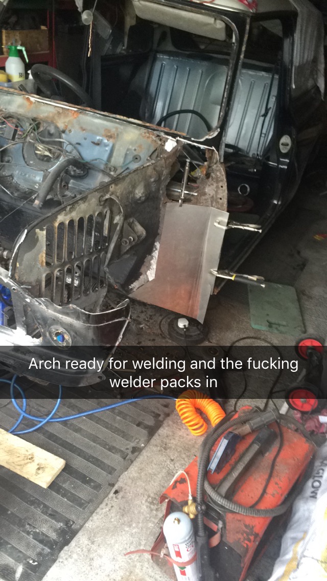

Well its been an eventful day.....
Started work at about 10:30 on the mini. Everything going well got the pillar welded up and got the front floor well in. They just need tidying up. Also got 2 beautiful boxes from minisport today full of panels. So was looking forward to a good day of cutting, grinding and welding. BUT then after I finished the floor the bloody welder decided to pack in.
I went in for a bit of lunch and tried to think up of a game plan. Through my planning I figured out I'll be getting nowhere without the welder so I decided to just to make the repair that was needed for the arch. Then I tried to fix the welder and it came back to life after a bit of persuasion. I was now ready to weld in the arch repair. BUT of course things couldn't go too well...... I flung my arm when taking off my hoodie somehow and made a massive gouge in my index finger. I ran inside and left a huge trail of blood from the shed to the kitchen sink. At least I would lose my way back to the shed when I cleaned up my cut.........
Also got my college exam results today. Passed everything. Hoping Dad looks at this post later on and thinks "I must buy that son of mine a good welder since he is broke"..... just a hint Dad if you're looking at this. Knowing him he'll let on he didn't read this.
Anywhom here is a few pictures of today's work
Darragh
Darragh
- Posts: 2837
Re: Project Lexi
Well done with the exams. If your doing a lot of welding the thermal cutout in the welder may be operating, check that the fan is running properly.
When welding seams it may be better to drill holes along one panel and weld through them to make "spot welds" or you can get spot weld attachments for mig welders but I never used them so if anybody has an opinion on them they may let you know.

Thanks for the reply woody. Tbh I've been having a lot of problems with the welder a recently. The earth is a bit dodgy on it I've fixed it but the wire is quite short now. Could do with extending. I've seen those spot weld attachments but you can't add them onto my welder. They're only interchangeable with the more modern welder. The fan is actually running 100%. But the co2 is leaking from the connection to the bottle. I have it temporarily fixed so I'm hoping get a new welder as this one has seen better days. Bit of saving is gonna be needed me thinks. My welding needs a bit of practice but I no the welds won't break. I'll do that spot welding in the other floor well and see how I get on. I've saw a few of the guys on here doing it. Looks handy for holding a panel while you Seam weld the edges and distributes the heat.woody wrote:Well done with the exams. If your doing a lot of welding the thermal cutout in the welder may be operating, check that the fan is running properly.

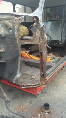

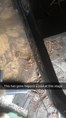

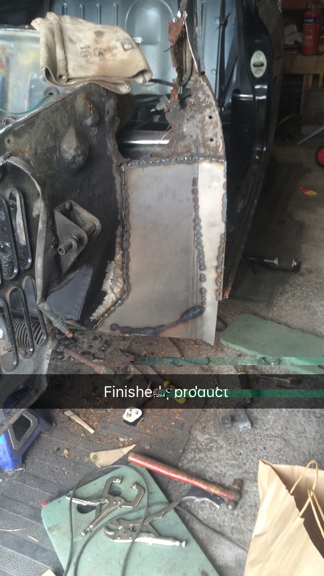

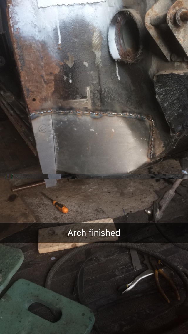

Another day, Another bit of rust
So I got that arch welded in and I began to patch the other arch. hoping to have both arches and both floor wells done by the end of this week. I didn't try the plug welds yet. Going to give them a go when I'm putting in the floor well.

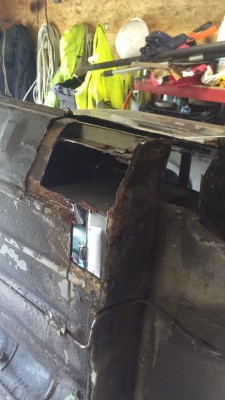

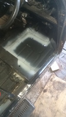

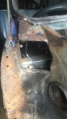

Went at the drivers side floor well and arch. Ended up finding lots more rust. I think I'm going to have to replace the door step now as well. Just as I cut away all the rust and started welding I ran out of gas. Just my luck
. Anyway I decided with all the rust the it would be handier have it on it's side so that's what I did with some help from Dad.
Getting gas tomorrow so I'm hoping to have all that completed by tomorrow evening. But don't hold your breath I'm sure I'll have an excuse why I don't.
Darragh
Darragh

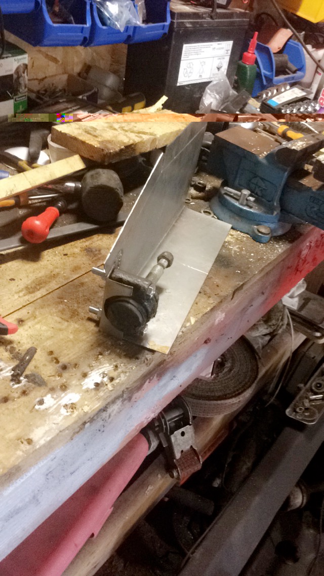

I made up the panels on both sides where the rear subframe and the floor meets. So hoping to install those Friday and Saturday.

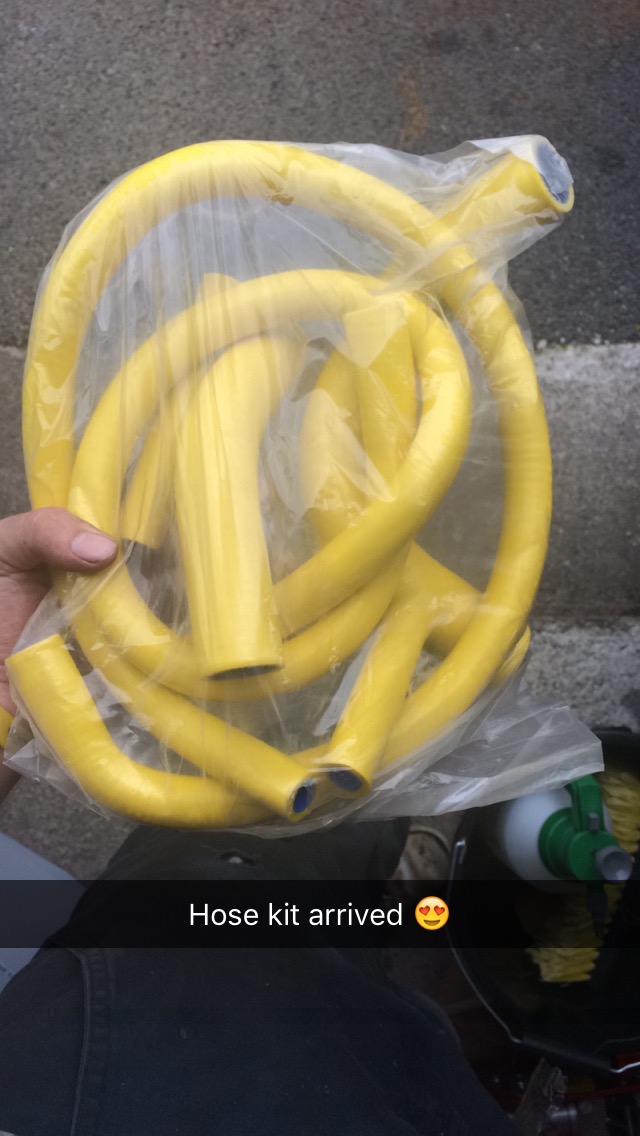

Also have been trying to hunt down a yellow hose kit for ages. I could only find red and blue but I finally got the yellow so I was happy as Larry today when they arrived
Darragh

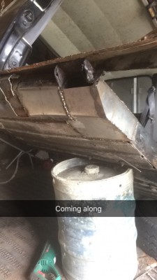

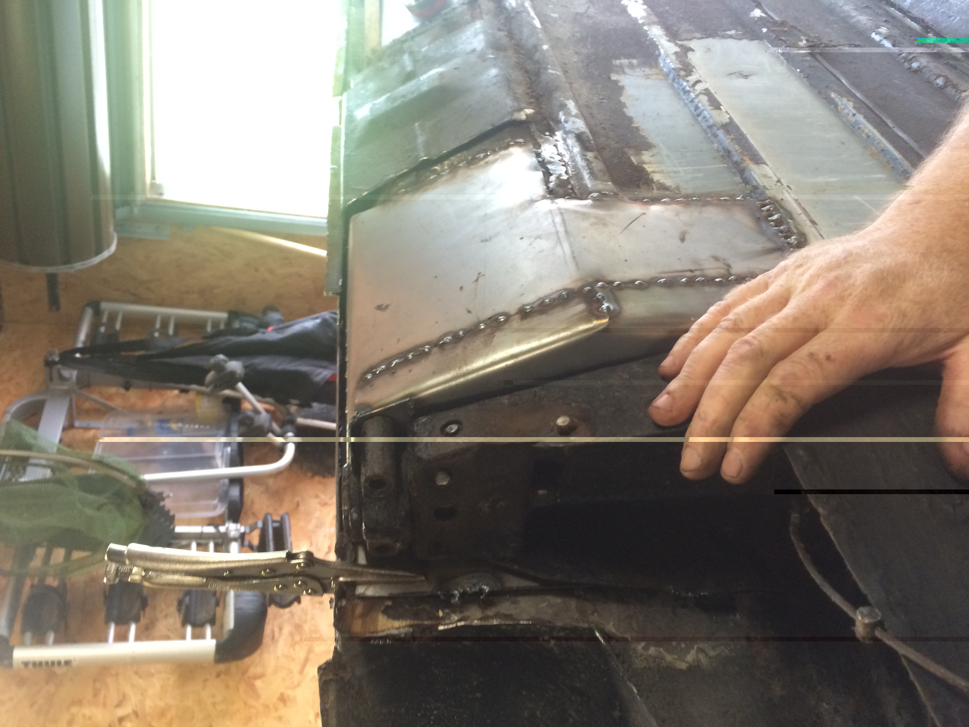

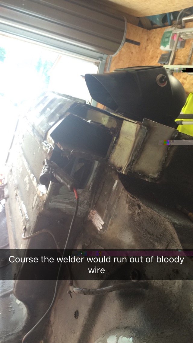

So Dad and I tackled the rear subframe mounts or whatever ya call them.
We flipped the mini on one side, cut out the rust, bolted in the rear subframe to line it up and welded in the panels I made (I welded on the nuts to the back of the panel and changed the bolt to a 13mm instead of 1/2 inch for convenience.
Got that done and we flipped the mini over to do the otherside and guess what
Ran out of welding wire....typical
Ah well always tomorrow
Darragh
Darragh

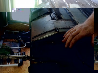

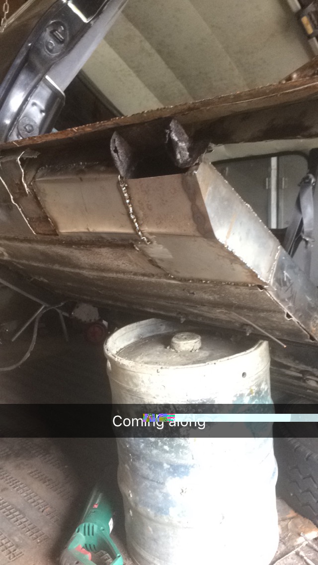

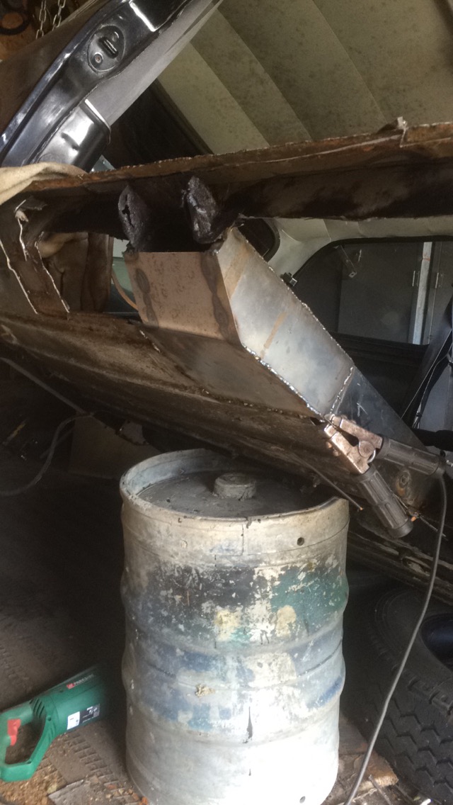

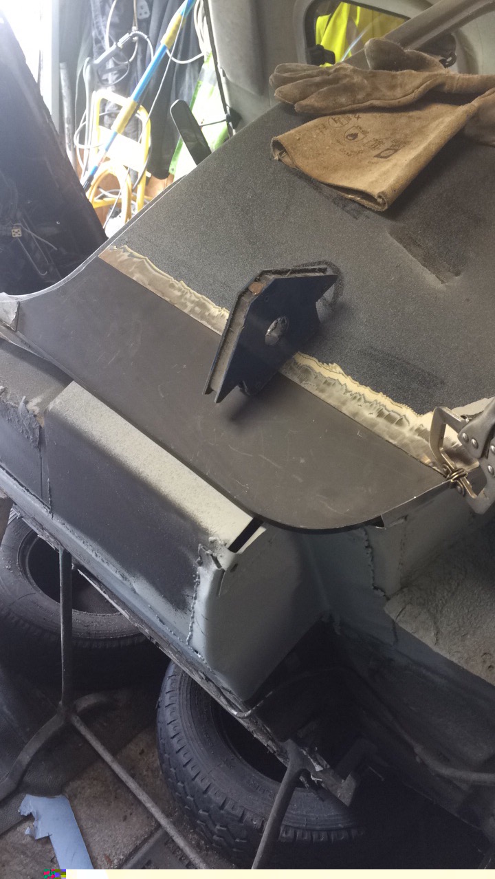

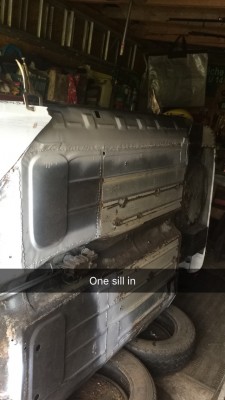

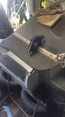

Got the passenger side sill and quarter repair done today. Couple pics of the work
