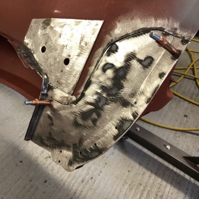

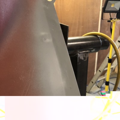

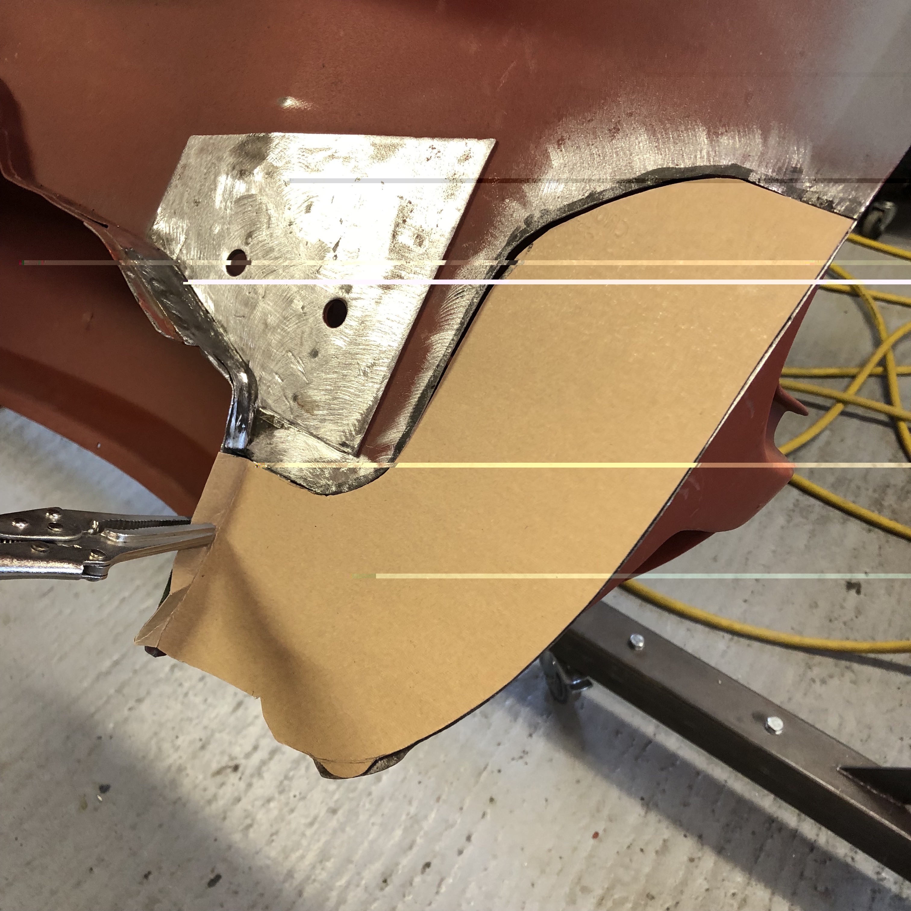

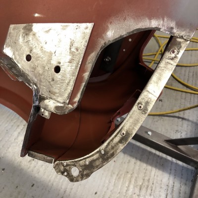

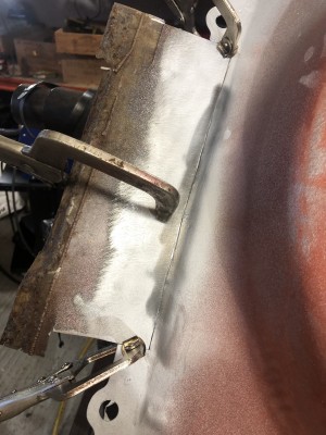

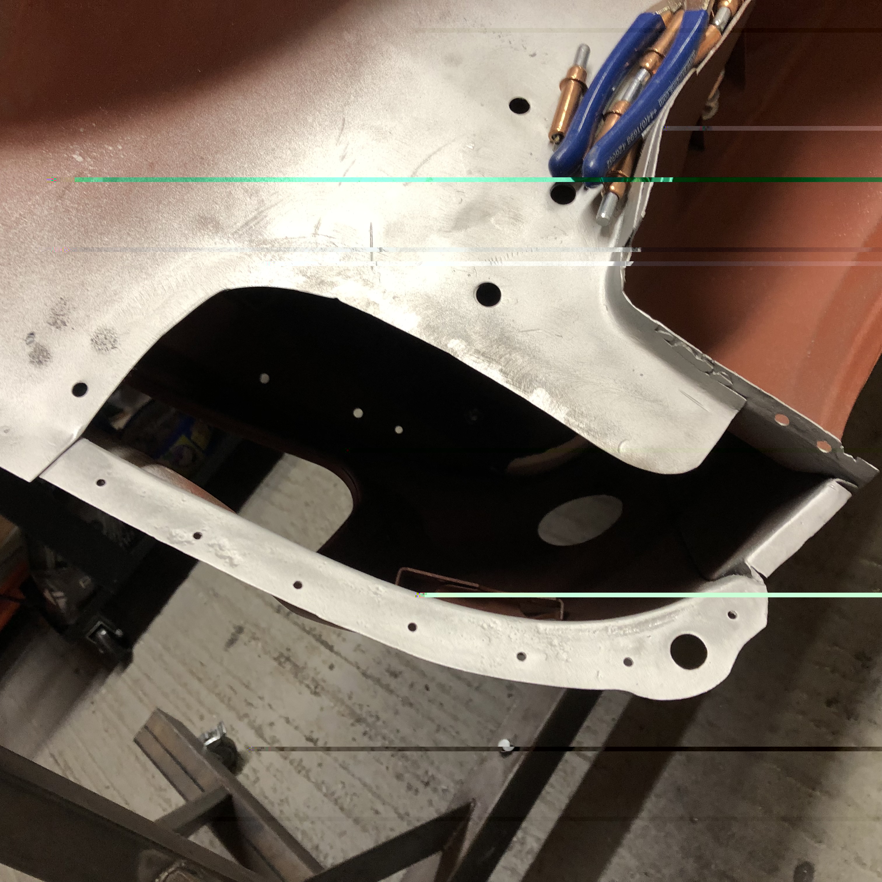

I cut out all the rotten floor in the driver's rear corner
Made up a carboard template of the patch panel
Cut a patch panel out using the old outer skin of the door
All Cleco'd up now with just the plug weld holes to create. Should weld it all up this weekend.
This is the finished strip in the background of the previous image

Would you recommend the Cleco clips or could you get away with plenty of vice grips?

colinf1 wrote: Wed Jul 07, 2021 10:34 am Would you recommend the Cleco clips or could you get away with plenty of vice grips?
Great for pinning panels where you can't get a clamp to the back of them. However, the best is that you can align two panels together, drill the 3.5mm Cleco holes and every time you take the panel off for tweaking, painting etc. you can ensure it goes back into the exact same place afterwards.
Mind you Lidl do a 3 x pack of small vice-grips for €7.99 that are great for holding panels together too.

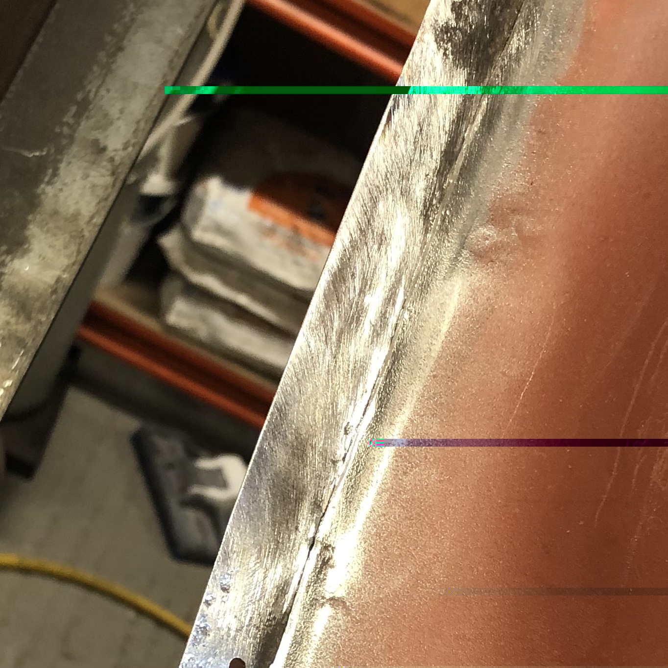

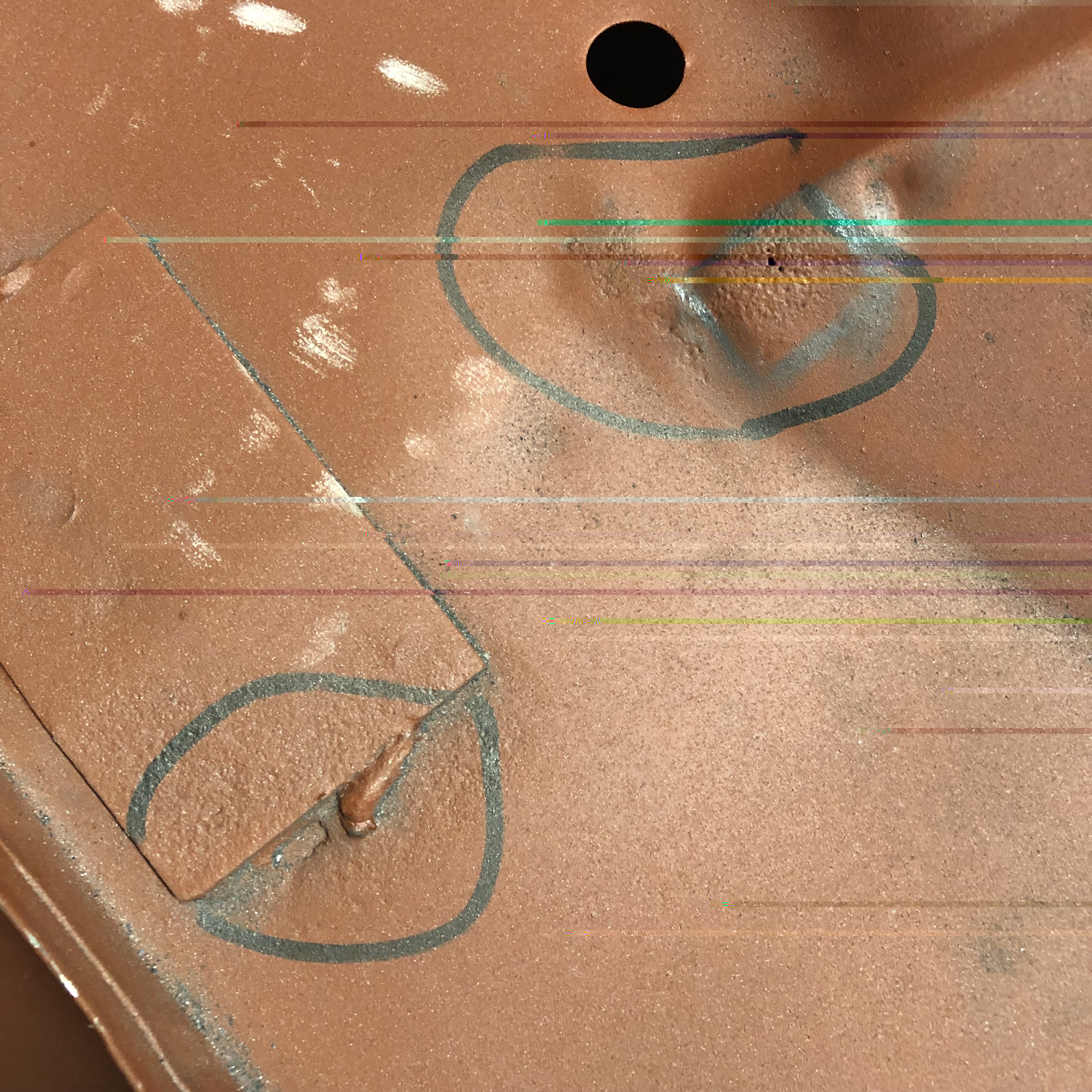

Easing myself back into the welding again over the last couple of weeks.
Finally, have the welder 'tuned in' and have it nice and hot without it blowing through. I think I was trying to get it too cold and that was making life a little difficult.
Rust is hidden in lots of places that needs to be cut out.
Hard to see where I made the welds.

Thats pretty good blending!

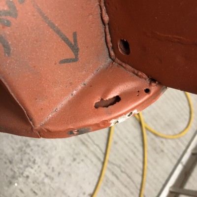

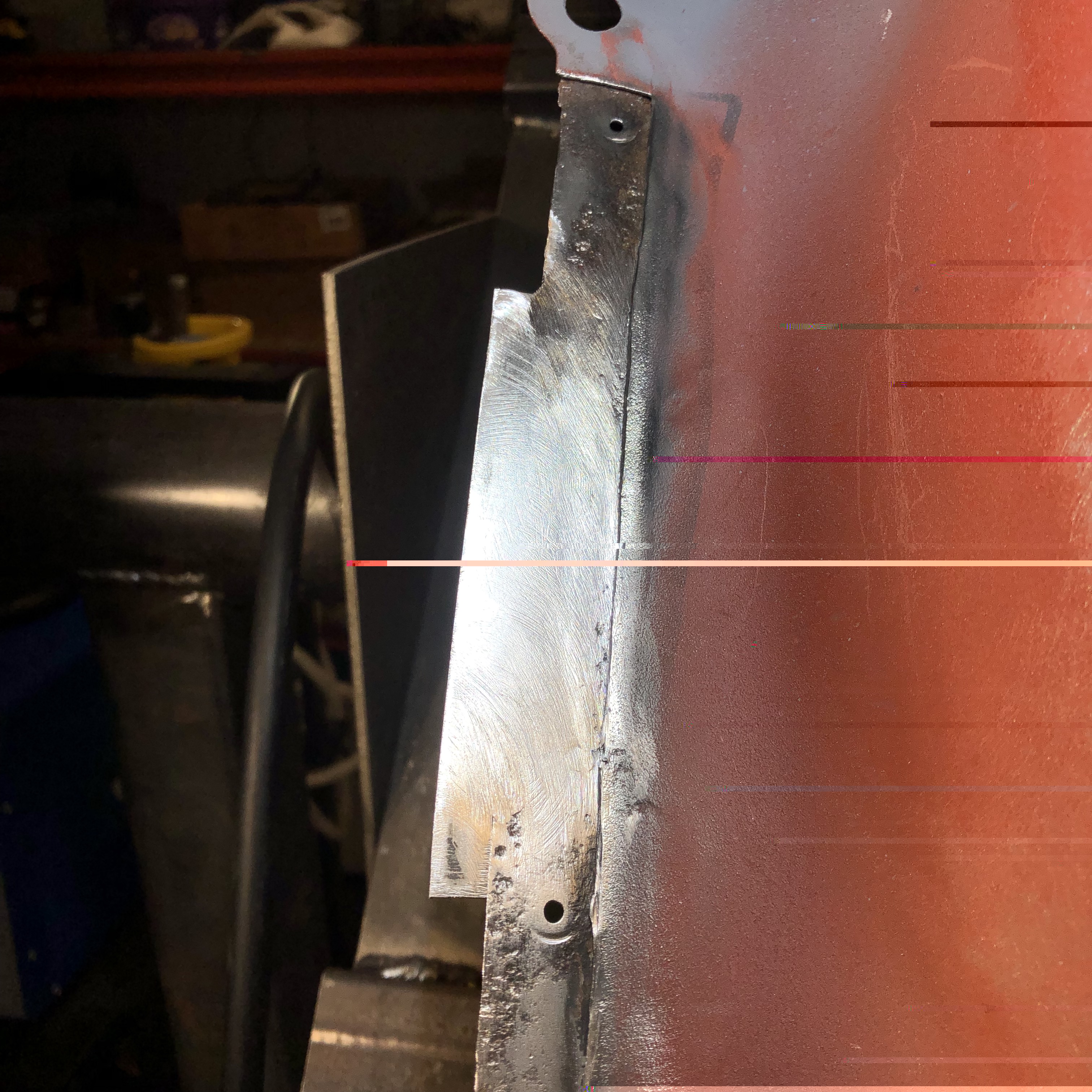

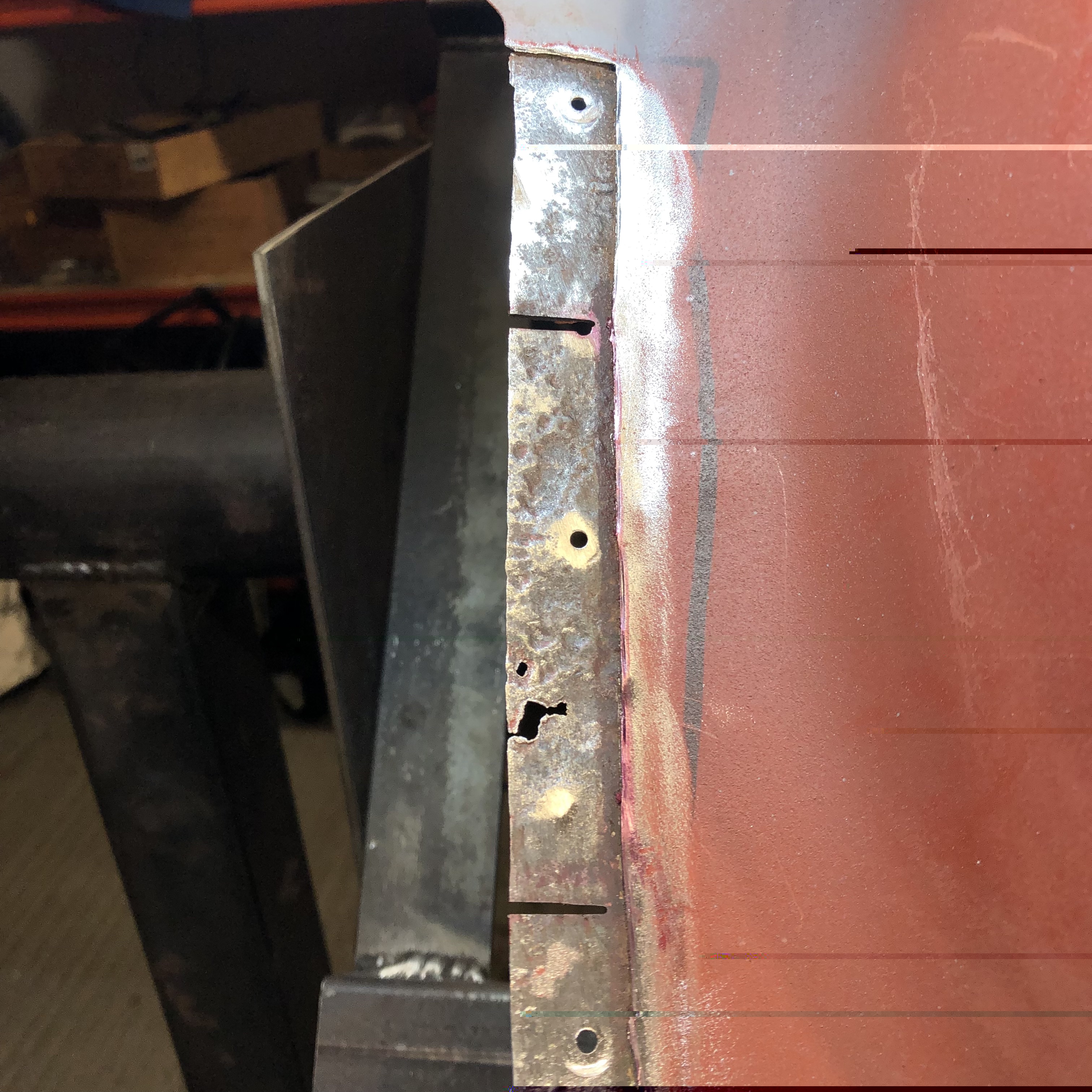

Drilled a few 6mm holes to plug weld from the other side when the patch is welded in.
Patch panel clamped in place
Tacked the patch in place and trimmed it back
Completed the weld. I used a stainless steel plate pushed between the boot and boot floor lip to take out the heat.
Weld ground down and some sprayed with some weld through primer.

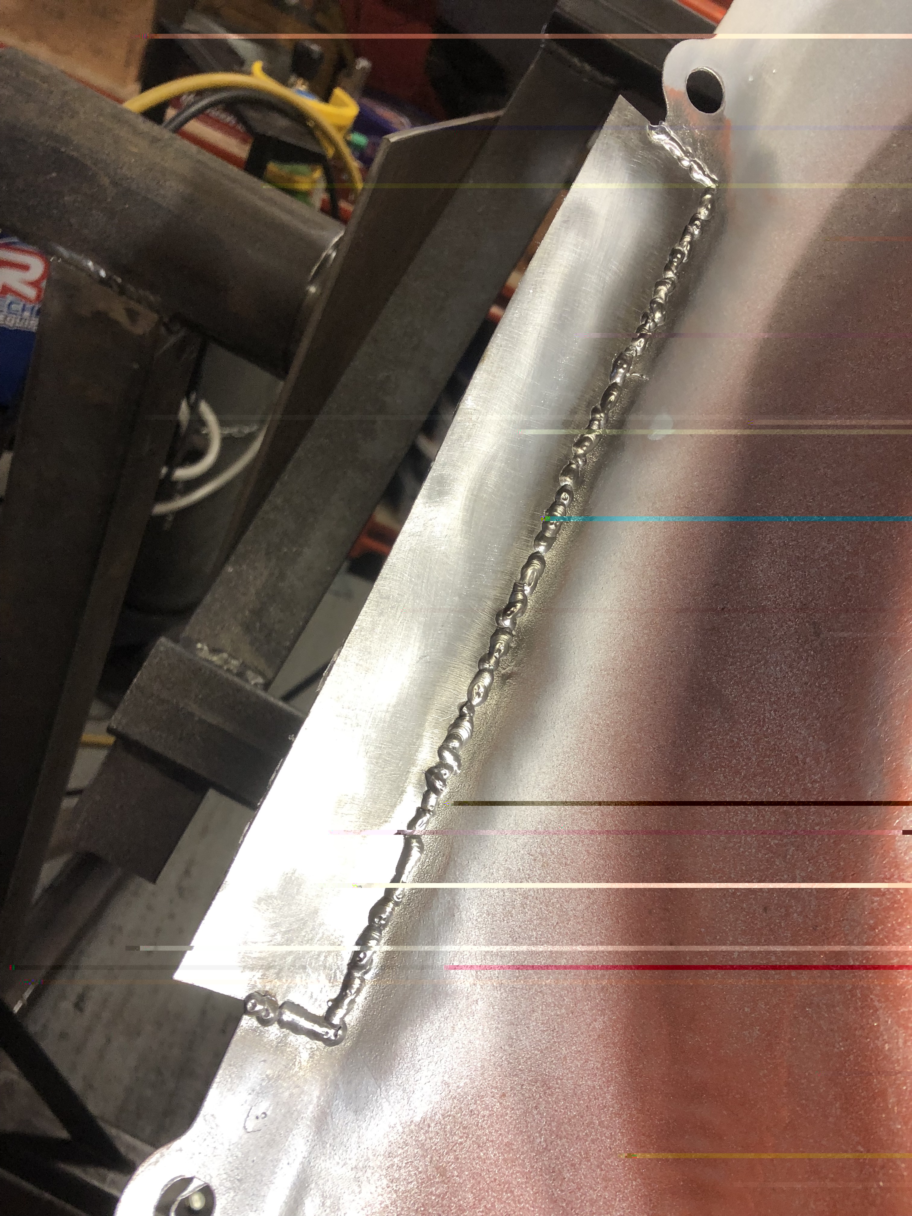

Cleaned up the boot floor butt weld. One small pin hole to fix but happy with the results. New valence closing panels arriving in a couple of days. Will start the other side soon and then will be close to finishing the rear end repairs.

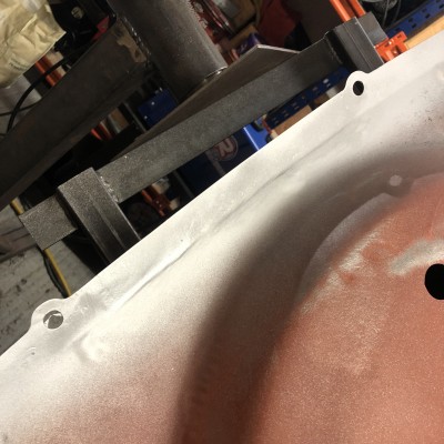

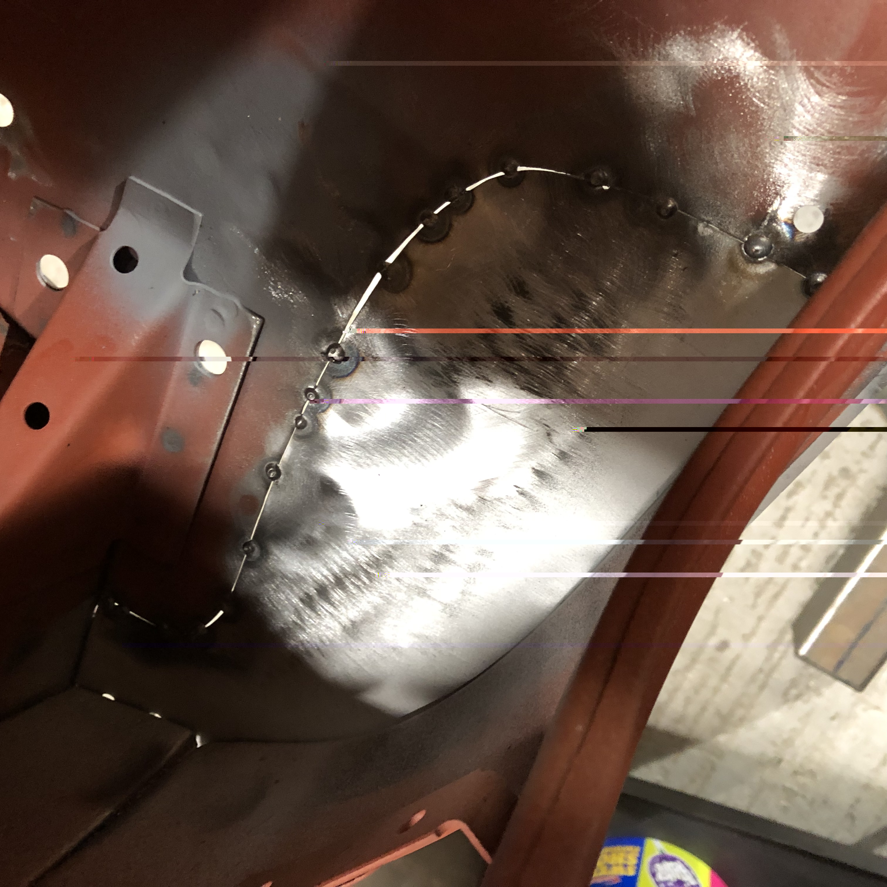

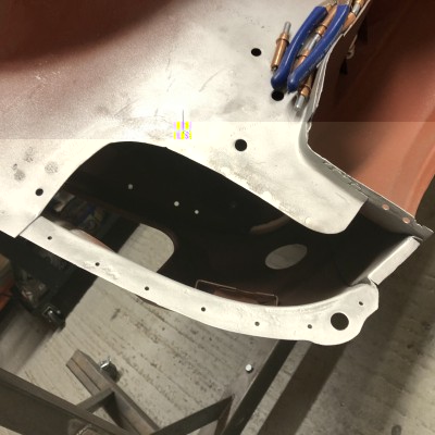

Finally started repairing the passenger side boot floor
Requires a similar patch panel to the driver’s side. Managed to salvage the fuel tank bracket too.

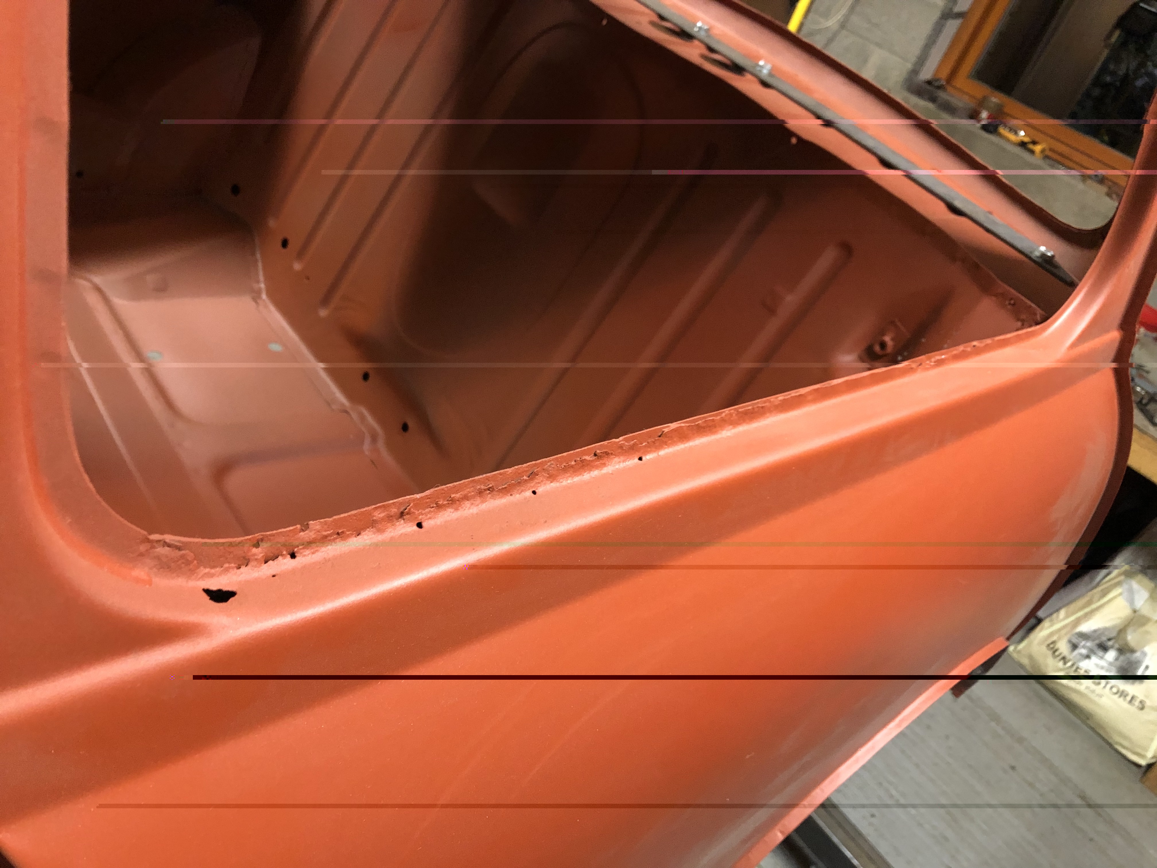

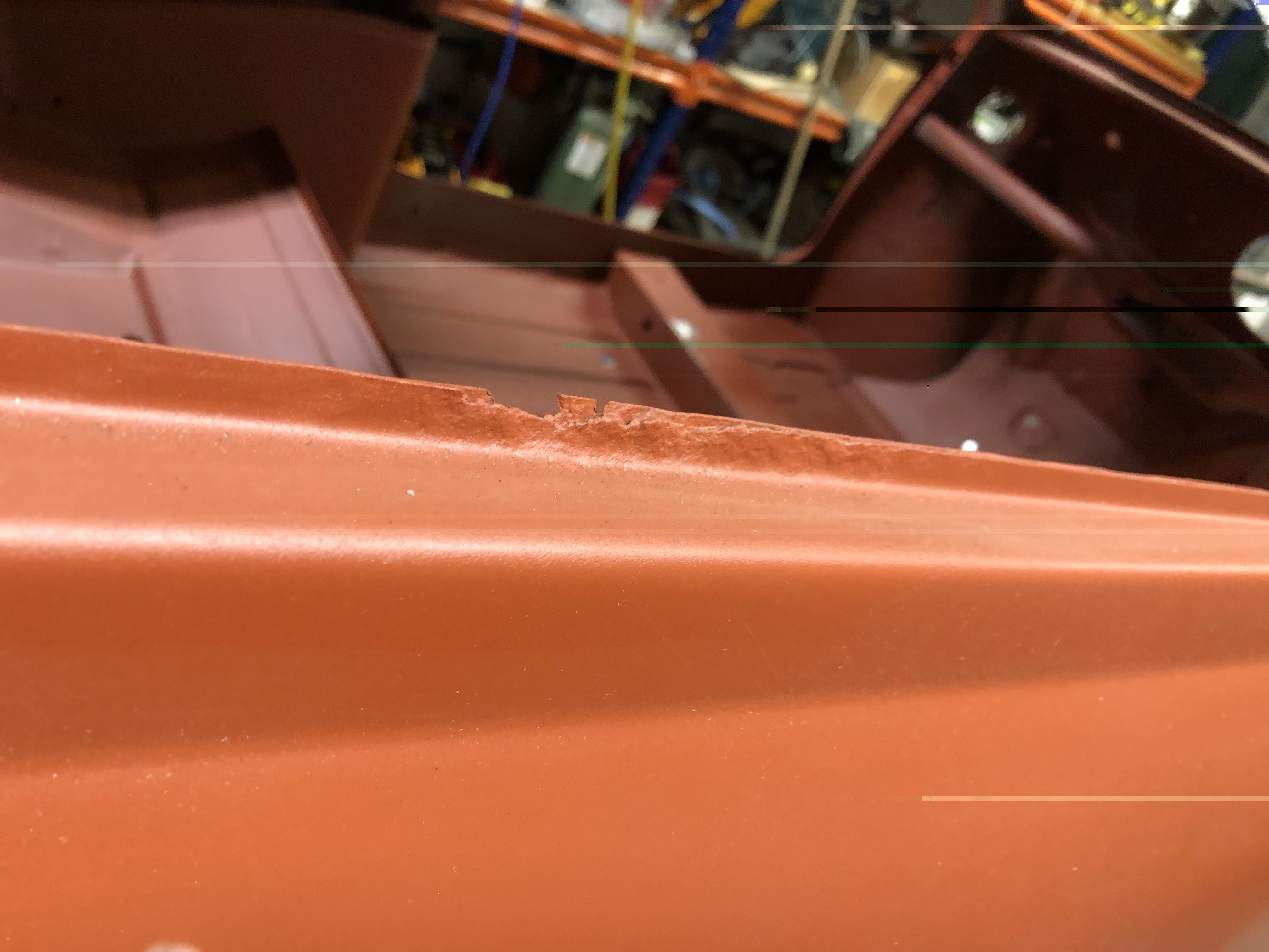

and then onto the two quarter panel window openings
Driver's side is not too bad, just a small section
Passenger one will require more work. Might need to finally invest or create a steel folding machine.

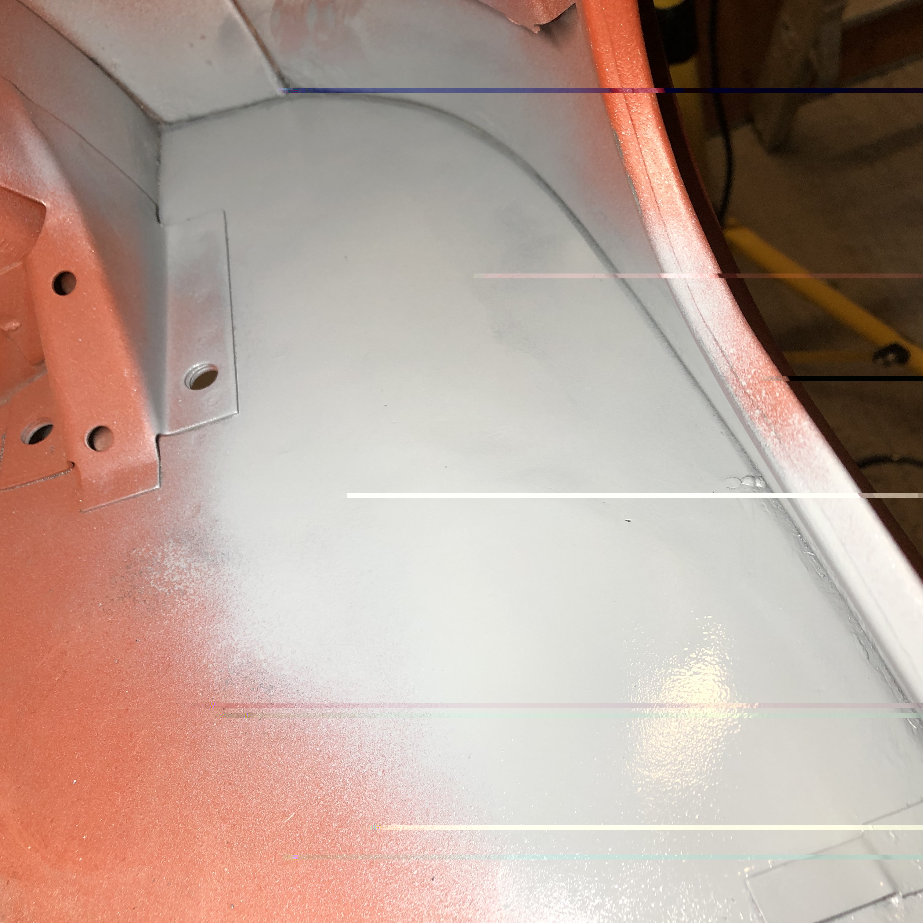

Got the other boot floor patch panel tacked in this evening.
From the other side
ctwomey
Posts: 351
Joined: Thu Jan 03, 2019 9:44 am
Whats your location?: Ballybrittas, Co. Laois

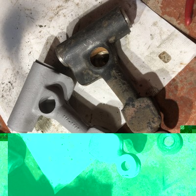

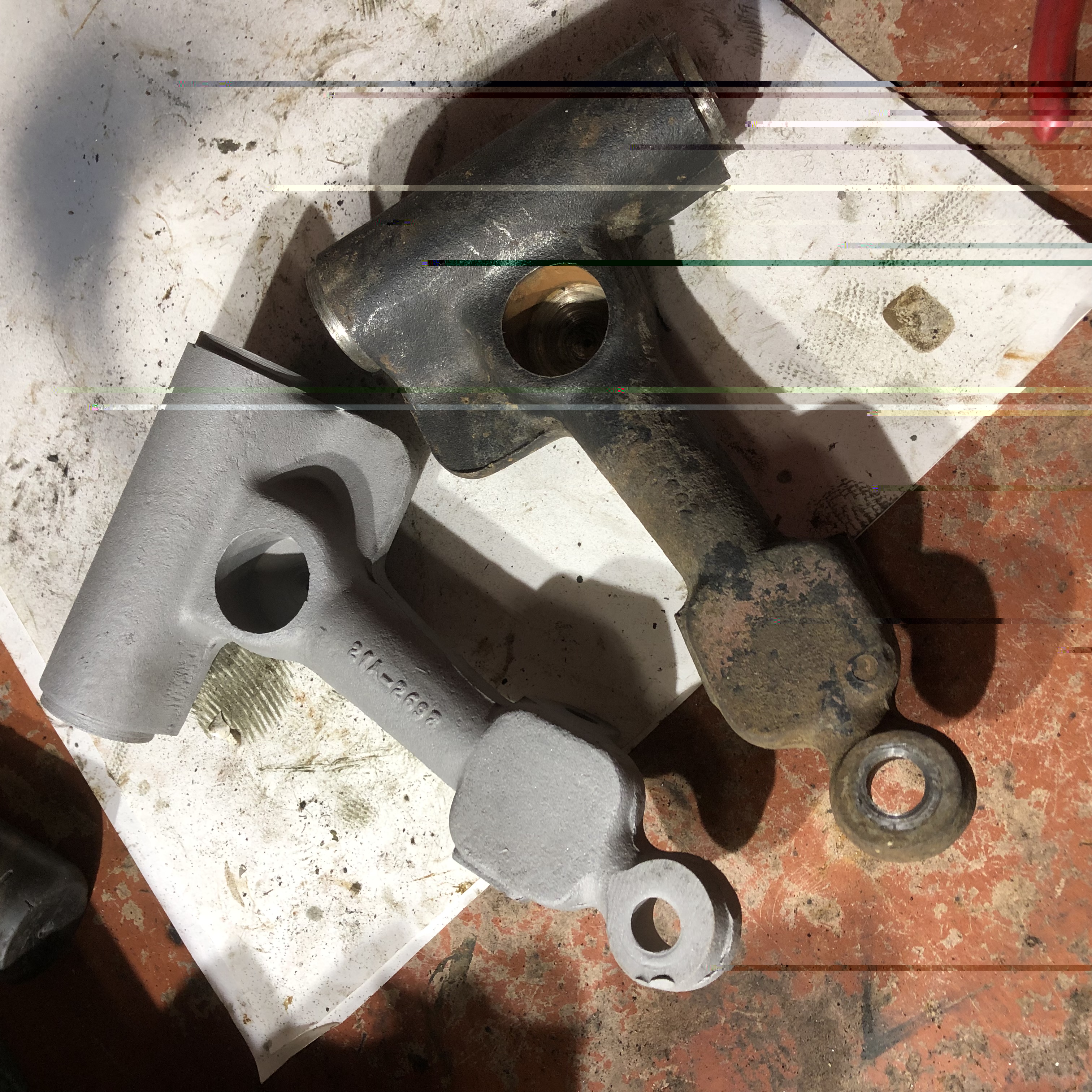

Blasting the suspension parts to get them ready for powder coating.
Hopefully will get these done along with the subframes. Lead time is 3-4 weeks with Carlow Coating.

Change of plan, decide to only get the subframes and petrol tank powder coated by a powder coating company.
I am going to do the rest myself. There are 22 items in the box and given an average price of €10-15 per item it could cost up to €330 to get them done. I can buy all the equipment to do the smaller items at home for around the same price. There will be more items to powder coat as I progress through the project too. A cheap oven off adverts.ie will cost less than €100 too.
Those suspension parts require a lot of masking and I simply can't see any company spending the time to mask off all the critical machined faces required.

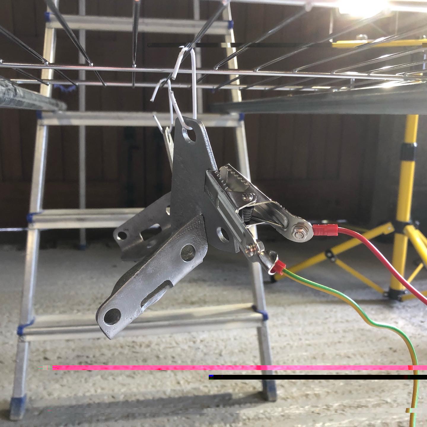

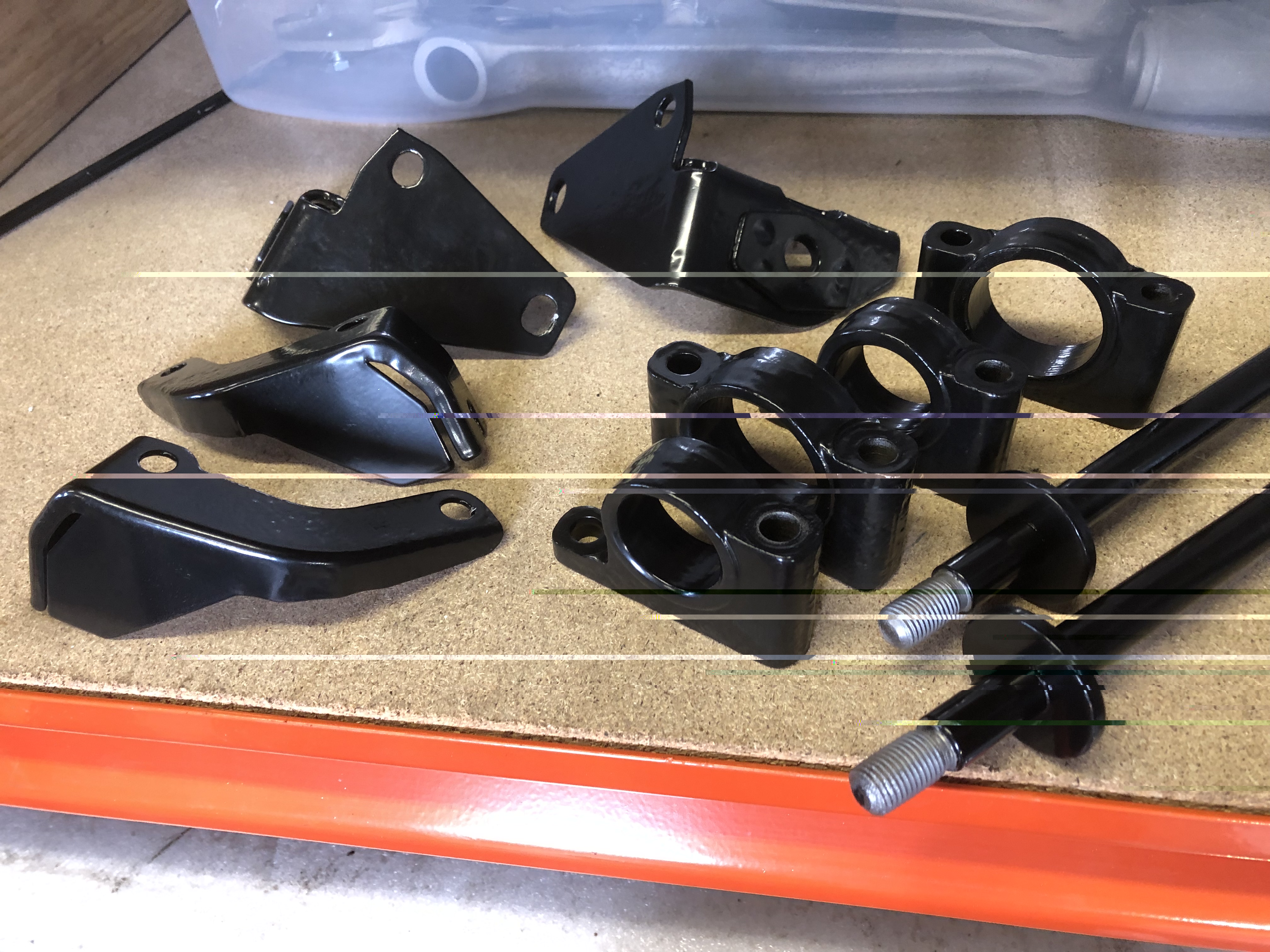

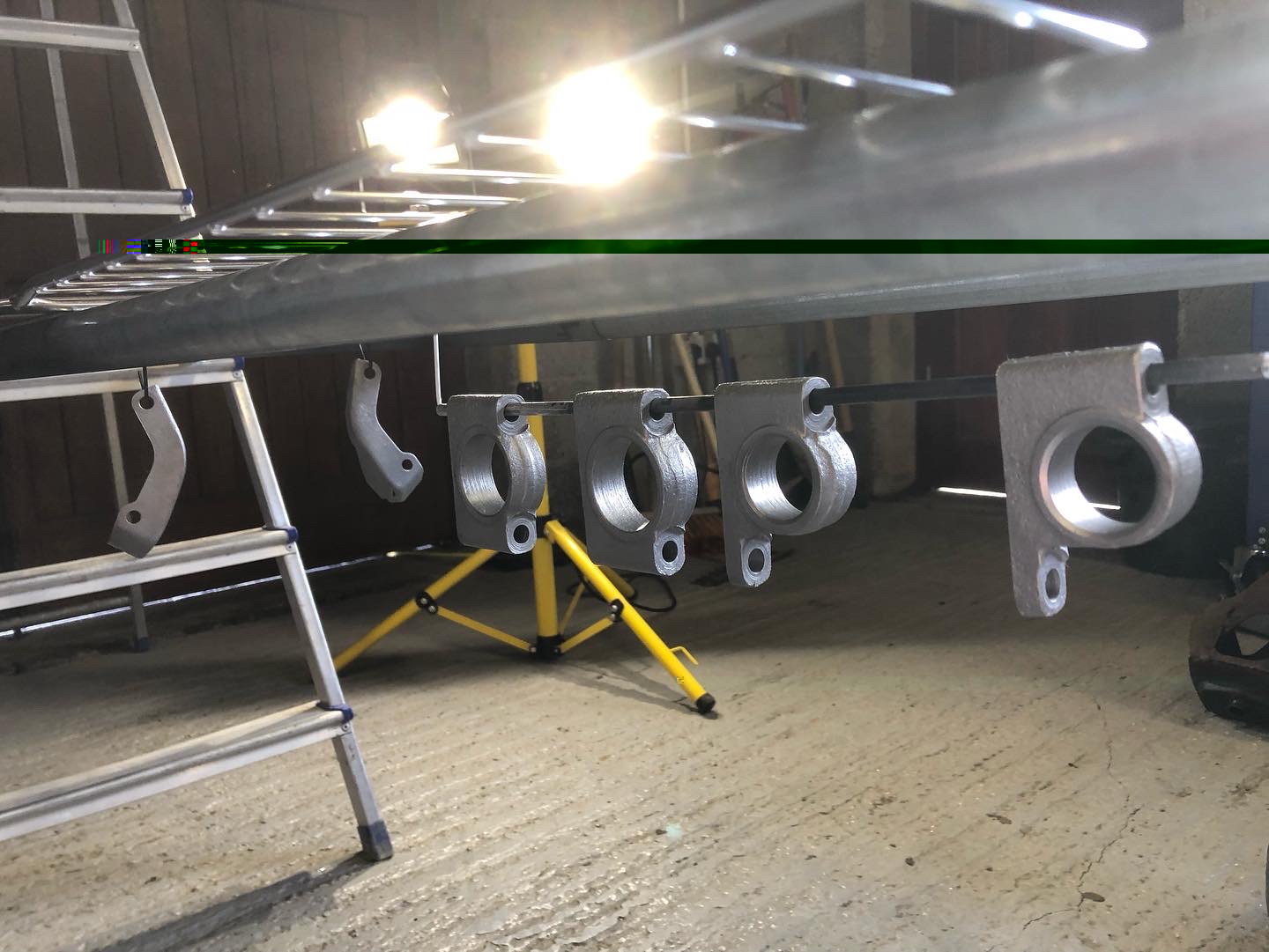

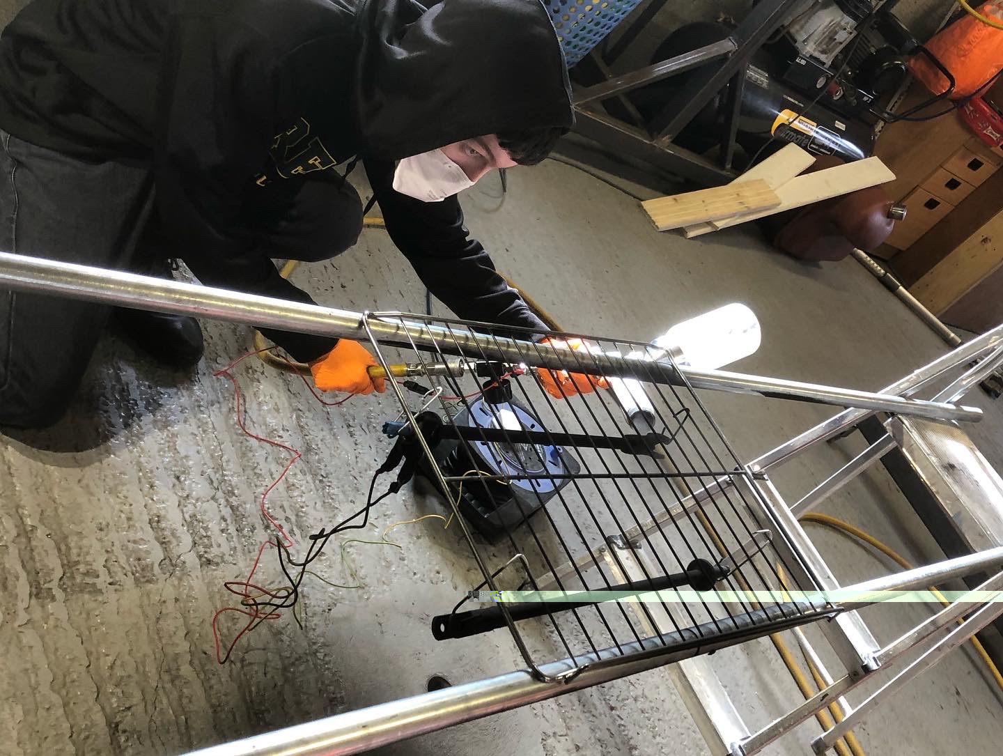

Successfully morning powder coating for the first time.

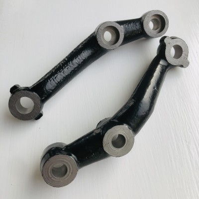

Steering arms came out great after some masking the machined surfaces prior to powder coating
