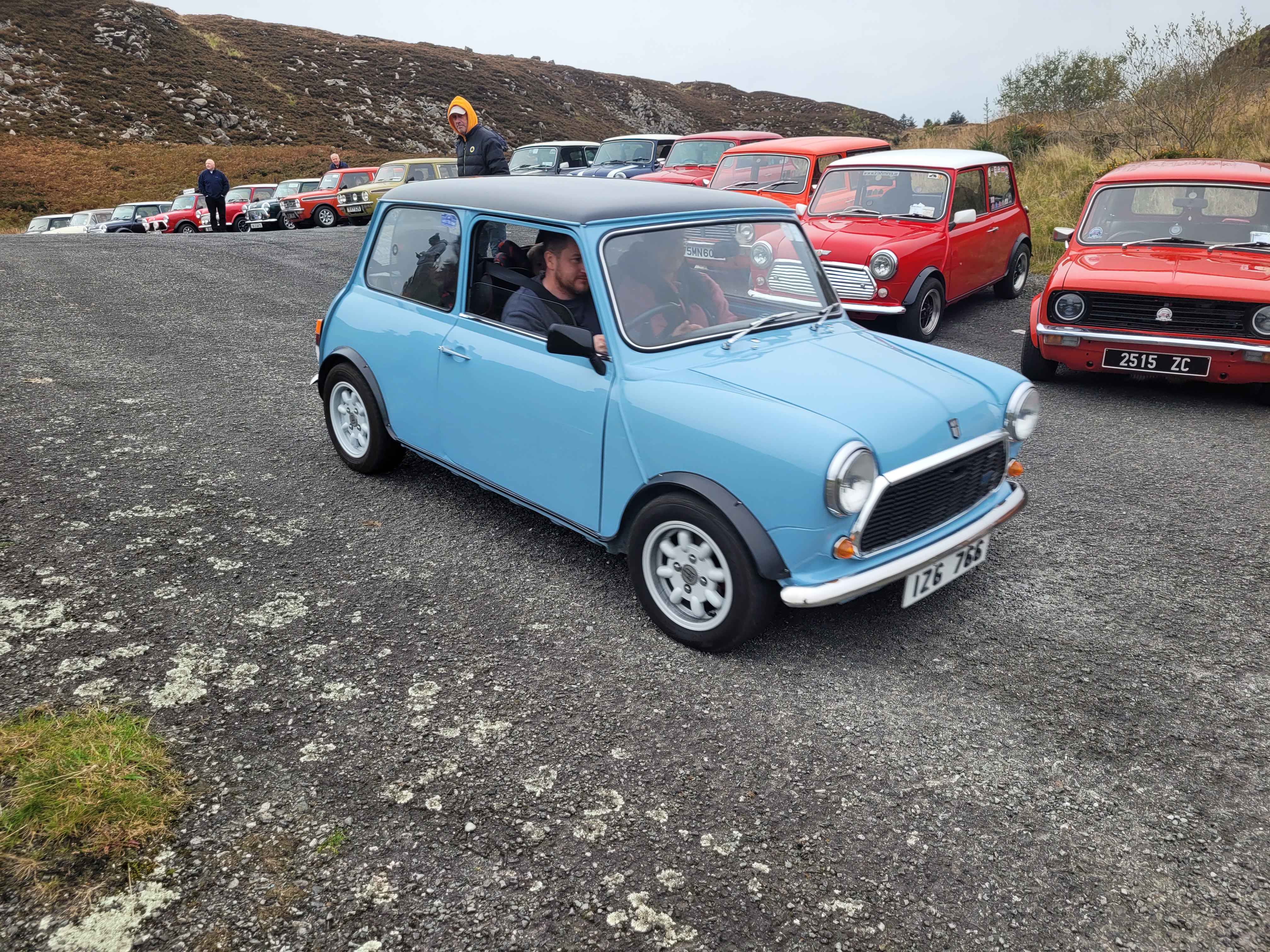

Went to a local vintage car and tractor run today, not a bad turn out and weather kinda held out, just a slight shower.
Car seems to be running good, engine temp nice and steady just on N.
I've a very slight knock when releasing the clutch to pull off, tried to rock the engine by hand but it seems to be as steady as a rock. I did notice that the inner poly bush on the top engine steady had started to crack, need to see if I have a replacement in my spares box.
Next big run is on the 4th August to Hillsborough for the Mourne Mini Club annual show, so that will be a 160km round trip.

Re: 1983 Mini City
A snap of the mini at the show yesterday. Around 250 classic minis at the show in all and rain held off until today.
Total distance traveled was about 425km (264miles) at roughly 45mpg (6.2L/100) which was pretty good. Car had zero issues the entire weekend, we done the last leg of the journey home of 1hr 45min in a continuous stint, took a while to loosen up my stiff back once pulled up at my house!

Re: 1983 Mini City
Really enjoyable run out today on the Cooley run, joined by some of the Norn Iron and Minis in Northern Ireland clubs.
19 at the starting point, another 3 joined along the way, then lost one due to electrical/fueling gremlins creeping into his Elf! A few others peeled off before getting this photo on the Sleeve Gullion drive...
A few more photos;
Plenty of smiles, beeps and waves along the way, weather stayed dry and car performed perfectly!
That's it now, I'll use it during the week for work to use up most of the petrol, then it will be moved to the back patio waiting for it's last wash before getting put into the shed.
Total milage for this year now stands at 3350km!
A few more photos;
Re: 1983 Mini City
Good day out, really enjoyed it.
