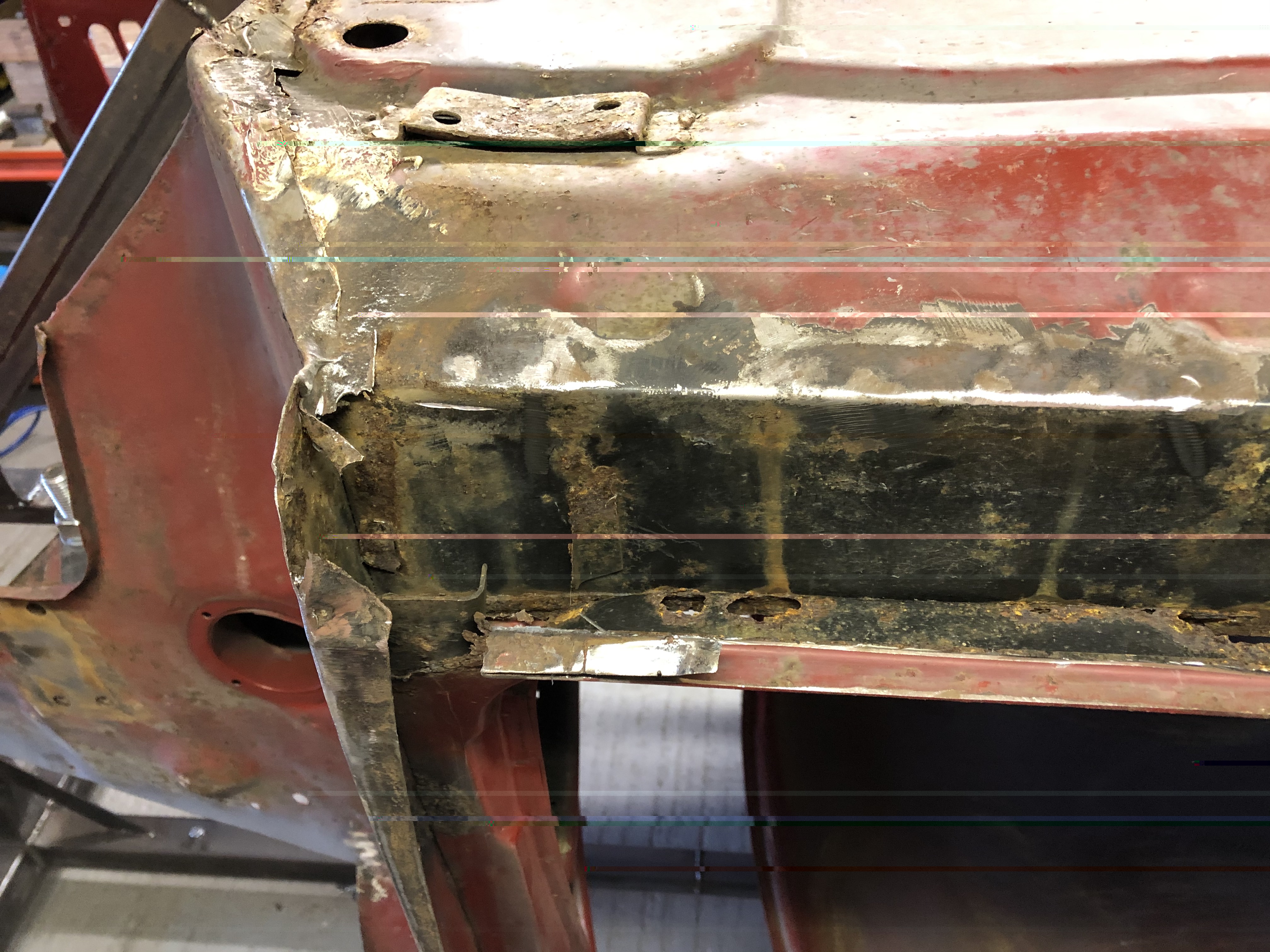

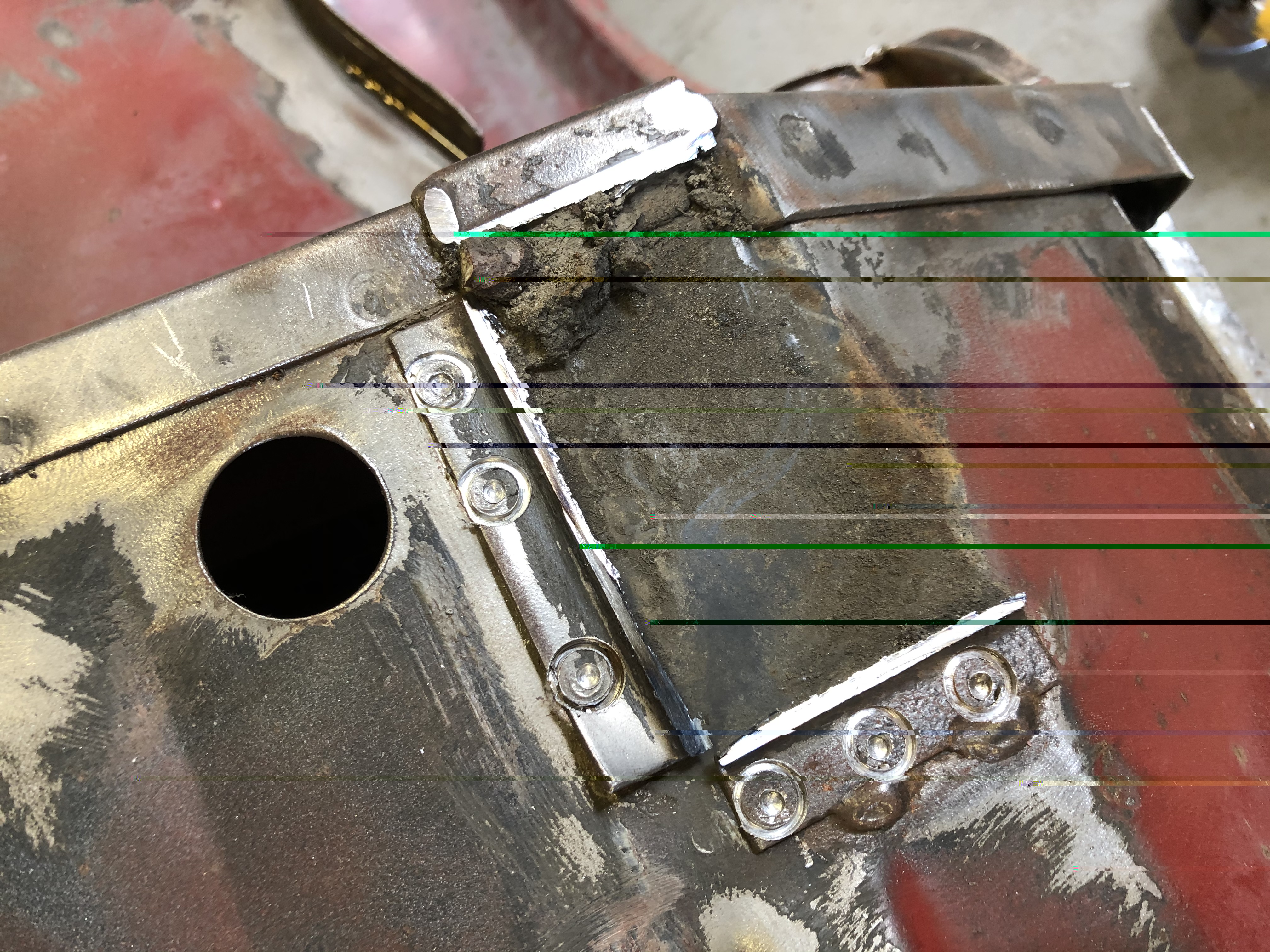

Re: 1981 Mini City 1000
Busy few weeks with work and homeschooling like so many others, so haven't had as much time for the Mini. Managed to get out today and removed the driver side outer sill.

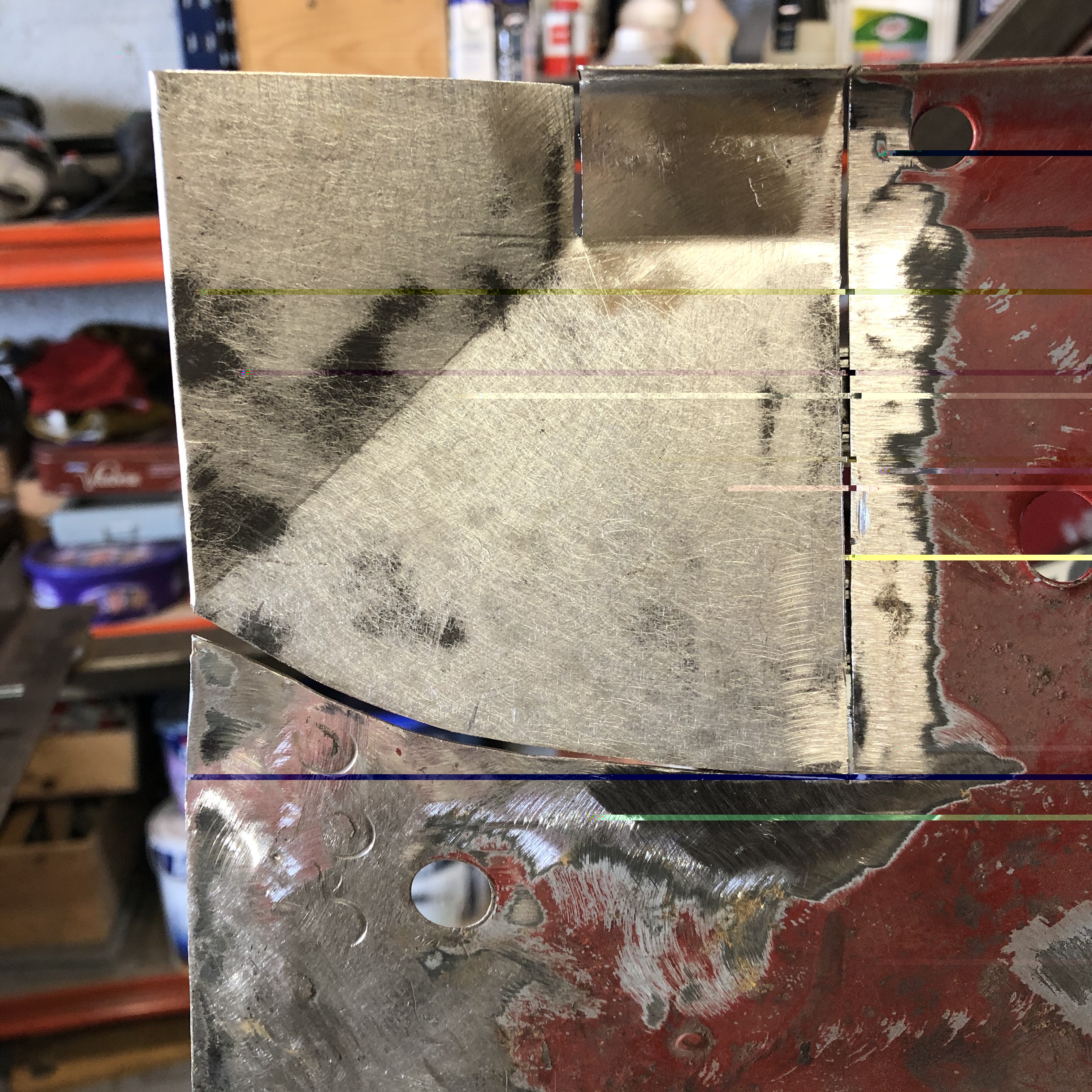

To get the piece of sill that is inside the rear closing panel you need to make this small cut in the corner to free up the weld.
Outer doorstep on the driver's side will need replacing as there are numerous holes in it.

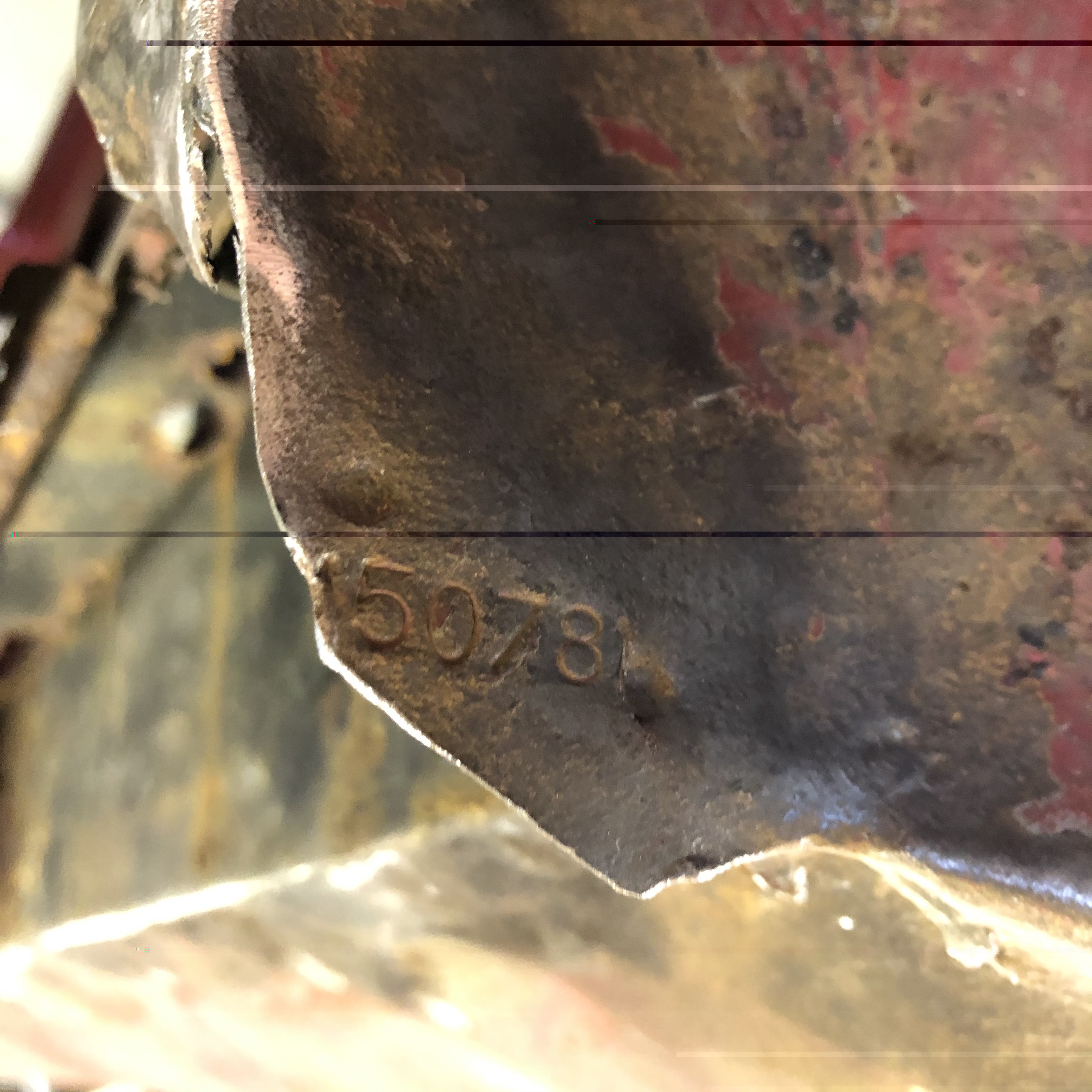

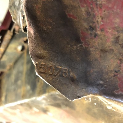

Found the stamp on the outer inner sill indicating an '81

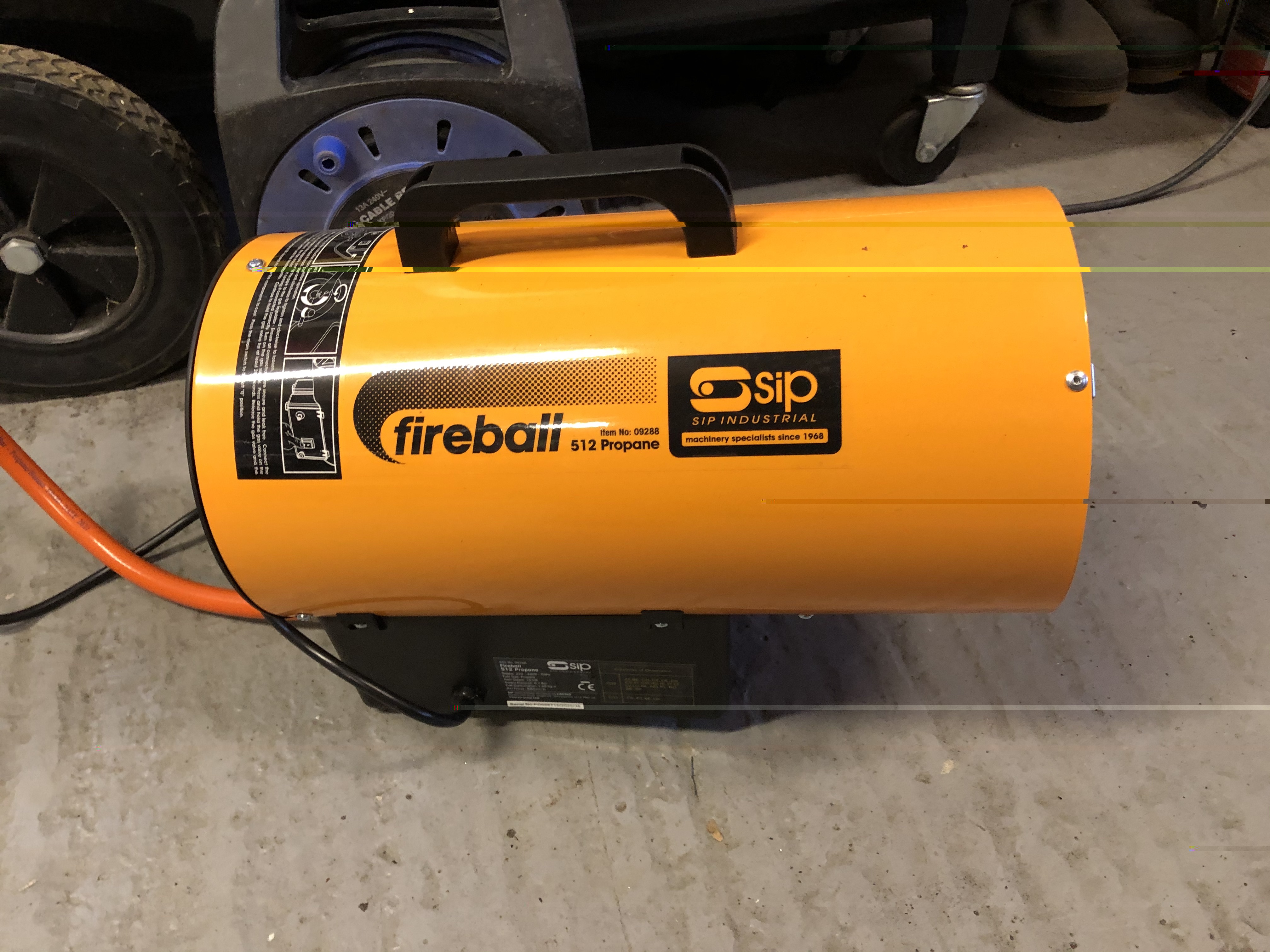

Also to keep the garage warm I purchased a small propane jet heater that is perfect for getting the cold out of the space.
Next is to finish up the areas where the outer sills join the floor and quarter panels, then on to replacing some steel on the inner wings that are damaged from where the front panel joins them.

General consensus is operator ID, then Week 07, 1981

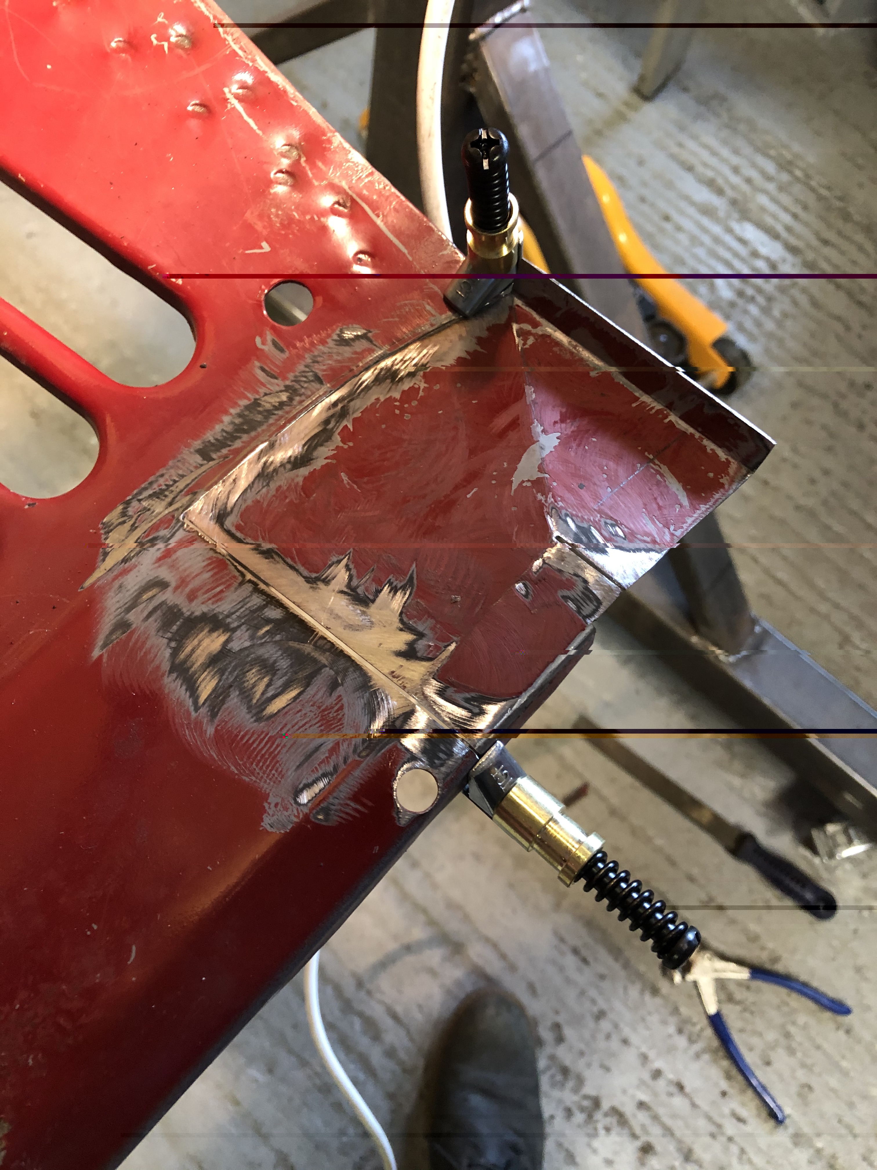

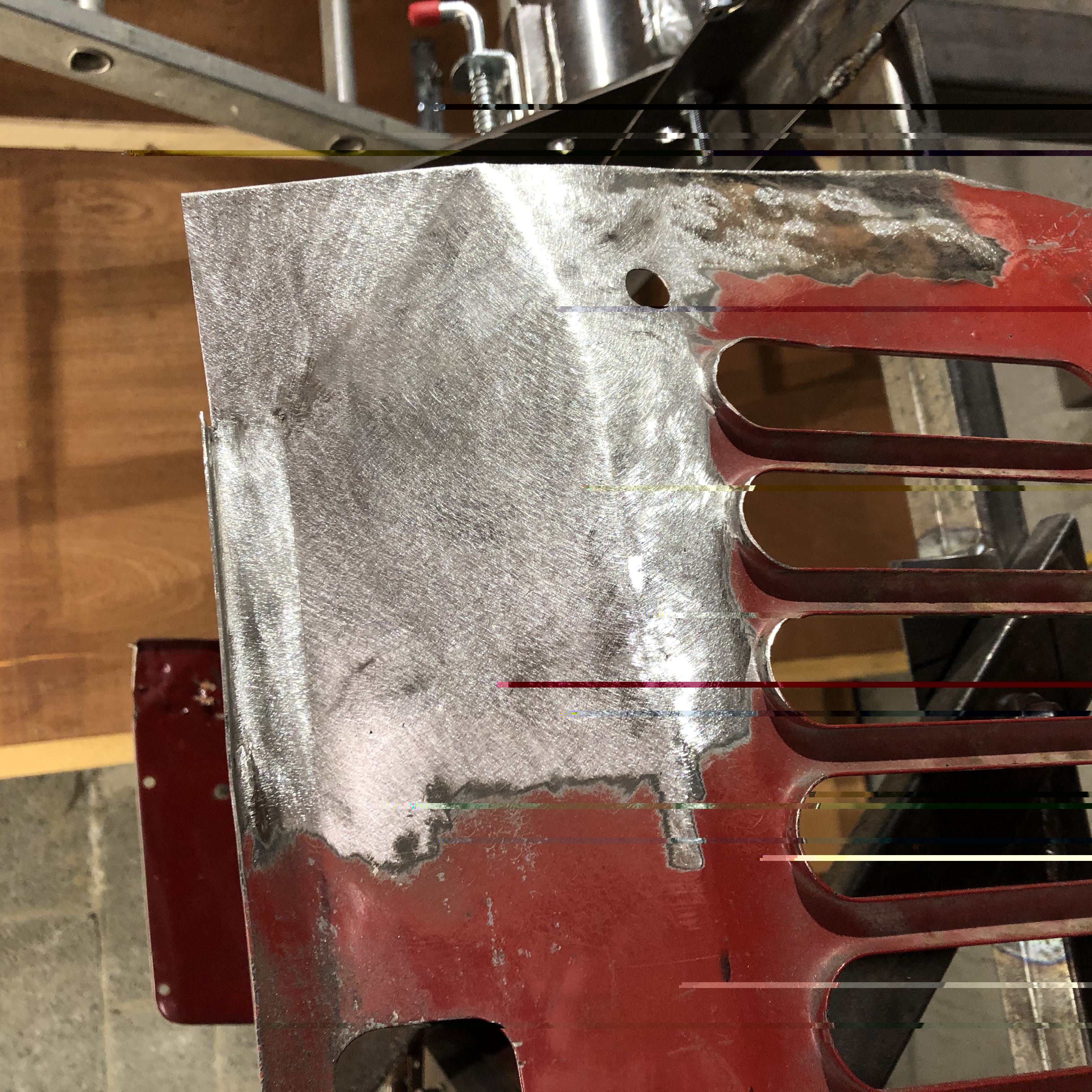

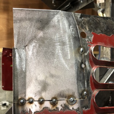

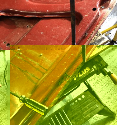

Good day in the garage today working on the mini
Removed all the seam sealer off the bottom of the car. Just a small bit in the engine bay and then the interior to do

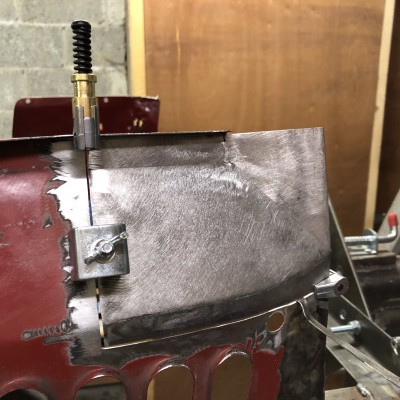

Cut out a repair patch for the inside front wing on the passenger side.
Sometimes the gap looks big but you get great penetration on the weld.
Tacked up ok but will have to come back to finish it off.

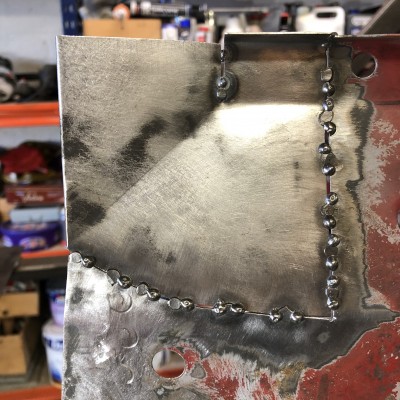

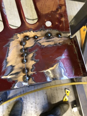

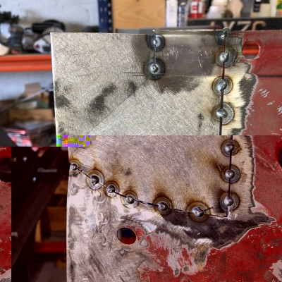

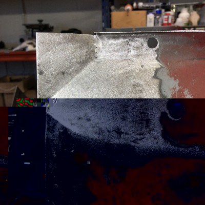

Made a complete mess of the previous patch panel.
Decided to cut it out and start again.
I spent a bit of time practicing on some off cuts and I think I have tuned the welder settings for butt welding 20gauge.
Took my time with the welding
Really happy with the final results. Probably took on the hardest form of welding as both sides of the butt weld are visible.
How does it look on the opposite side? Looks like you got good penetration and no pin holes or blowing through...
Should have the welding nearly finished now

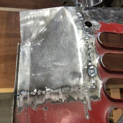

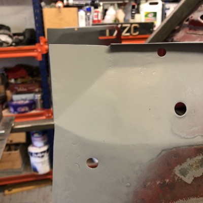

This is the inside of the inner wing finished off
Now to repair the other side

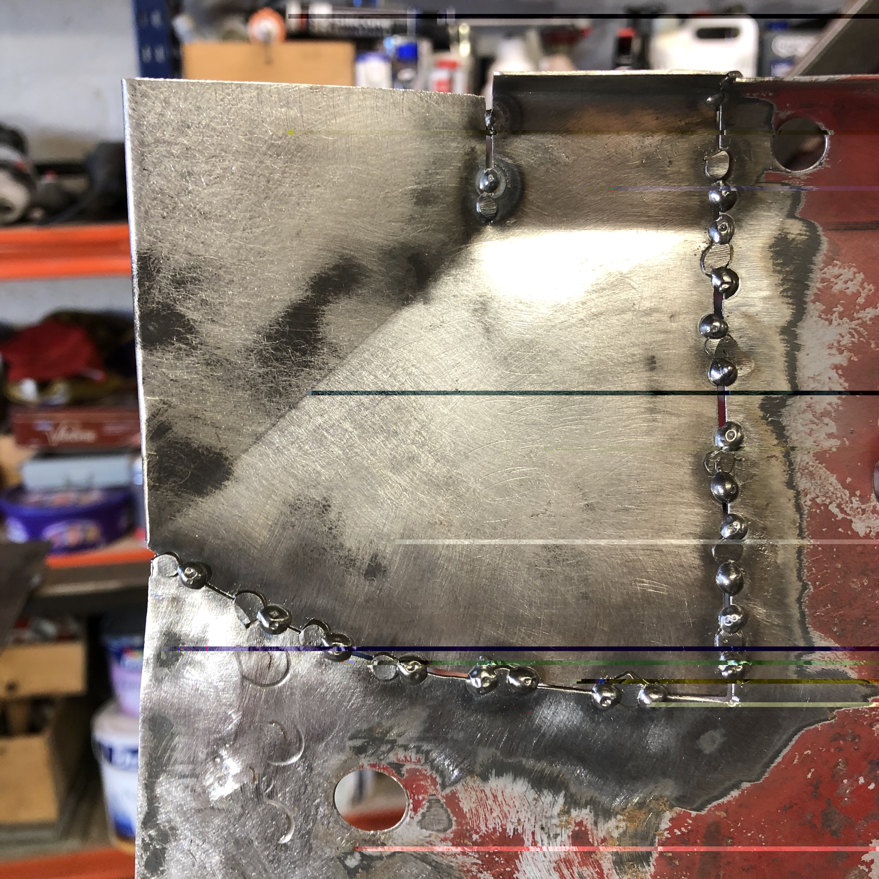

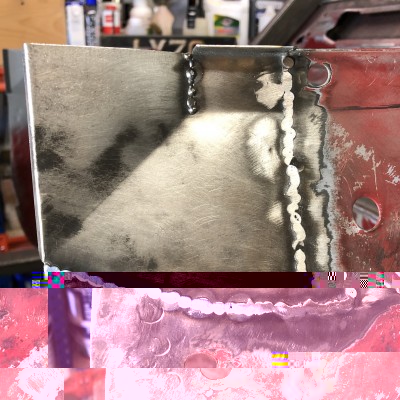

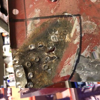

Fixed the mess on the other side
If you want decent penetration at low temperatures then you need to have a gap of 0.9-1.0 mm
Tacted up
Ground down the previous tacts so I can add the next tact beside it
Grinding down welds is tricky but an outside bend is the easiest. Inside bends or inside 90-degree bends is much harded. Always worth welding from the outside of any curve. The penetrated weld is much smaller.
Put some etch primer on until the shell gets vapour blasted.
Tacted up
That's looking very neat and tidy indeed! It's amazing how a coat of primer transforms the look of it and makes you feel like it was worth all the hassle!
Keep up the good work...

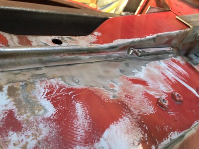

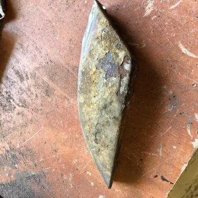

The more you work on these minis the more you realise how bad the manufacturing process was. Amazing how any of these survive.
Bare metal with no protection. Seam sealer plastered everywhere. Big blob under rear slinging brackets.

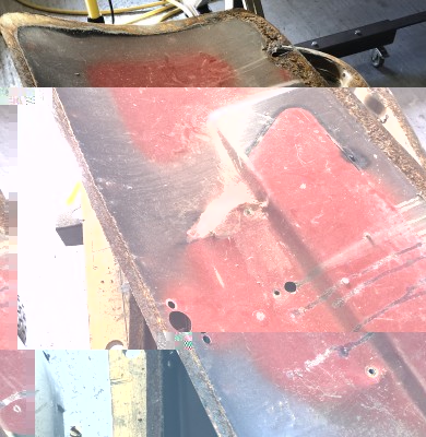

Just use a 60 or 80 grit flap disk on the edge until you see a hairline crack in the steel, that will indicate that you have ground down through the bend of the fold of steel.
There are four spot welds you will need to remove. Two under the hinges between the two holes and then two more in the lower part of the reg plate area. I just ground them down from the outer skin side and then the internal frame was undamaged.

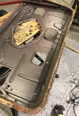

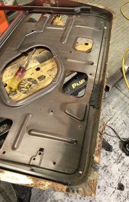

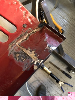

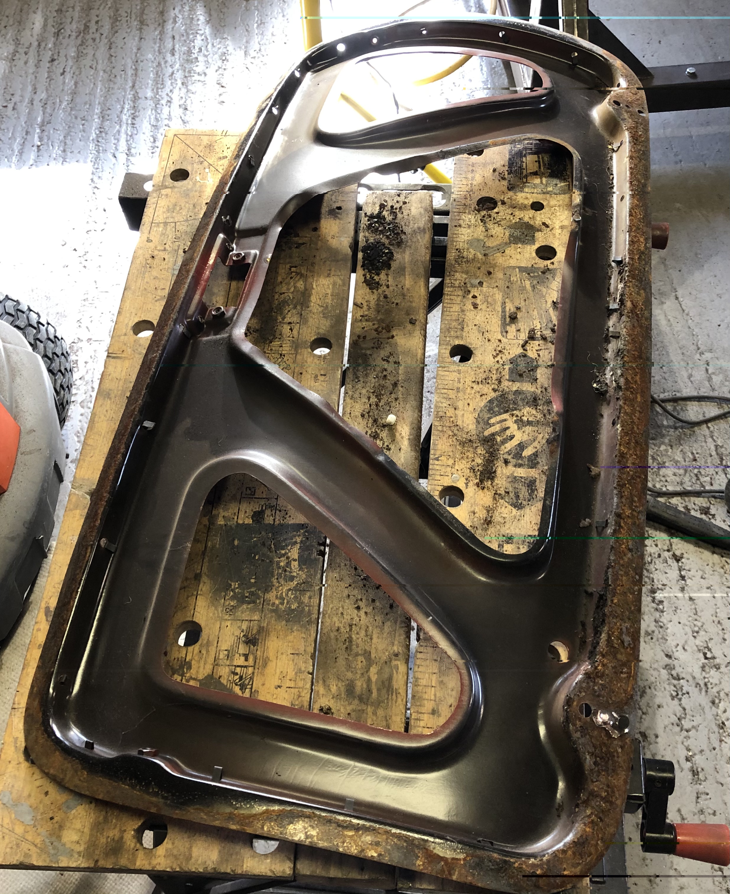

Got the outer skins off both doors.
Just a strip at the bottom that needs replacing on both.
Passenger side is a little worse for wear but very repairable.
Lots of welding to do but just think I will be a dab hand at it when this is all done (note: keep saying that to yourself)

Great work, planning on attempting mine this weekend, both need the bottom repair panels.
Same process as the bootskin? There's a few spot welds to drill out too?
