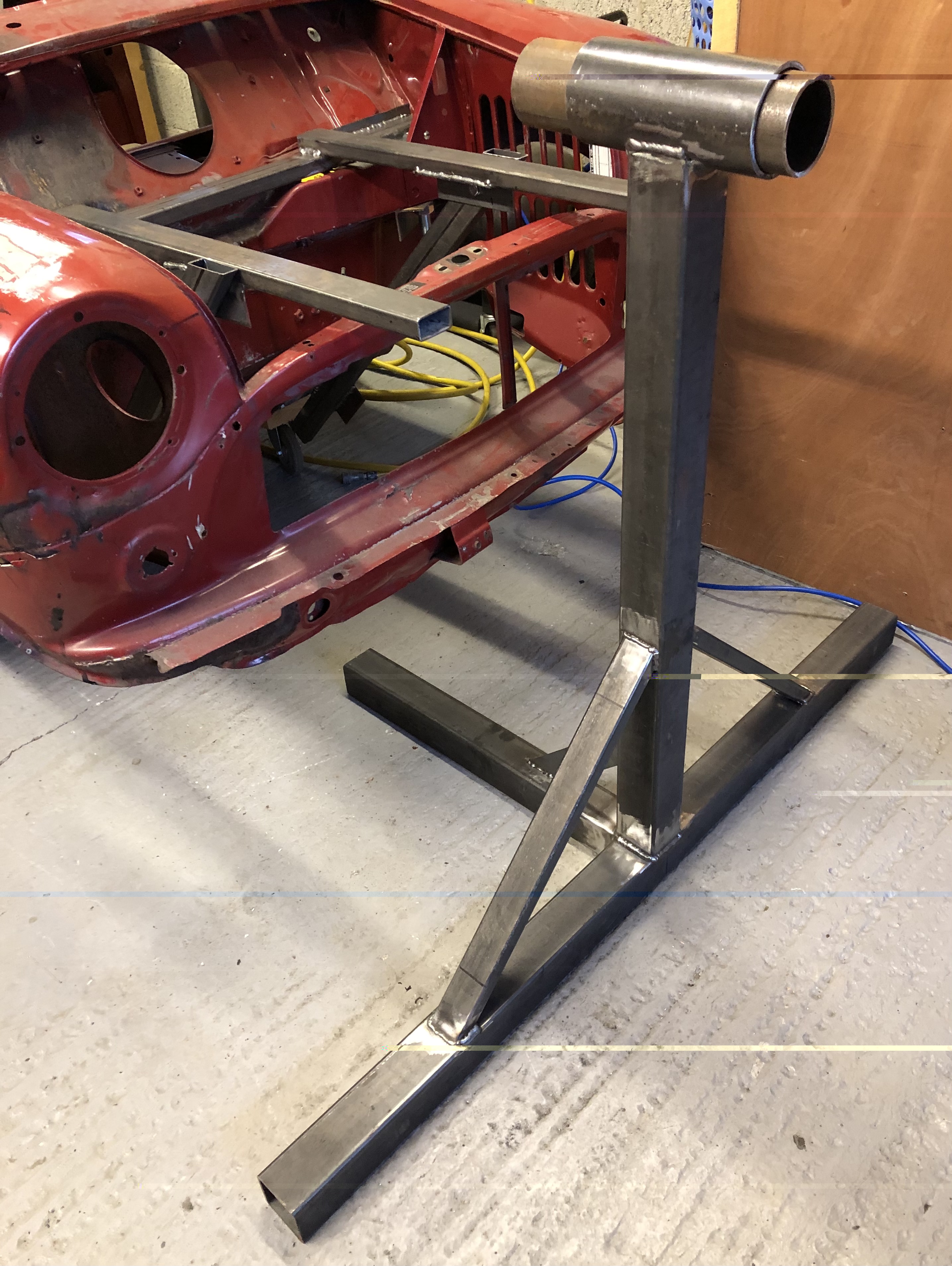

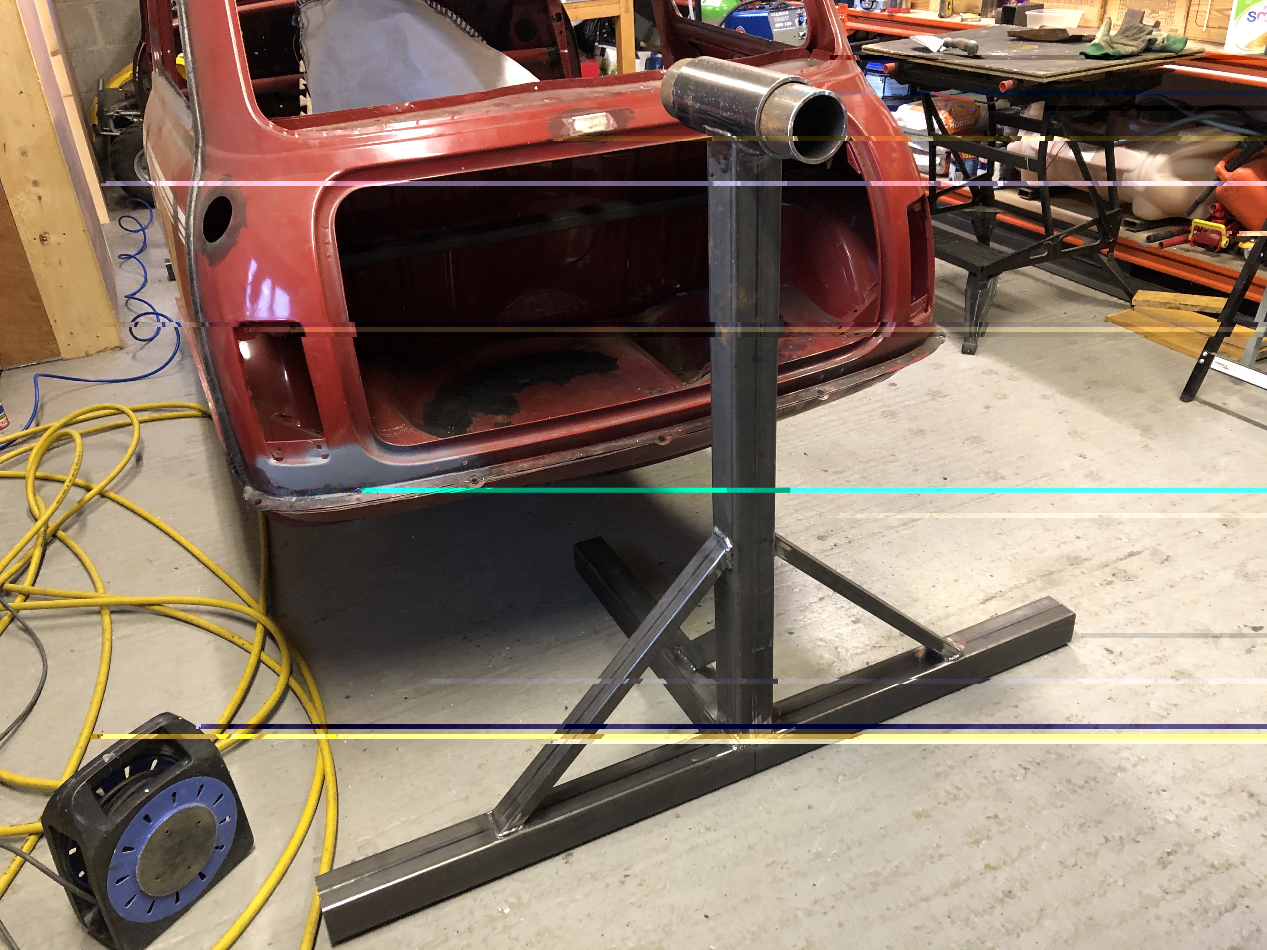

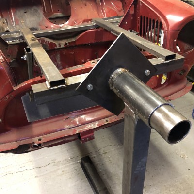

Some progress on the roll over jig
Made the stands and happy with the outcome. Need to get some more steel to finish it off.

That looks great, plenty strong, is that 50x50 box?
Are you gonna put some form of liner in your pivot point or have you used seamless tube?

The box section is (70 x70 x 3mm), the supports are (50 x 25 x 2.5mm) and the circular tubes are (88.9 x 5mm) and (76.1 x 5mm) used for the inside. Given the length I used for the outer tube is only 200mm long I was able to use an air grinder to grind away the weld seam so the inner rotates without any issues. There is also some 50 x 3mm angle and 3mm flat thrown in for other parts.

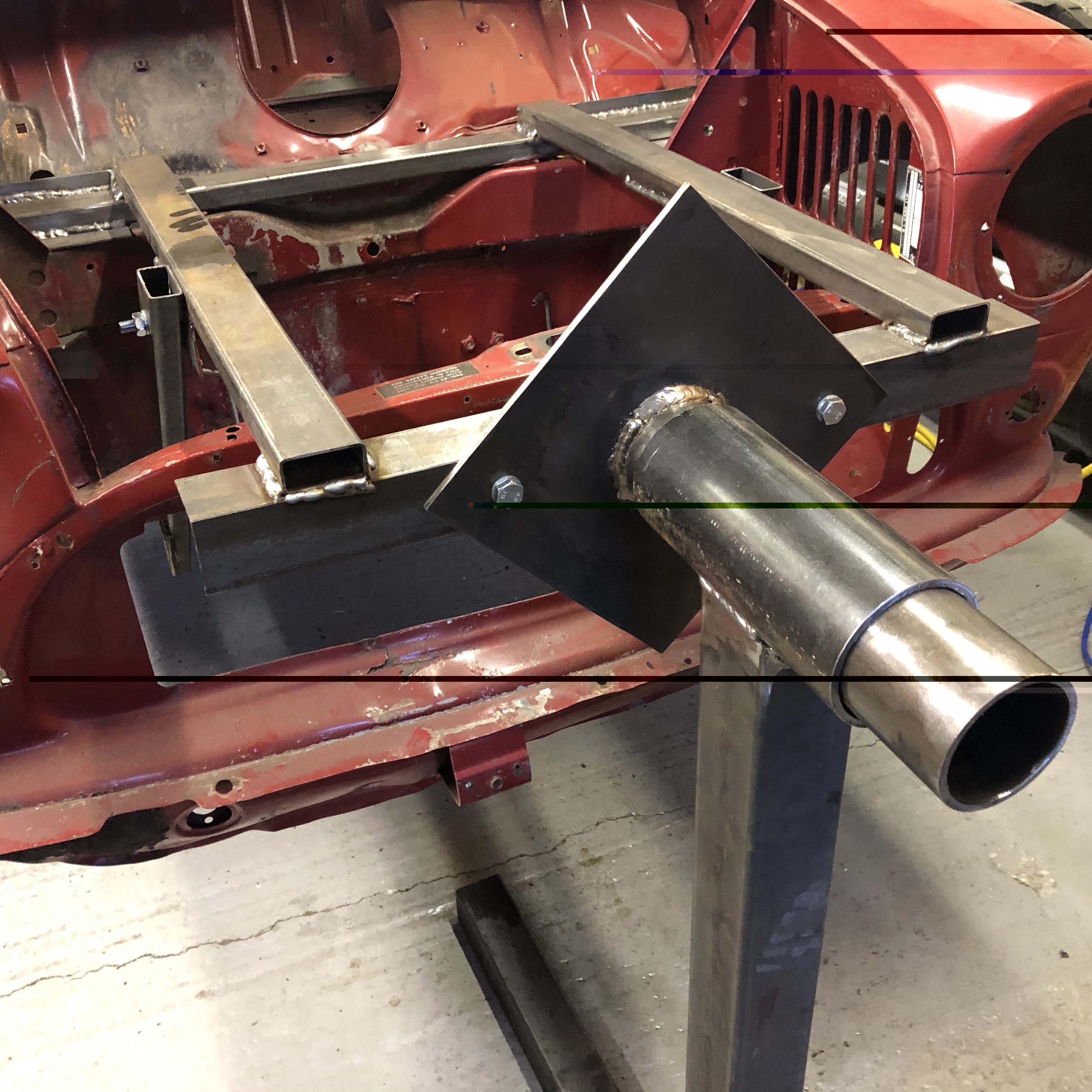

Very productive day today. Finally got the mini up on the rollover jig. I still have a few items to complete on the jig including adding castors to the stands, joining up the two ends with 60mm x 60mm box section to make it more stable and adding a mechanism to lock the rotation in any angle.
YouTube video of it in action is here https://youtu.be/7WWHgNd4xDE

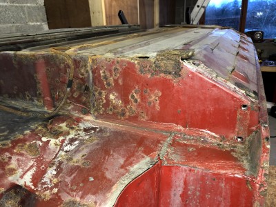

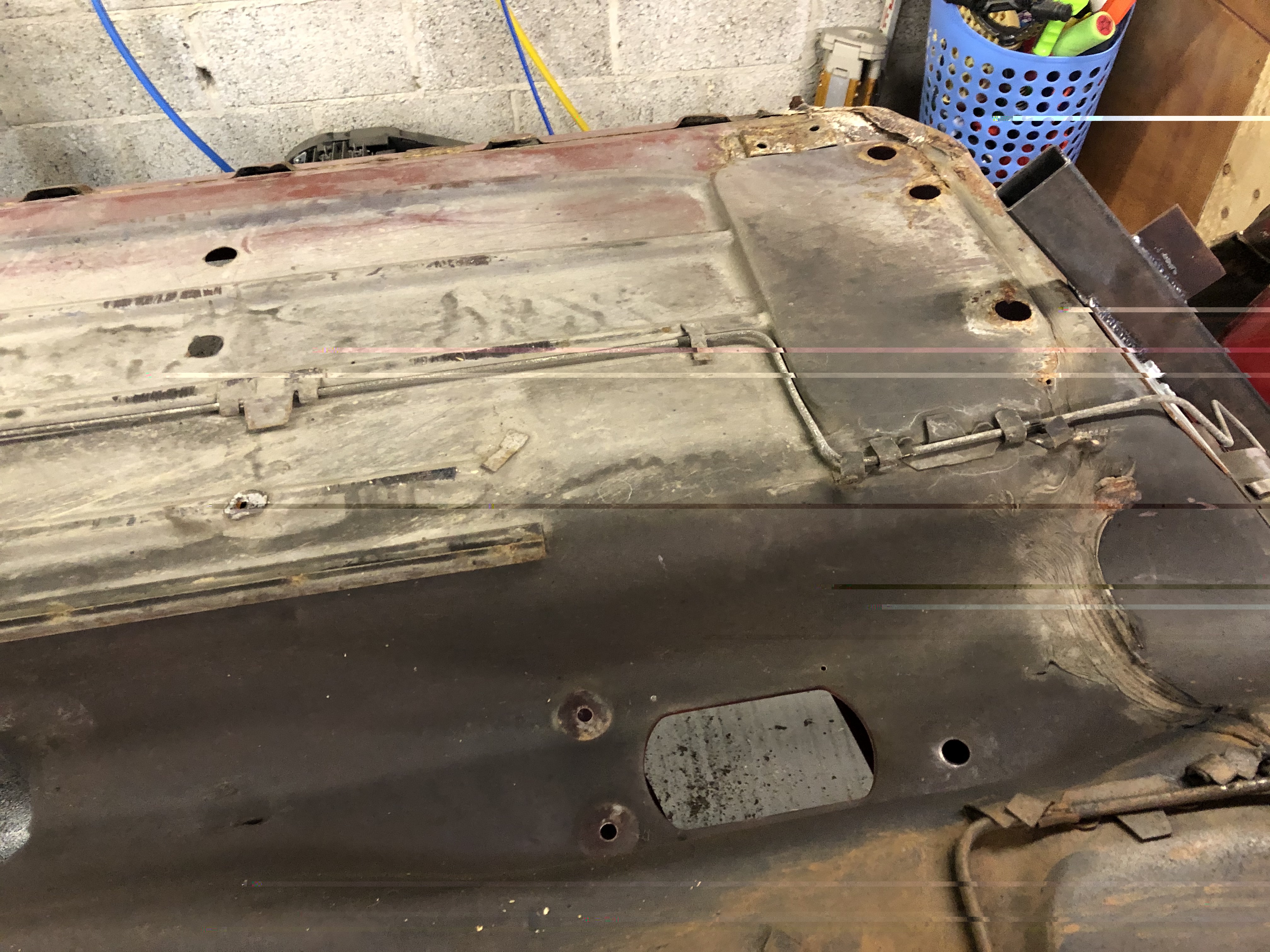

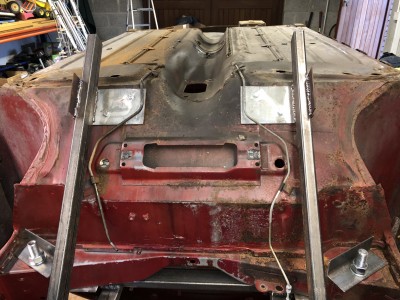

Re: 1981 Mini City 1000

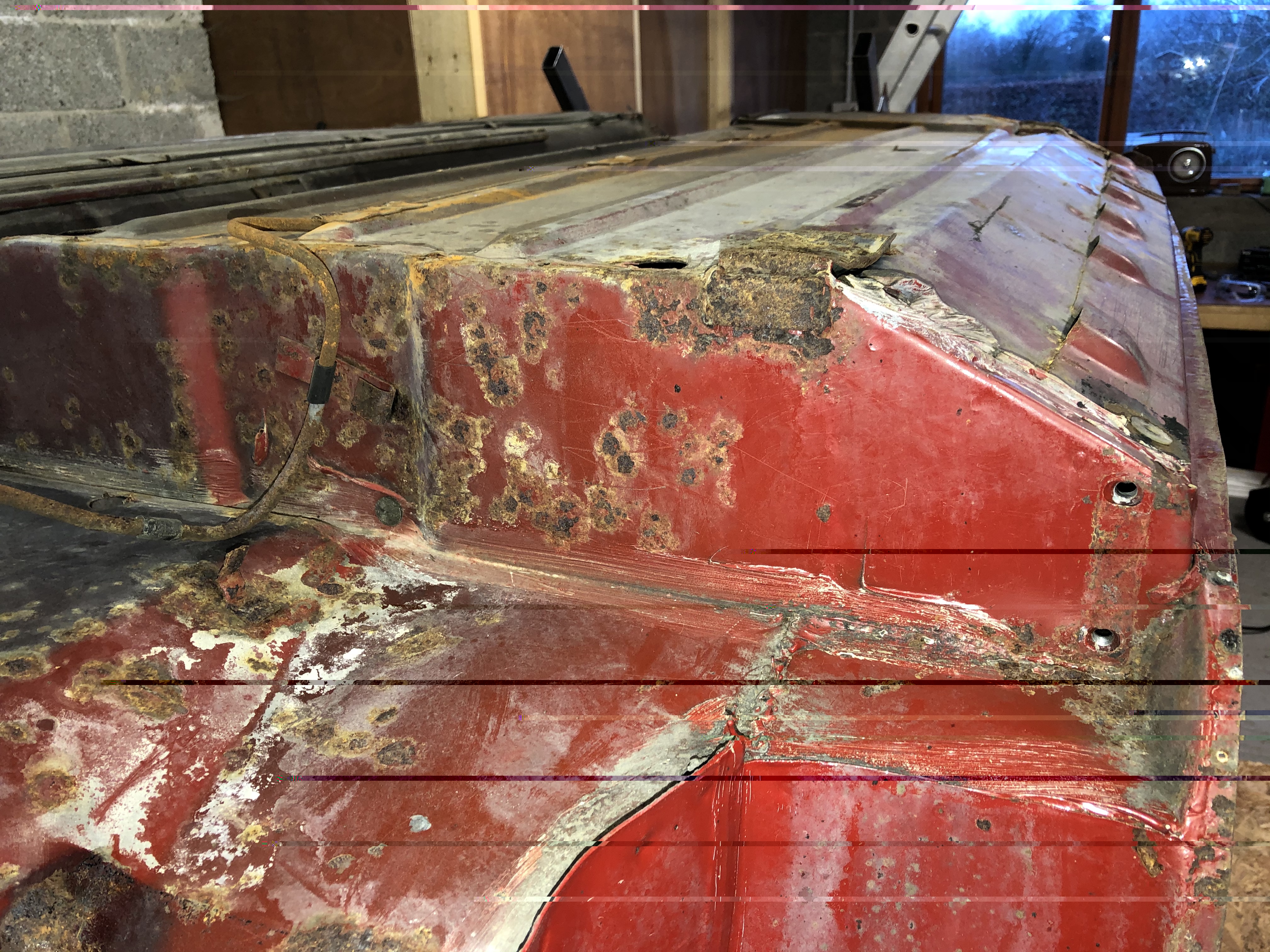

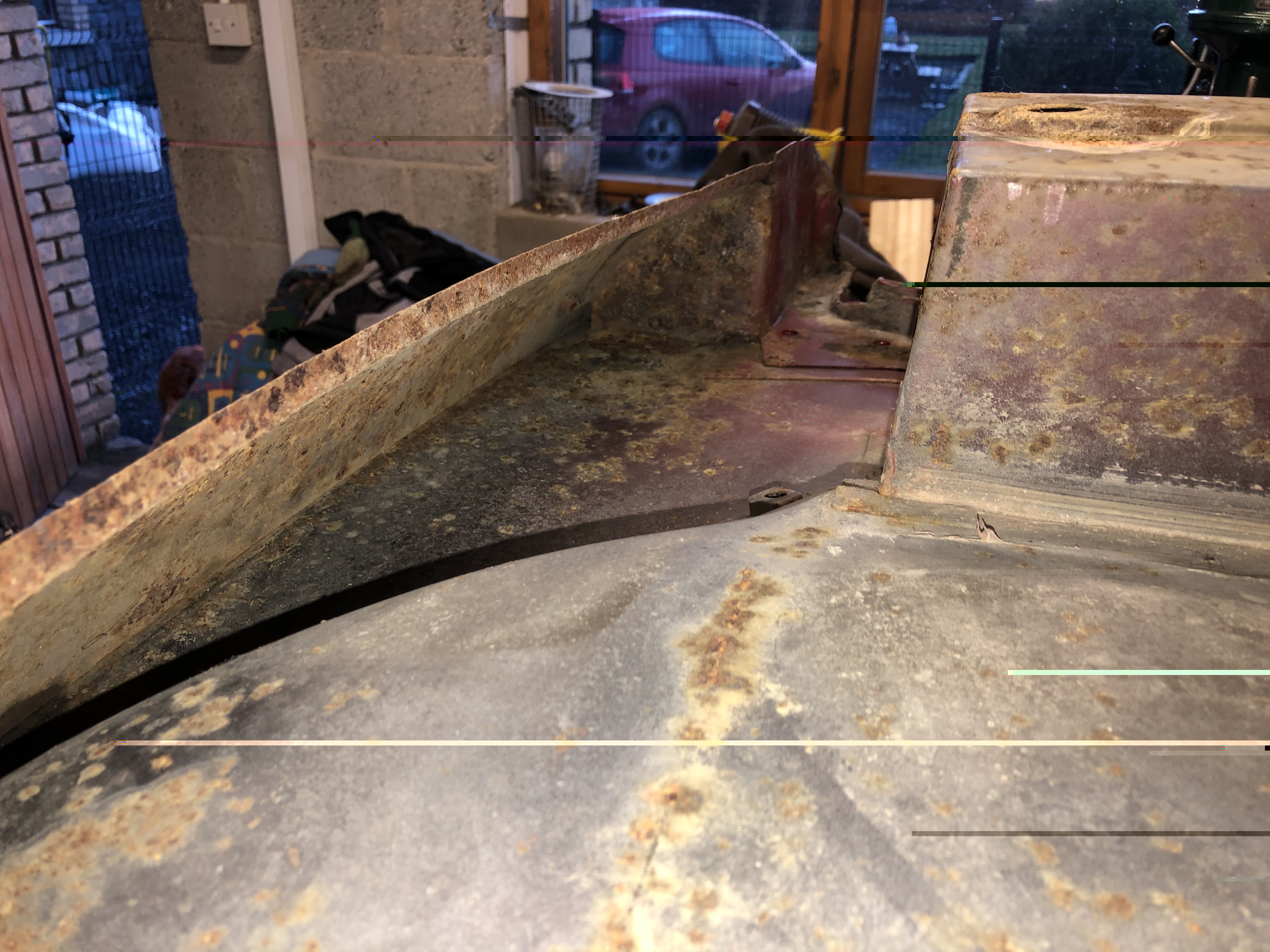

Had a good look at the underneath of the shell. It's in very good condition.
The main damage is around the driver and passenger footwells. Looks like it was badly jacked in the past too.
The rear valence contains mainly surface rust but it's knocked out of shape.
Usual rot under the front wings isn't there.
Both rear subframe mounting points are solid
I think I have a solid enough shell to get cracking on with now.

Rotisserie is looking good! The amount of bits that are rattling inside the shell as you spin it! Anything good fall out??

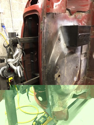

Started removing the battery box via the underneath. This way, at least when I plug weld the new one, the welds will be underneath and not in the boot area.

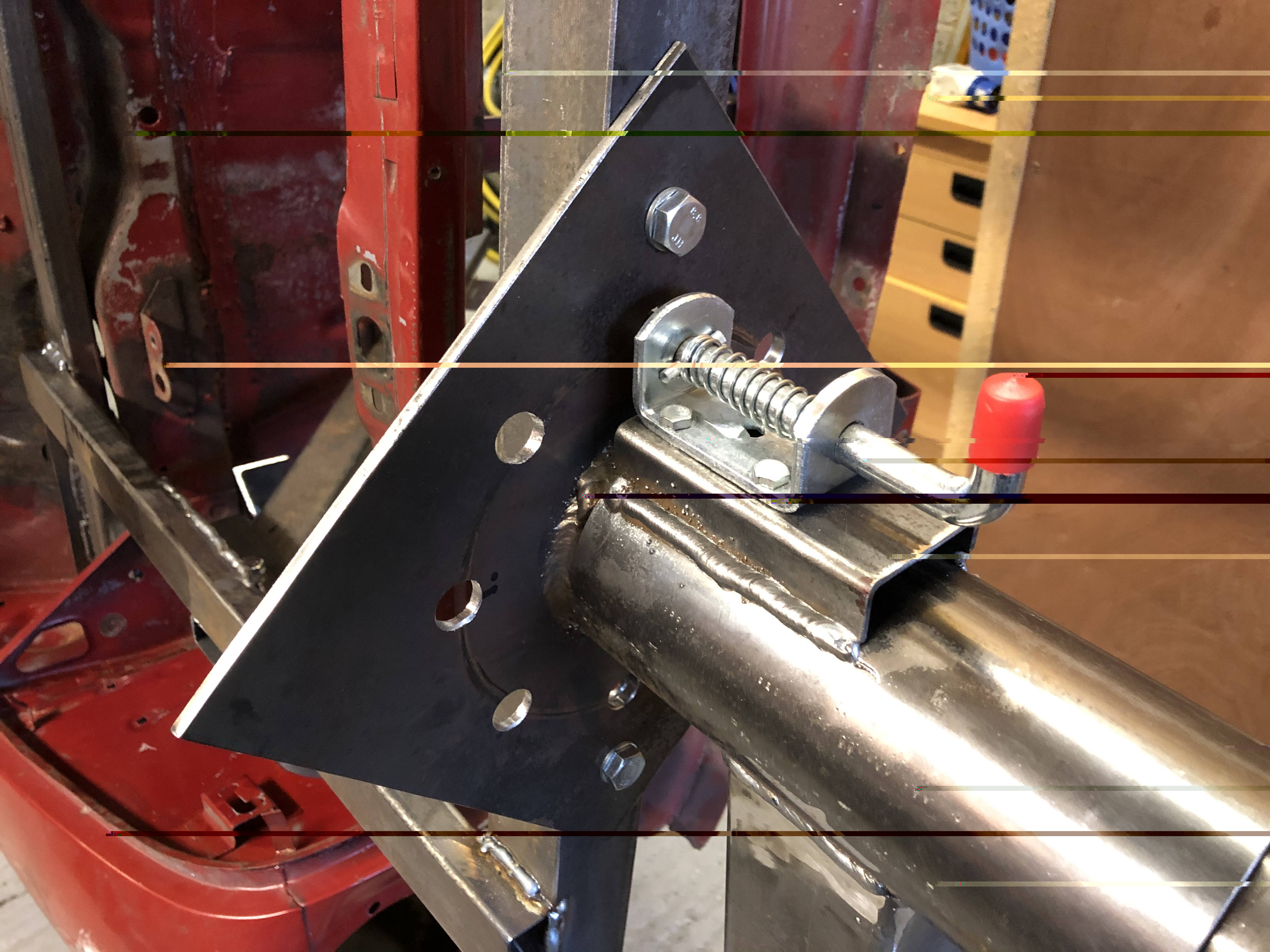

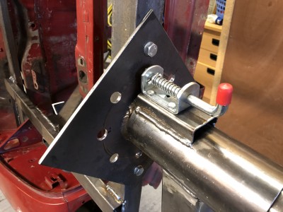

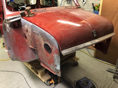

Finally created a locking mechanism for the roll over jig.
A lot safer now.
A lot safer now.
Nice simple solution.

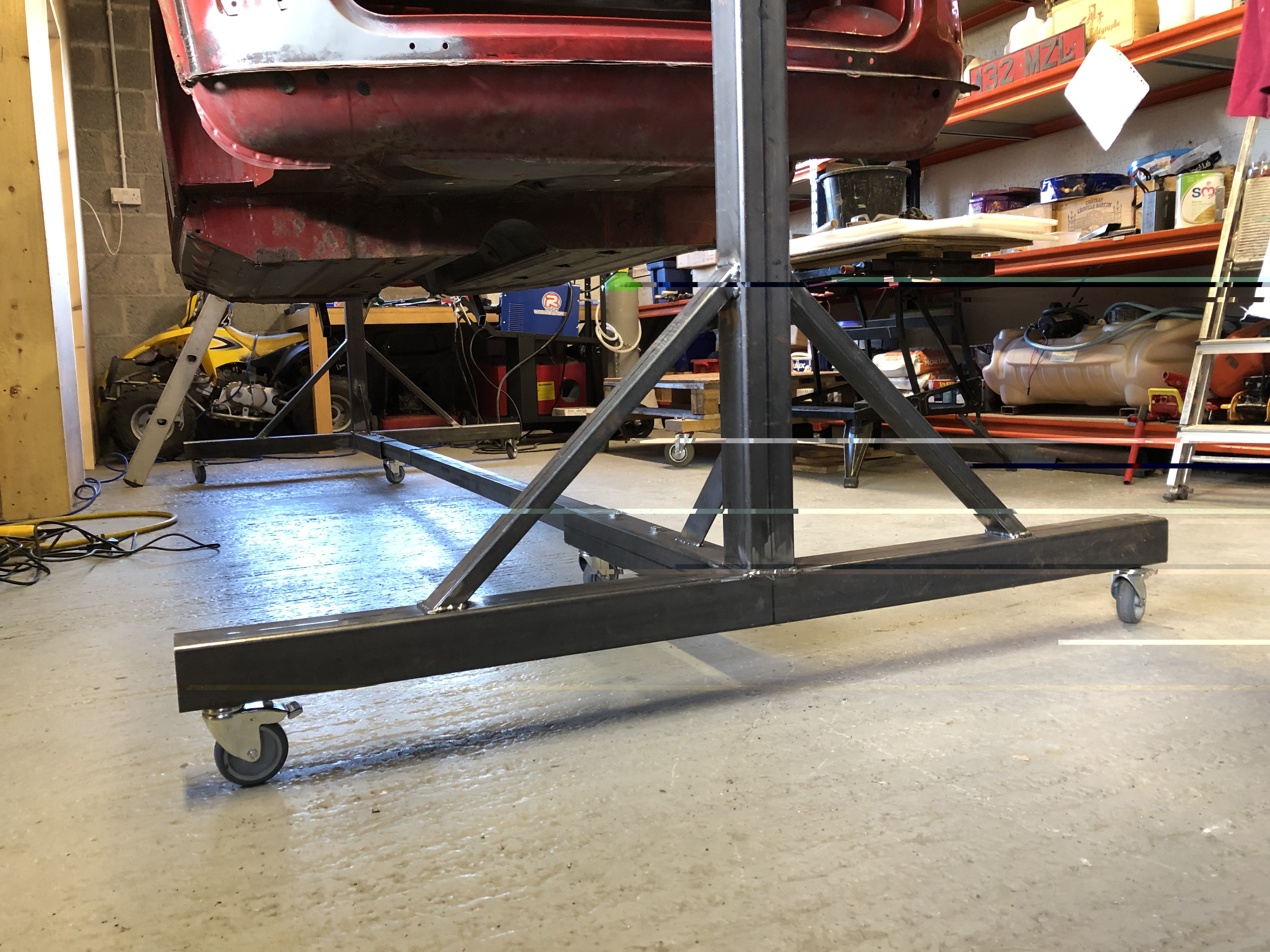

Added castors to the legs and a stabilising bar between the two ends and now it can be moved around the workshop with your little finger. Delighted with the outcome.
Total cost of materials was about €200 plus I learned to weld 2mm - 5mm thicknesses

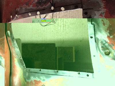

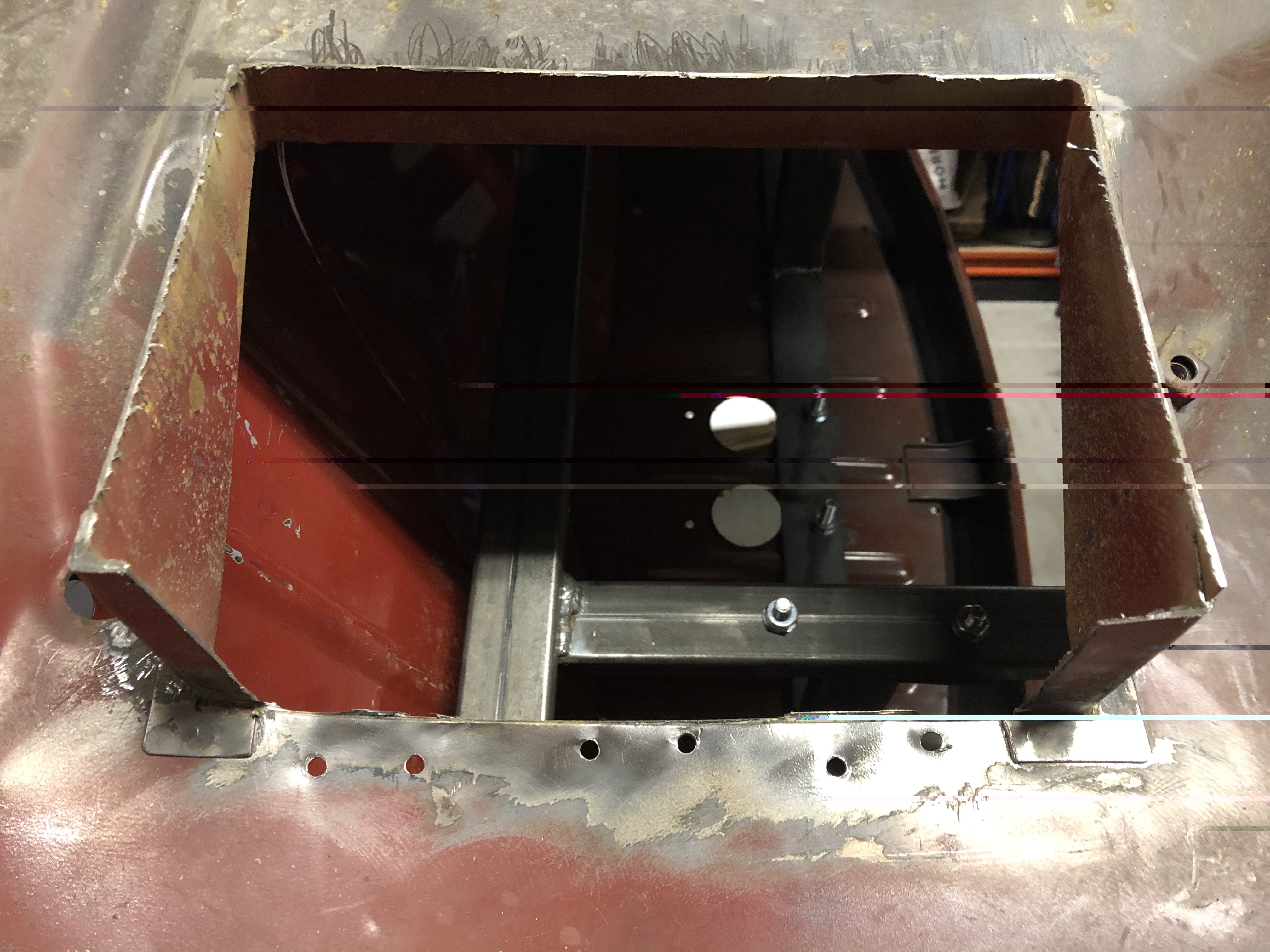

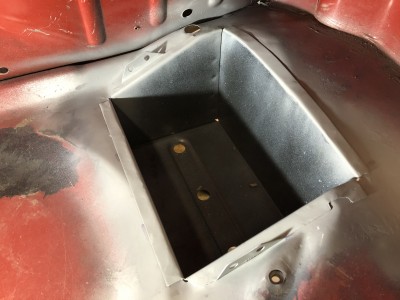

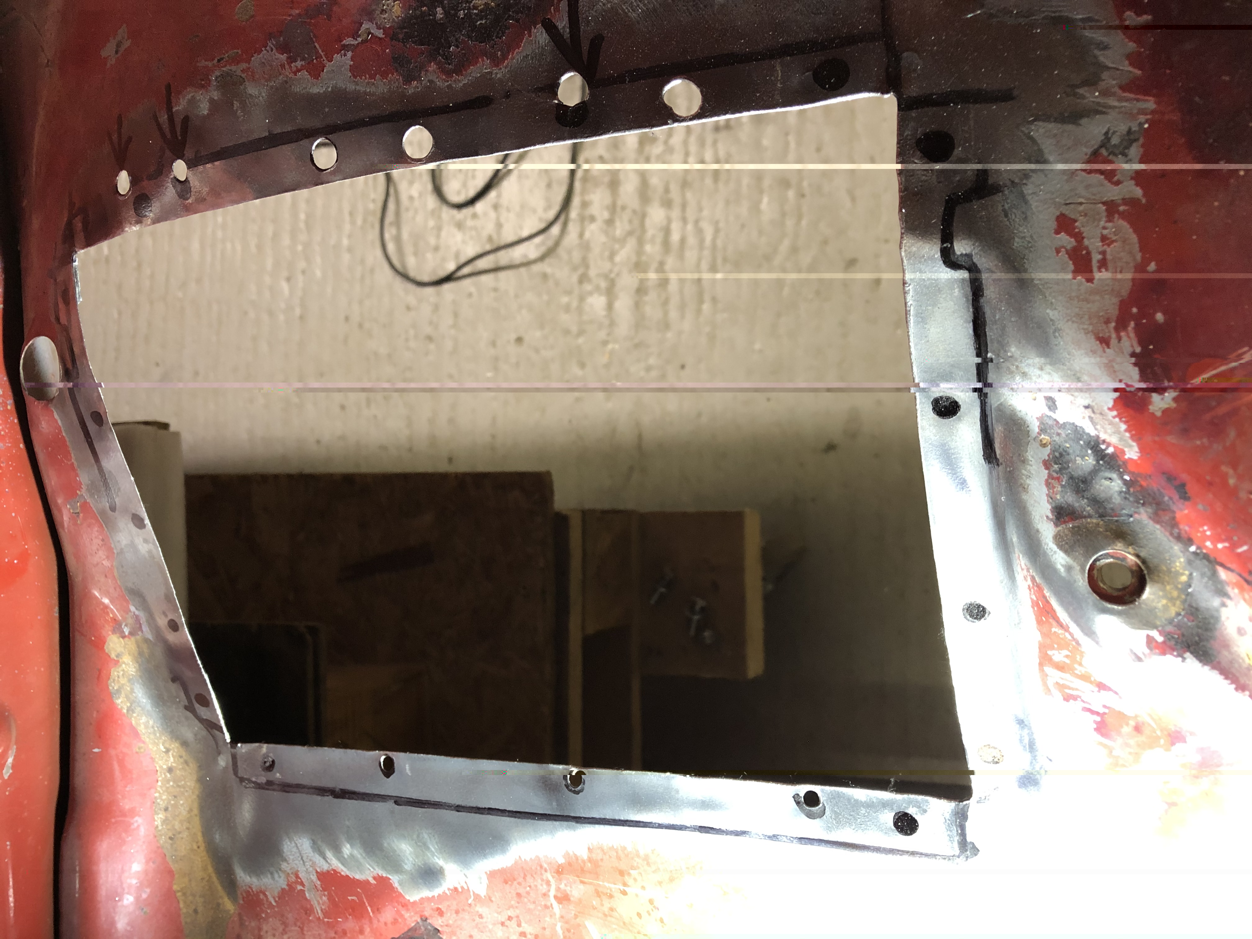

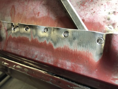

Finally got the battery box spot welds removed. One or two holes to fill but marking out where the plug welds will be made.

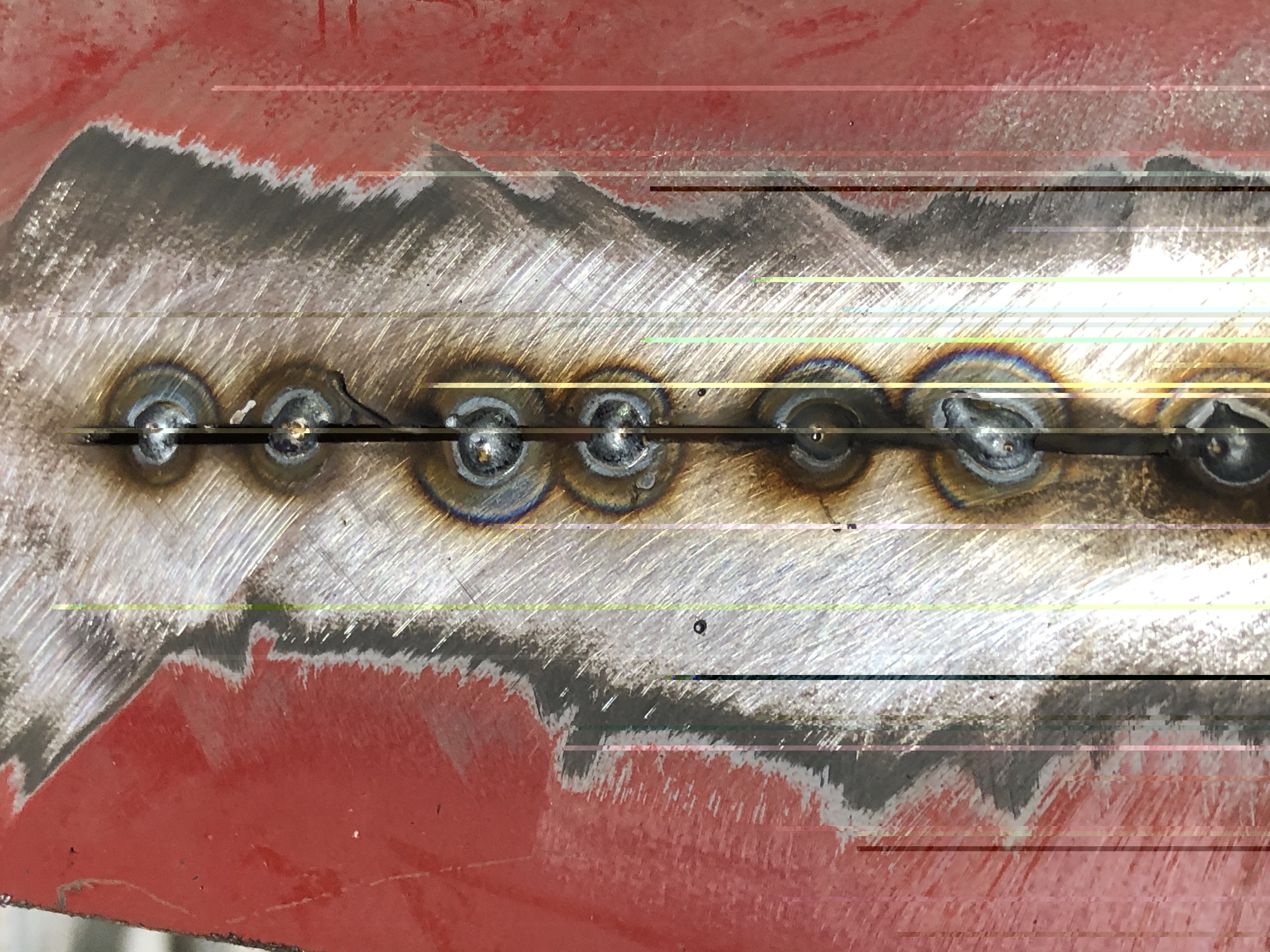

Switched the welder over to 0.6 wire and trying out some butt welding on some off cuts. Very different beast welding 0.8mm steel.
Going to need lots of practice to tune in the correct welder settings. I tried 5mm holes for the plugs but they are too weak. 7mm seems to be rock solid.

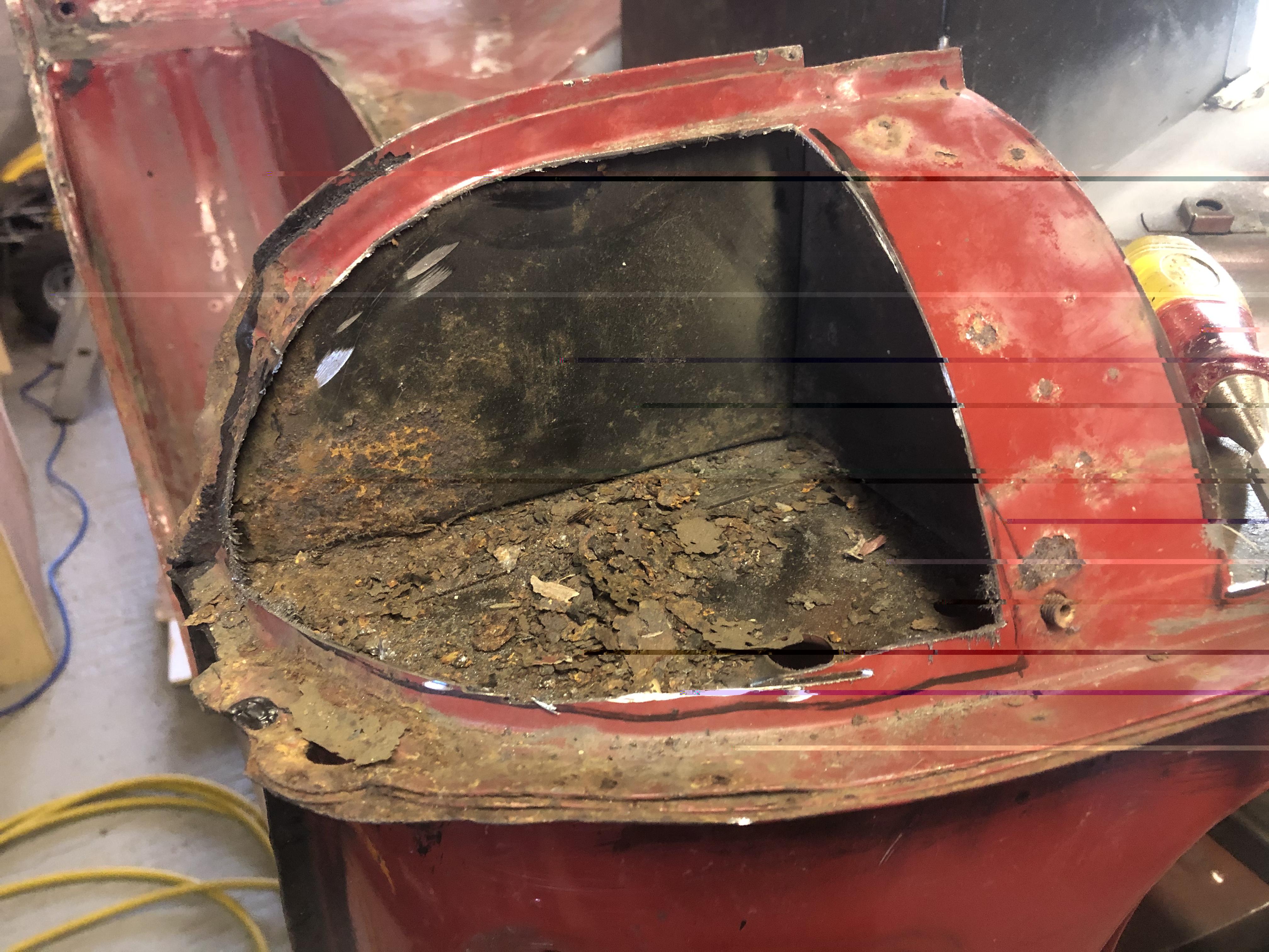

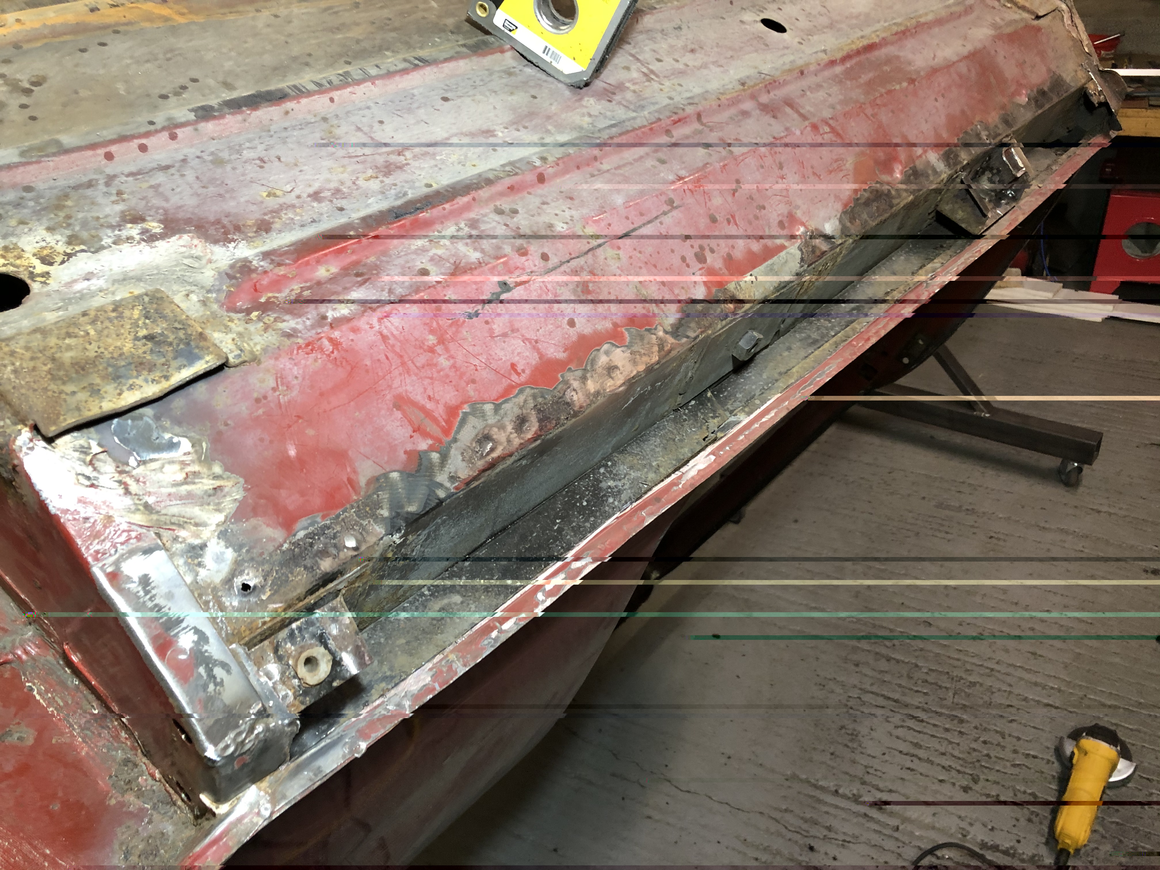

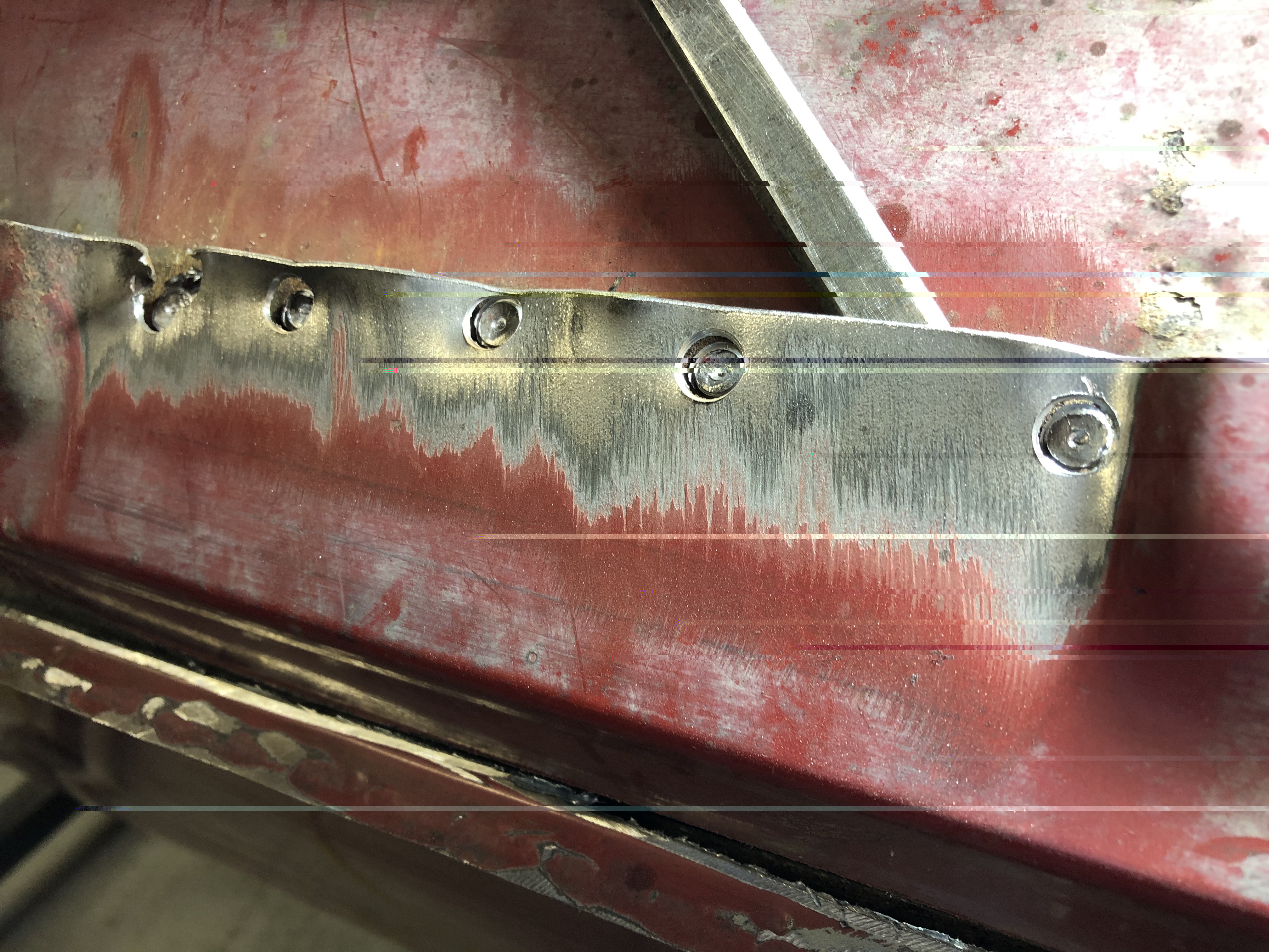

Installed the battery box. Took ages as it was my first attempt at plug welding. Running the welder slightly hotter and getting good penetration. The boot is a difficult space to weld inside
Started removing the old rear valence. Discovered a rusty area on the floor lip. Will cut it out and replace with some new metal. It’s going to be hidden under the valence lip, so a good place to test my butt welding.
Stay safe everyone.
Stay safe everyone.

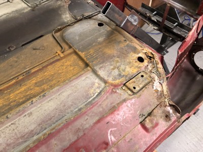

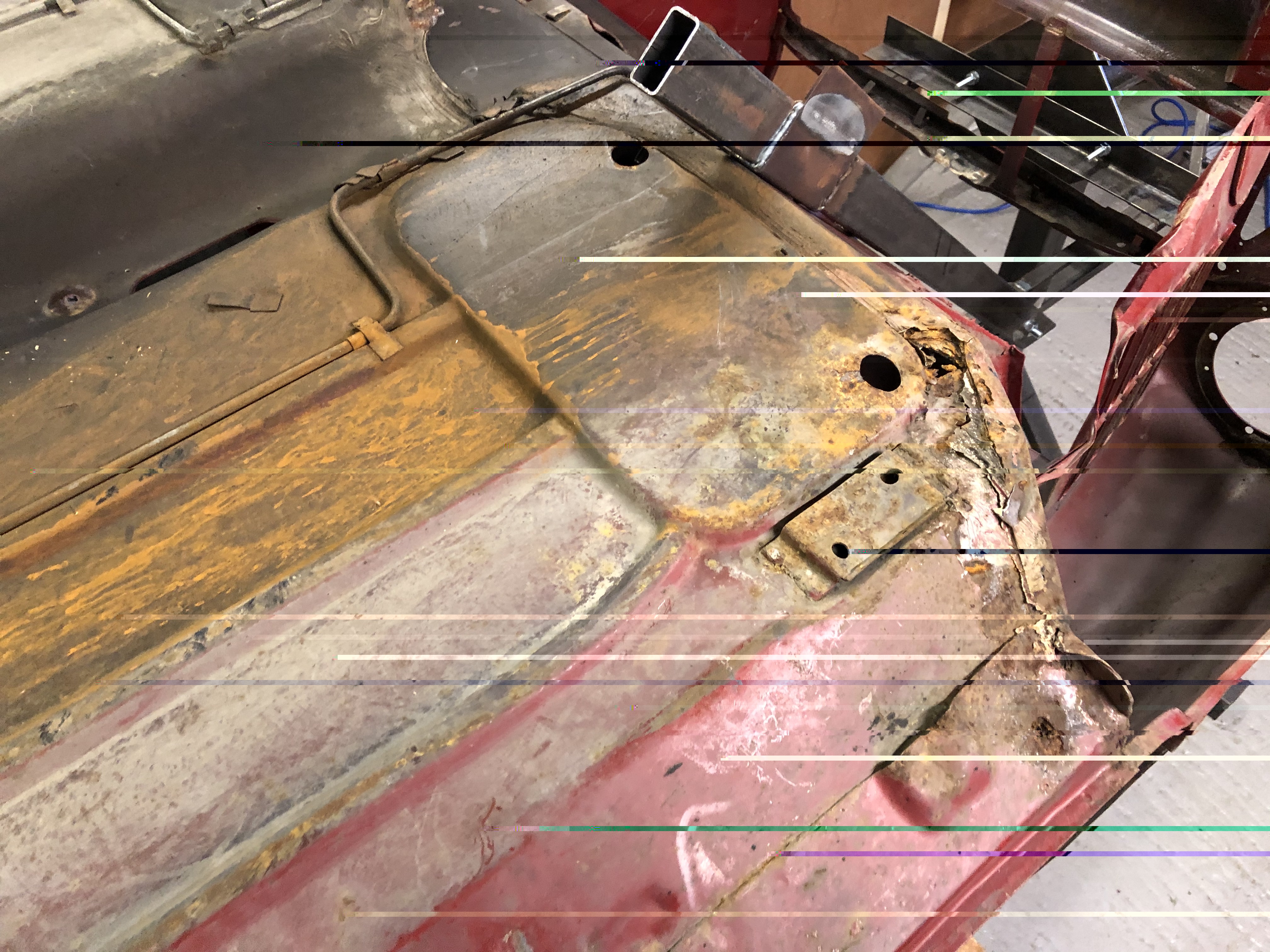

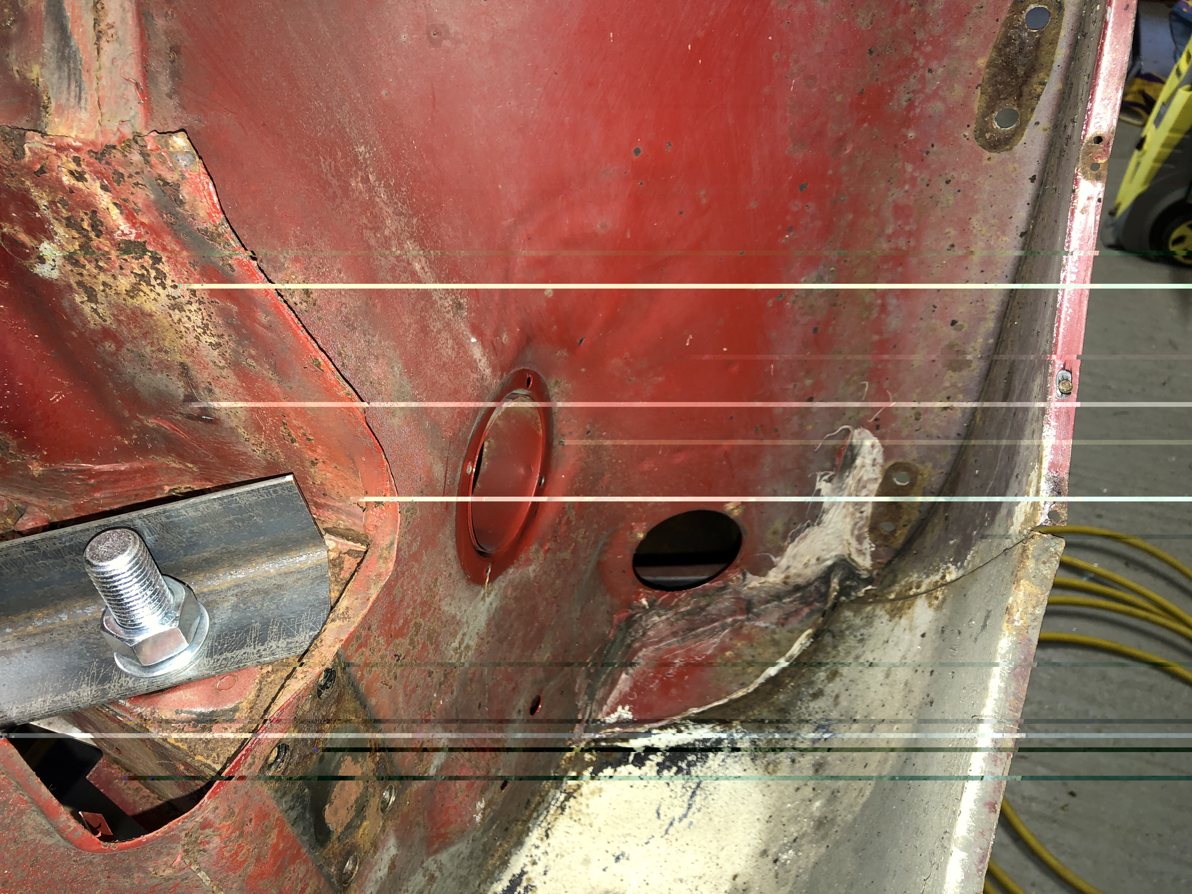

It’s a bit too cold in the garage today but managed to remove the passenger side end of the rear valence
Some additional small areas of the floor to be repaired in the corner.
Lots of hidden rust in these cars. It’s like an iceberg what you see is only 10%

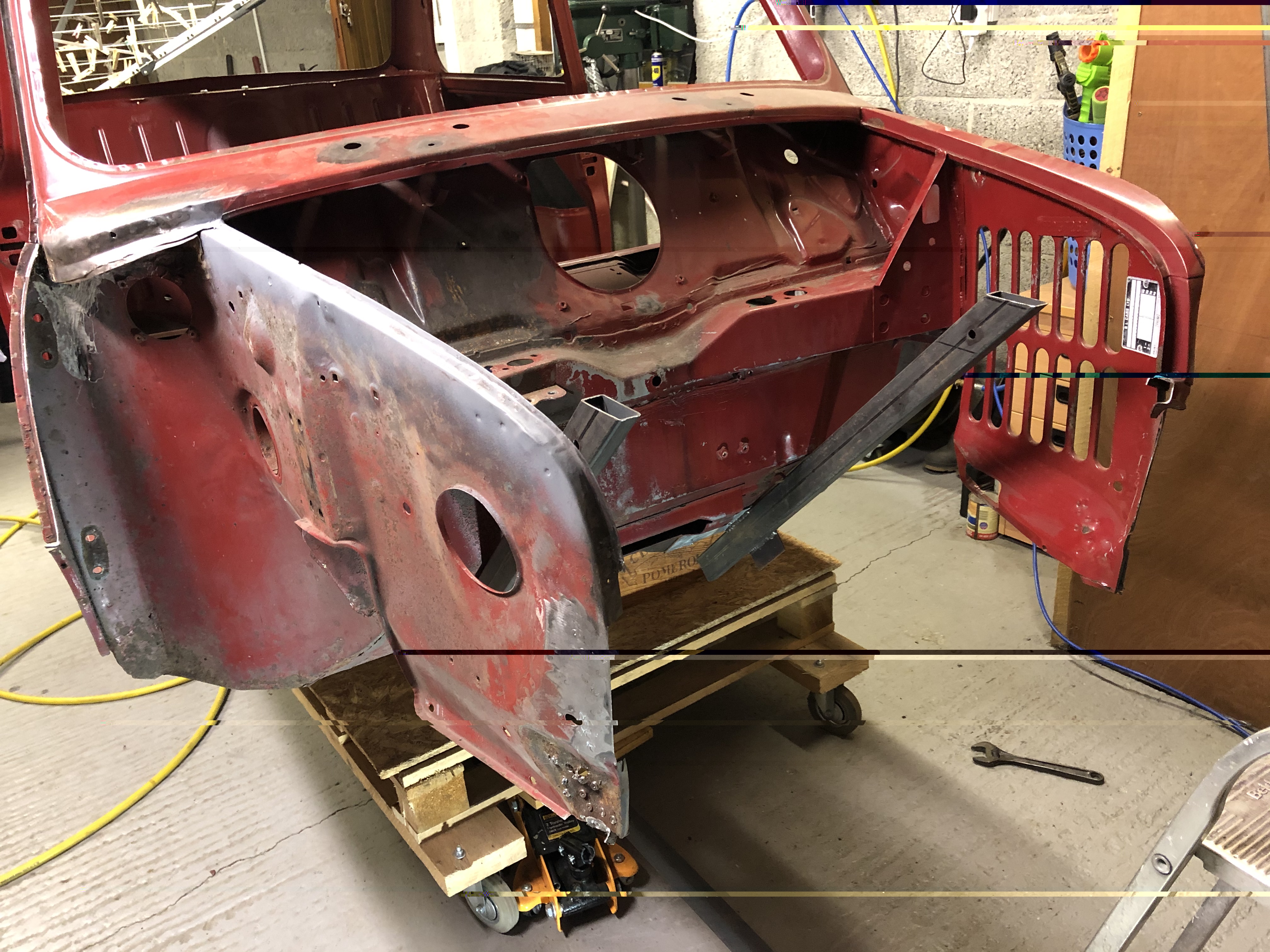

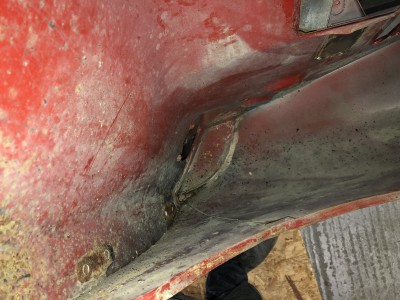

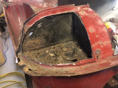

Small amount of old collision damage that I will need to cut out of the inner wing at the bottom. Some brazing had been used to attach the outer wing to the inner one but that has been cleaned up now. Other side is spot welded correctly.
Those inner wings are a weird shape. Hard to determine the original shape.
Managed to order an 8x4 sheet of 1mm from an engineering shop in Portlaoise who will cut it up so it fits in my car.

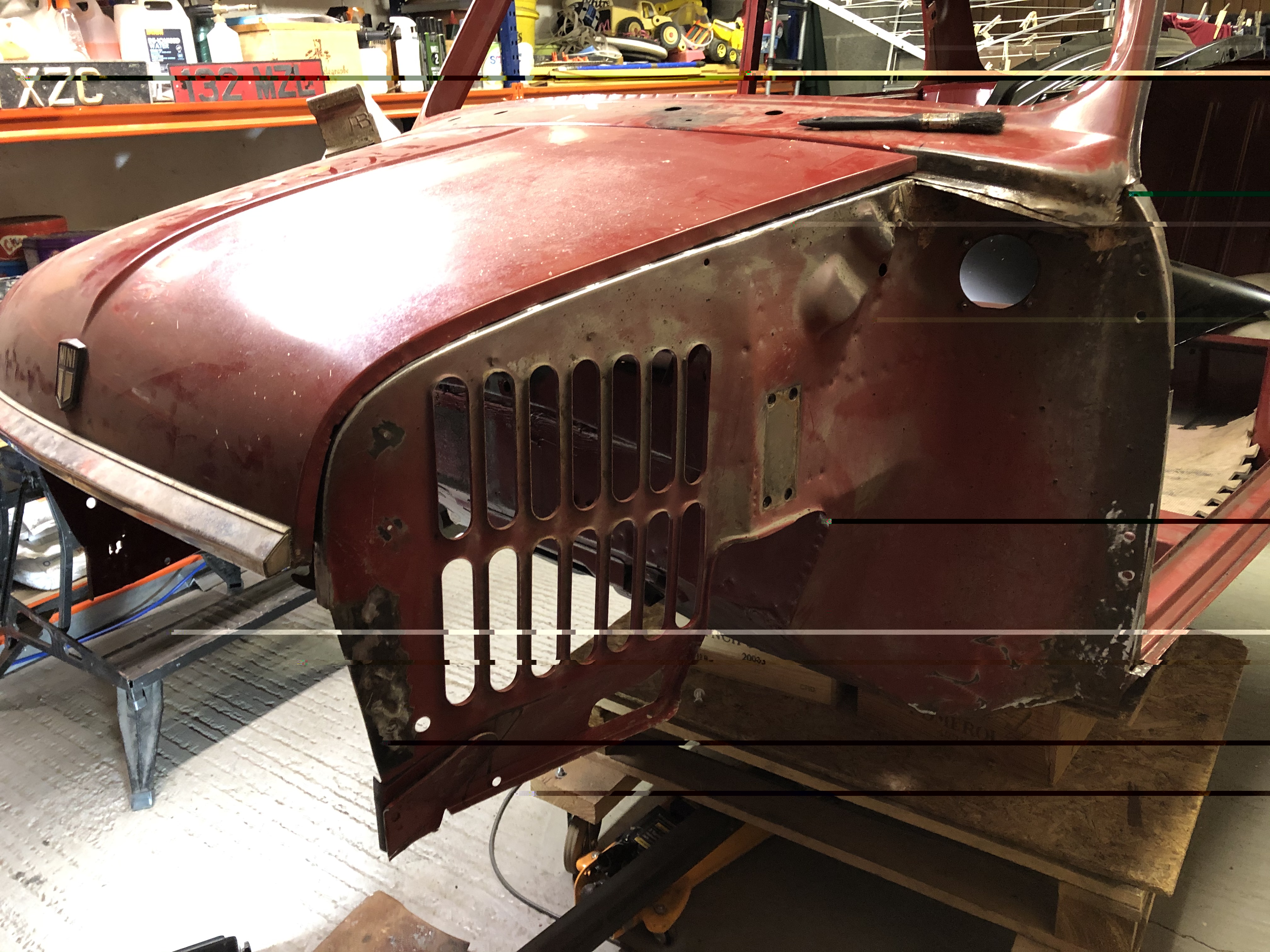

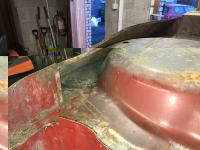

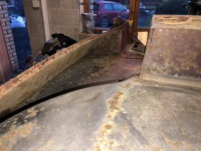

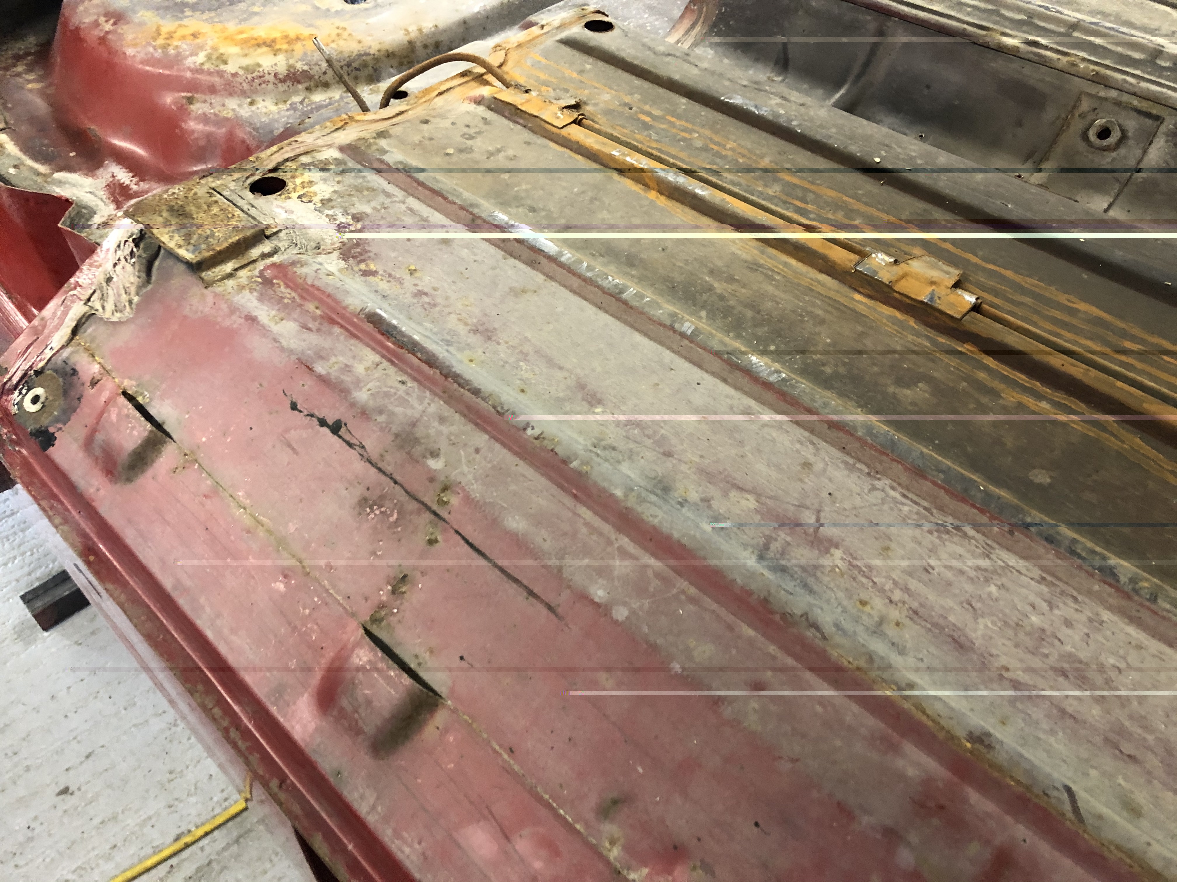

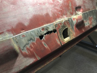

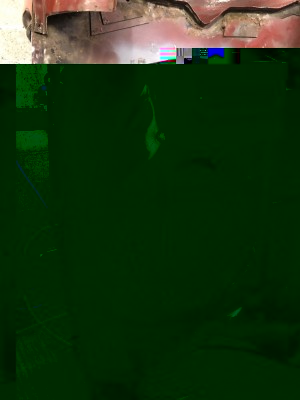

Some metal will need to be cut from the inner panels and replaced with new metal. Too badly damaged to repair.
Surface rust on Outer sills were suspicious and a quick blast with the wire wheel revealed some rust holes. Time to remove them.
Good news is that inside the sill cavity the metal is very good.
The other side door step is not in the same condition but I have a replacement panel for that.
Planning on getting the shell vapour blasted and epoxyed. Opening these cavities will be a great help to protect them long term
