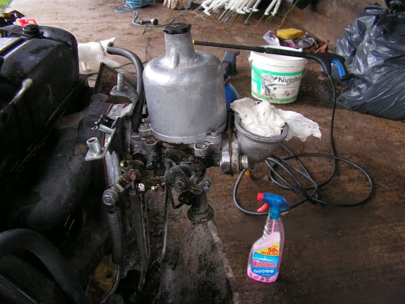

Here is the std carb (?) on my 1L engine

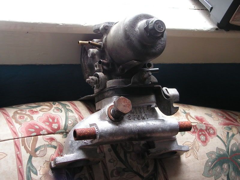

and here is a carb that i got as part of a Stage 1 bundle. Apart from the fact that it says 'mini sport' on it, what is the difference between it and my std one? Oh, and the pipe jobbie at the front?

the "std" carb is an HS4 on the rover cast iron intake/exhaust manifold. the "bundle" carb is an HIF type, with the float chamber intergral to the body of the carb. The "pipe-jobbie" in the picture are the pipes for water heated intake manifold.
you will notice that the "minisport" manifold is intake only, and flows a lot better than the rover part.

which pipes will i put onto the pipes for water heated intake manifold? (pics appreciated.)
Will it be near enough a straight swap? Take off cast iron manifold and carb, put on water heated intake manifold and HIF carb?
Will i put the funnel (air intake) onto the newer unit, or is there some sort of k&n filter i can get?

take a look at this photo:
http://www.iol.ie/~home/mini/image/998-engine-bay.jpg
i have fed the heated manifold by plumbing it inline with the heater supply pipe: note that when you turn off the hot water to the heater, that also stops the intake manifold being heated. I figure that if i dont need heat neither does the manifold!
to use this intake manifold you *need* to have a separate exhaust ( http://www.maniflow.co.uk/images/new_ma ... _2_lcb.jpg ) manifold. your alloy intake manifold is *not* a straight swap for the standard rover part, as the factory item ( http://www.minimania.com/images/stockman.jpg ) is both an intake and and exhaust manifold.
changes need to be made to the exhaust sytem as well. read up on "stage one kit"

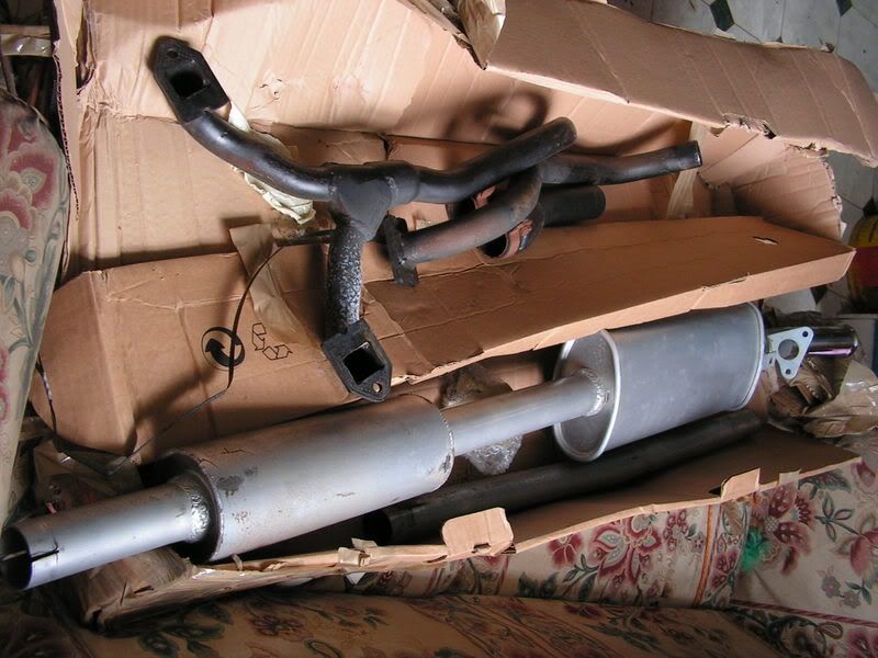

Yeah, i think this is the rest of the stg 1 kit...
http://i9.photobucket.com/albums/a90/Ro ... CT0057.jpg
Separate exhaust bits everywhere :) and its a centre exit exhaust.
Do i need anything else to complete the stage 1 kit, or is that it? What about the air filter, is the std 1 good enough, or is there a k&N style/other recommened. this engine is a 1L.

Ok, it looks like you have the inlet and exhaust manifolds and exhaust system. Stage 1 kits either come with a K&N type air filter that replaces the original filter housing (cone type or cylinder type), or a K&N type replacement filter than fits inside the original filter housing, a replacement carb needle, gaskets and the exhaust mounting kit. Check out what is on offer from the likes of Mini Sport or Minispares
