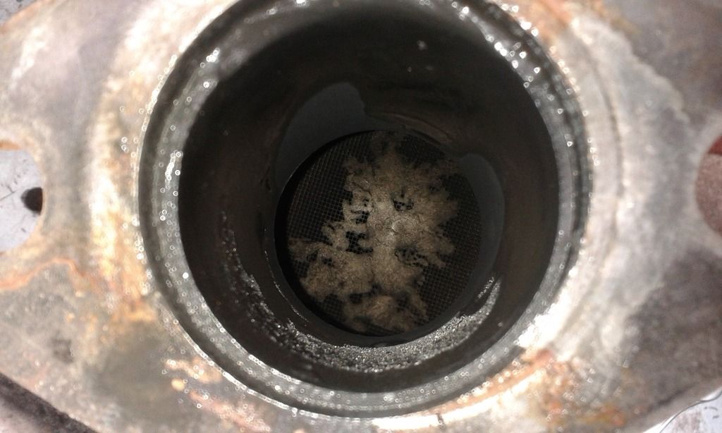

I'll kick this off. I was trialling some new injectors in the hope that they would give me a genuine 90Bhp MPi but as you can see it didn't quite attain that level, beat that torque though!
And here's the reason why it started to tail off at 4000rpm.
So I've fitted a less restricted cat :wink: and I've calculated that based on those readings it should hit 90 at around 5700 rpm so I'll head back down one of the days to try again.

Is that a photo of inside the cat, Dylan?

It is Billy, only 3 months old, my refurbished cooper head was seeping oil between the new guides and the casting, all sealed up now though.
