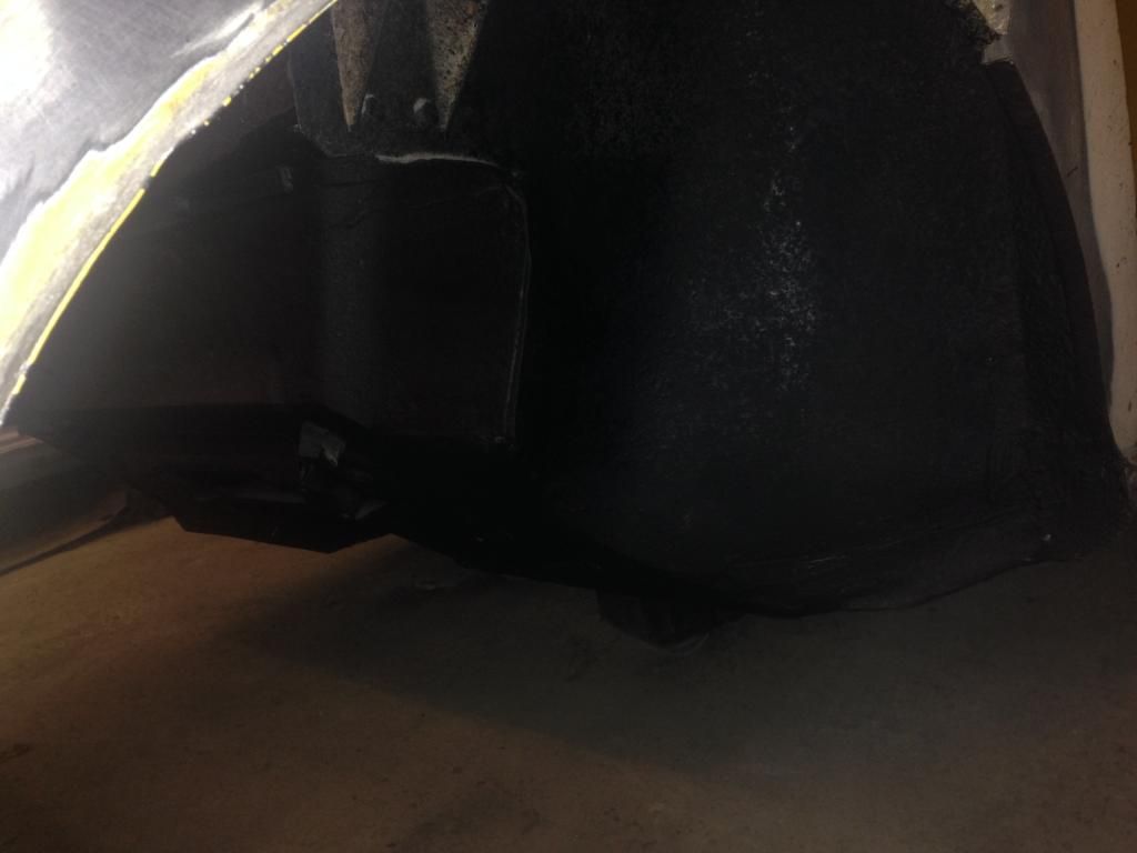

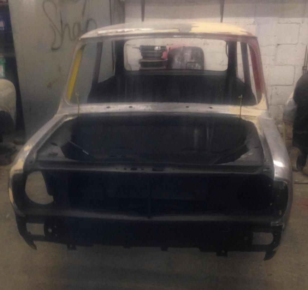

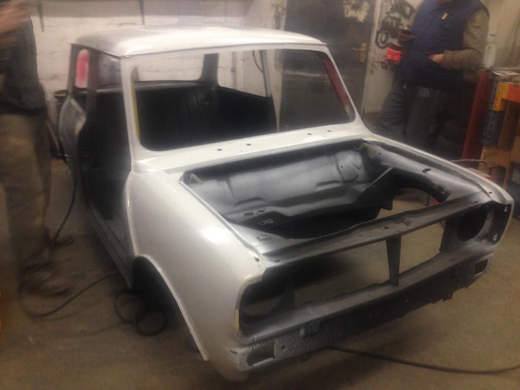

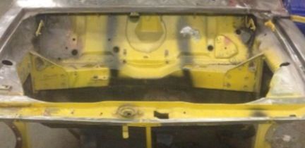

Got at it tonight :) more spent but it's coming along and taking shape
Before
After

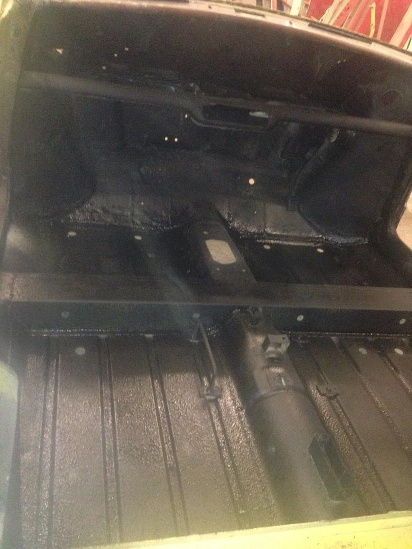

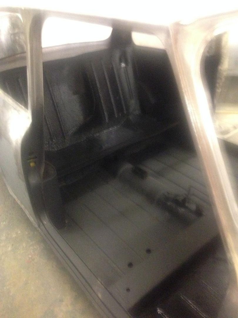

Gonna do the last if the sanding on the front tomoro!!! Shultz the rear seats and under of the car! Then shell will be primed tomoro night! Then wedsnday block sanded and primed again and sanded then 3rd coat of primer then :) put it together and take it apart and paint the bad boy :)
More updates tomoro evening and hopefully will be fully primed and ready for paint Thursday :) woo

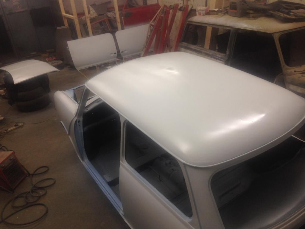

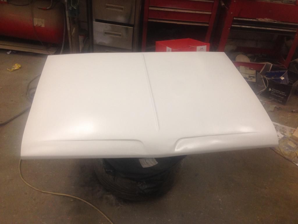

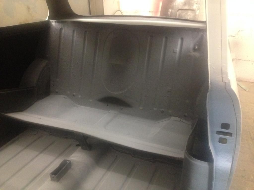

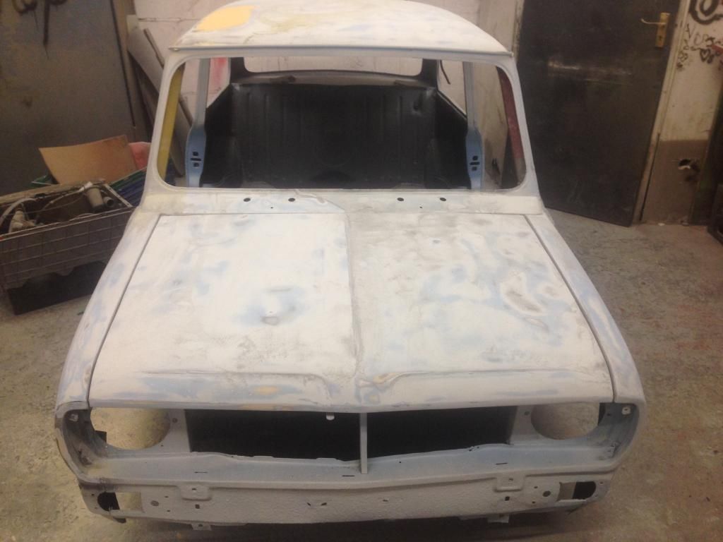

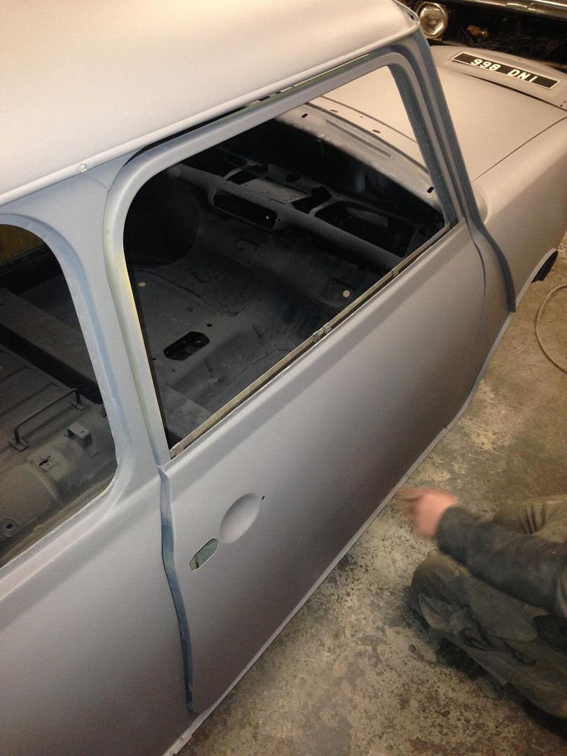

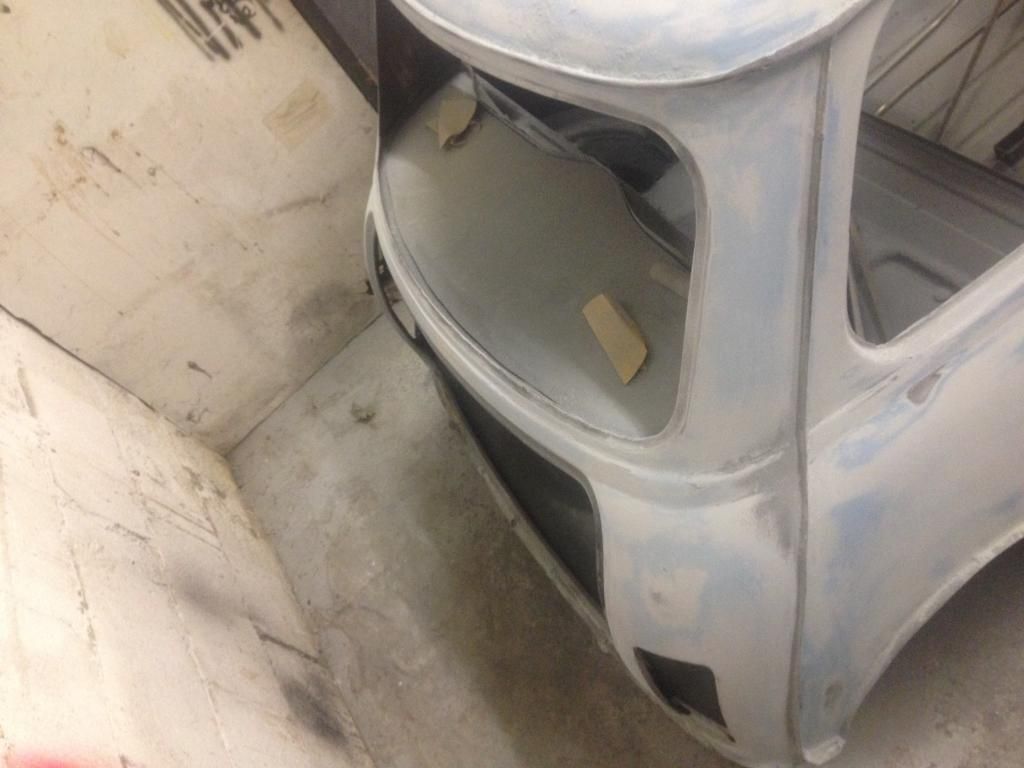

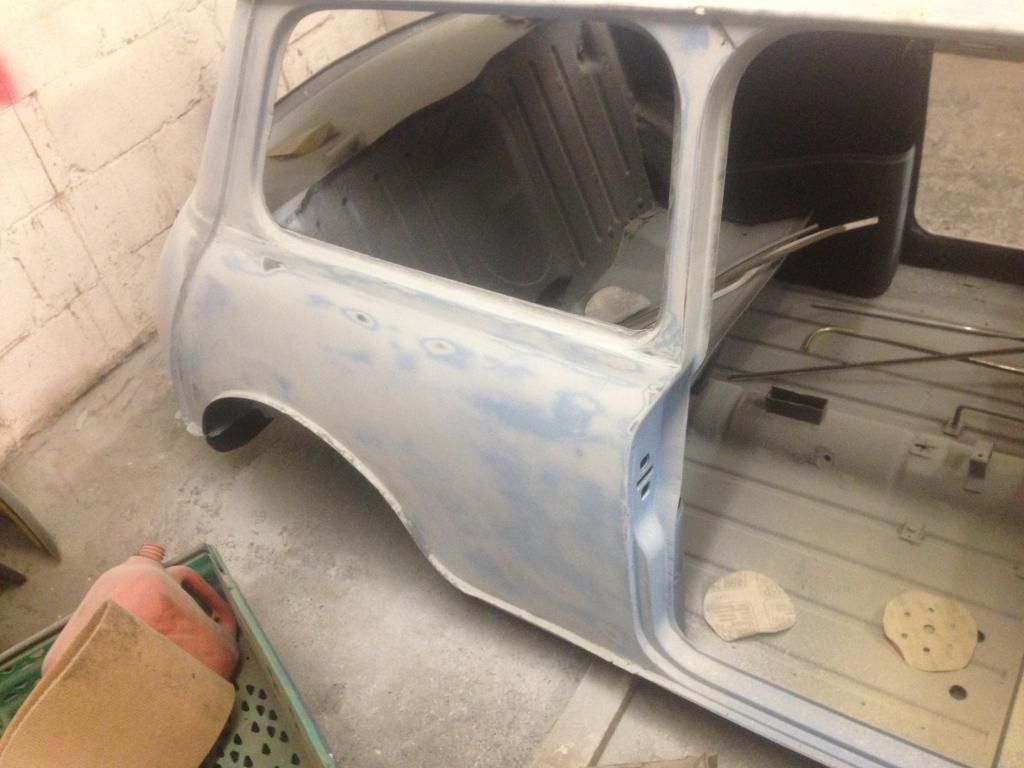

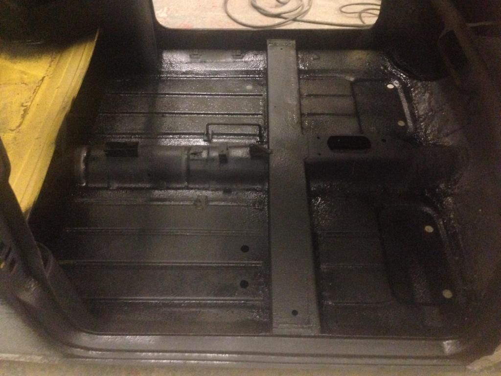

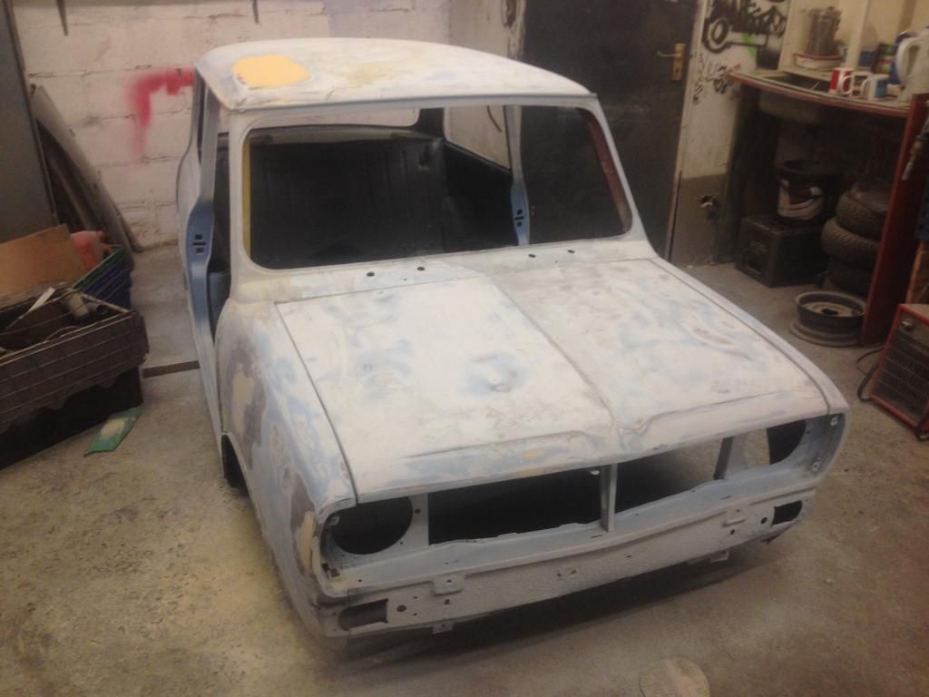

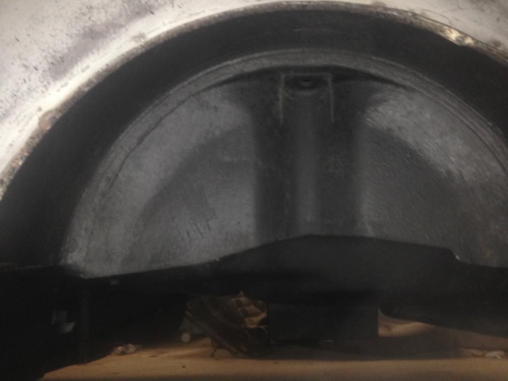

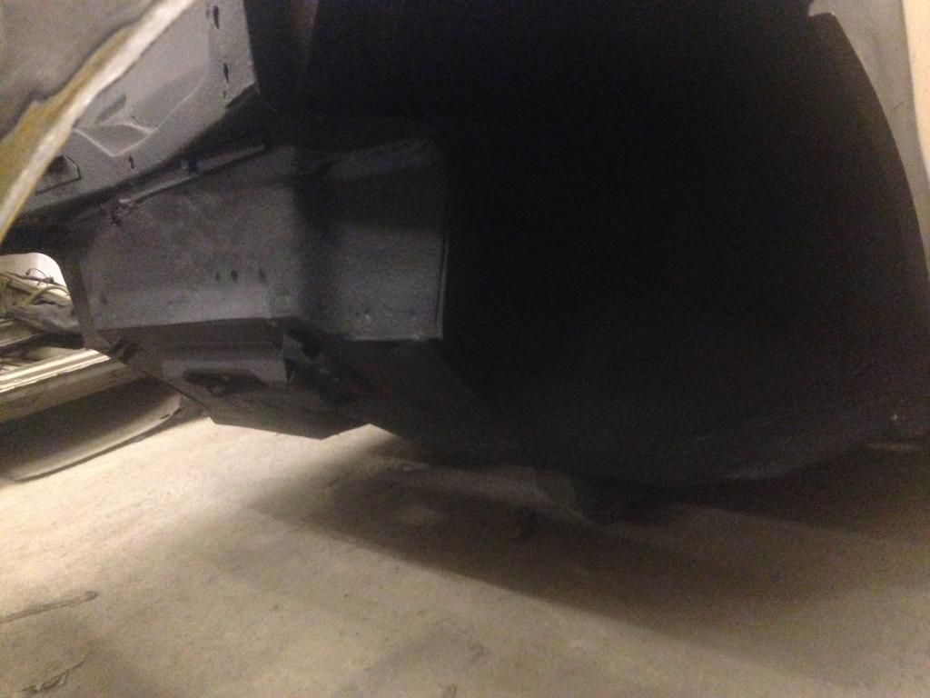

Got more done tonight!!! Loads to do tomoro :/ few pics of how it's going

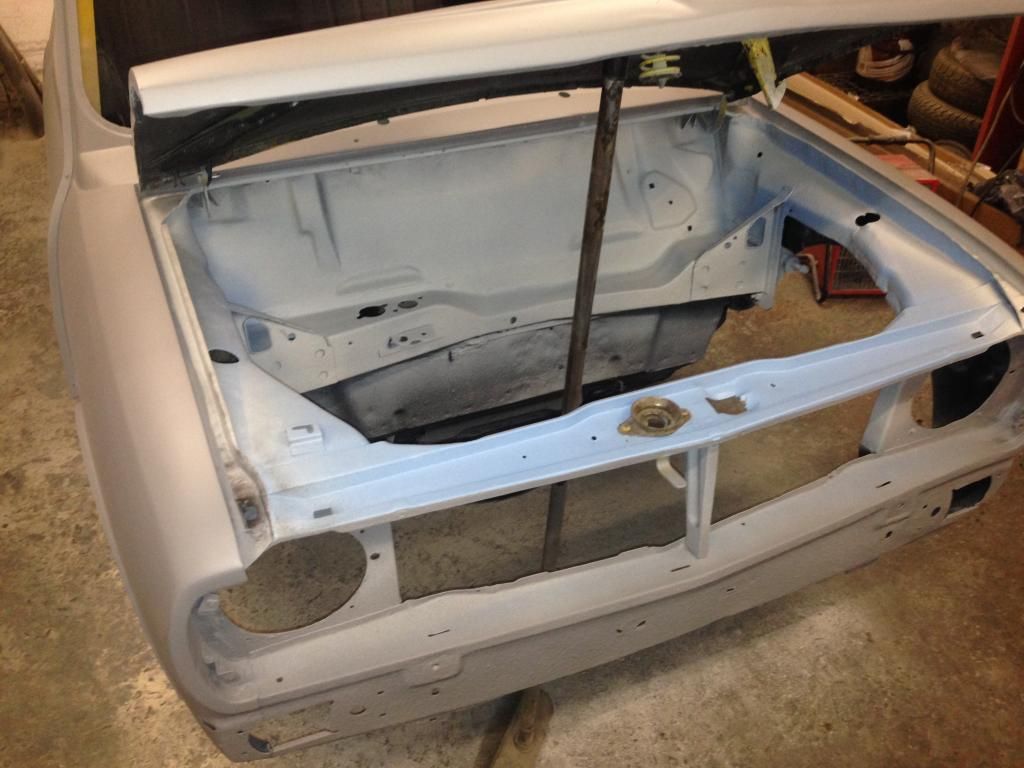

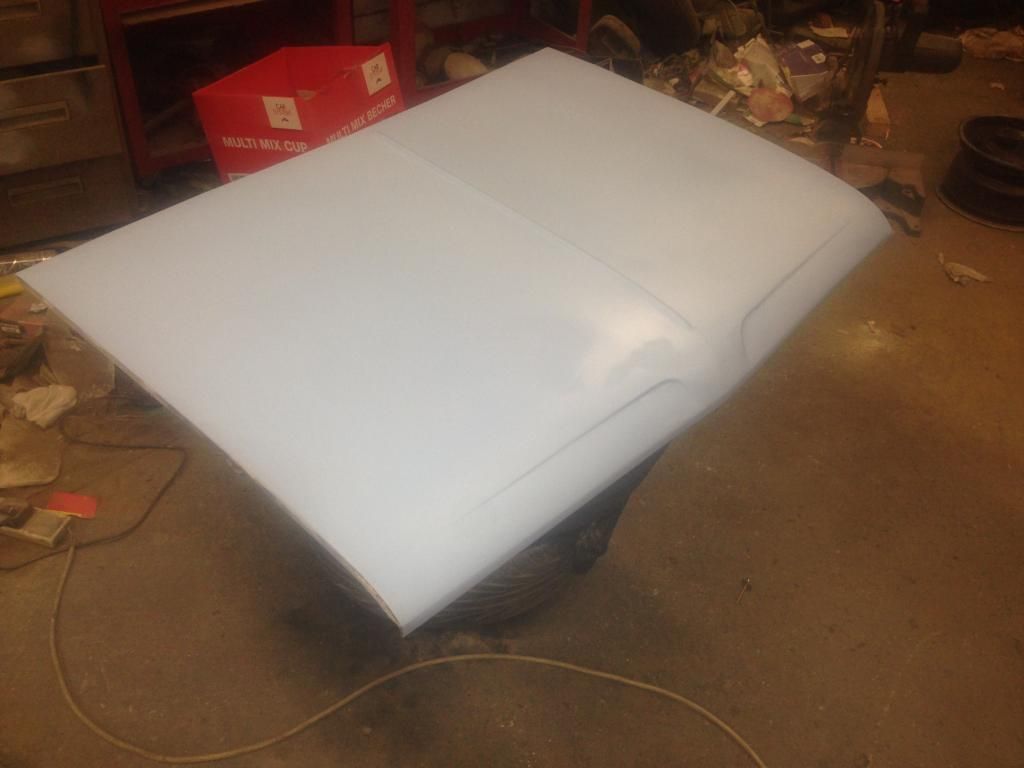

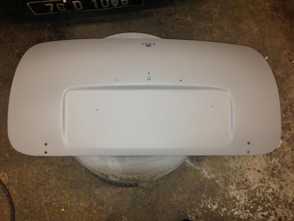

Bit more work to do :) first stage of primer now to rub and block it down!!! Then filler and rub and block it down again!!! Then prime it for last time then wet sand it with 2000 :) then ready for paint
The worst but was this mark on the wing :) but that's all :) rest of the car is immaculate I'm so happy with how it's looking ;) door are so straight :) all I need is a good bootlid and it'll be complete :)

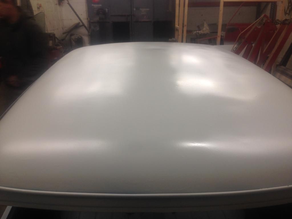

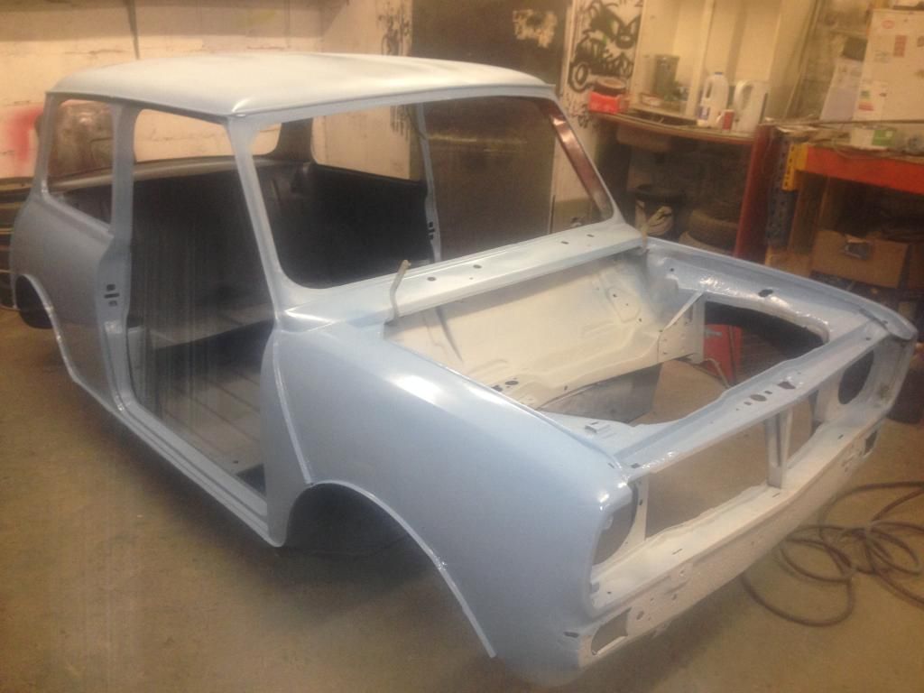

So good but done last night :) ca is 99% ready for paint :) just few coats of primer and wet sand with 400/600 sandpaper :) body is smooth! No dents no damage :) it's all fixed :)

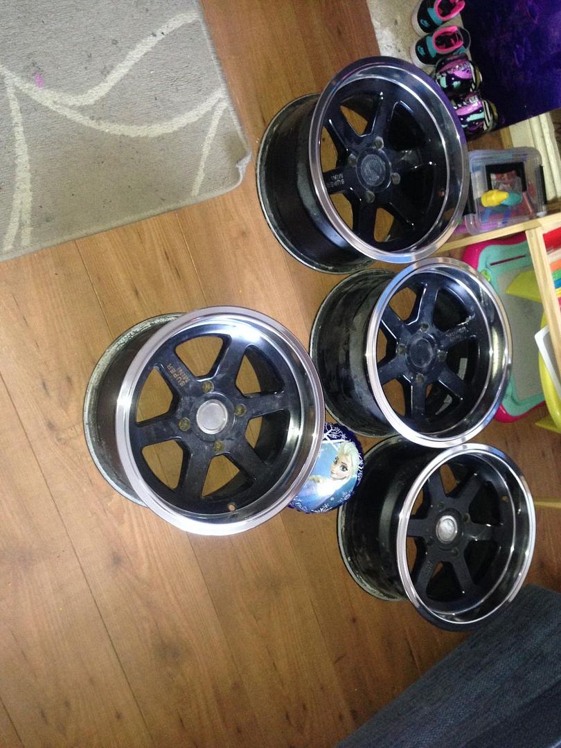

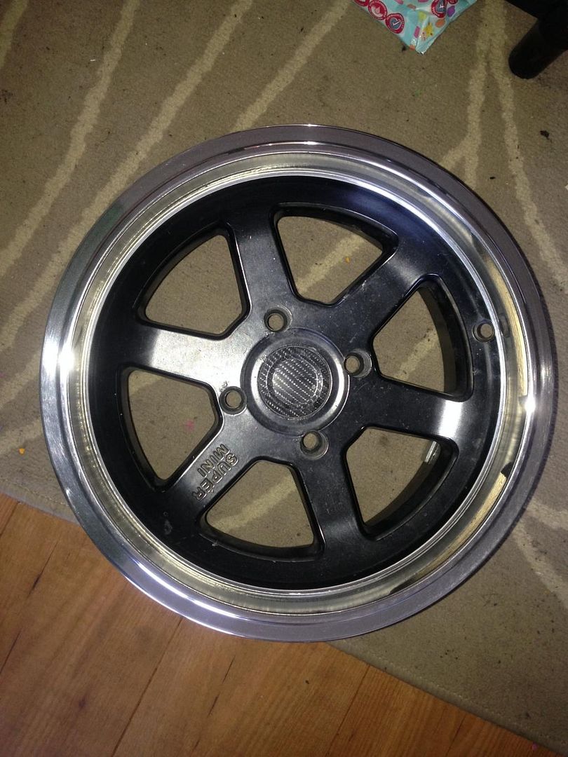

Wheels send off to get blasted and polished lip :) centres are being sprayed hopefully nxt week :)
New tires came yesturday so when I get wheels back they can be fitted :) then I can drive the vtec to garage and rip it apart after the other ones sprayed :) could be finished a lot sooner than I thought ;) so I'm very happy , few pics I got last night :)

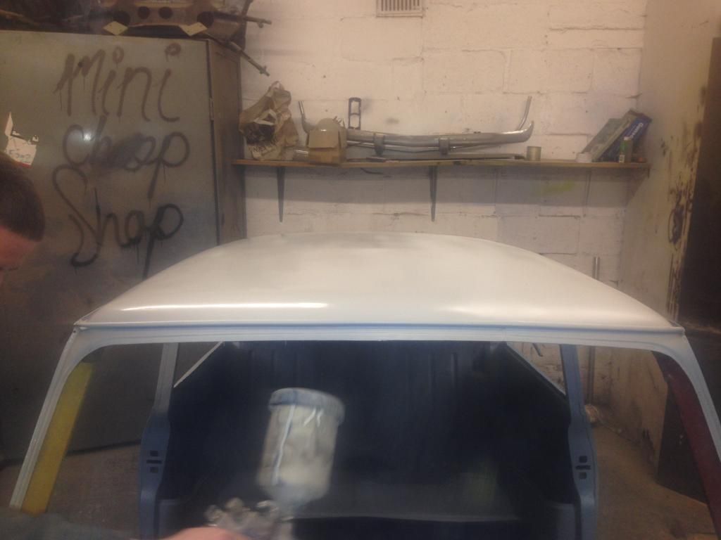

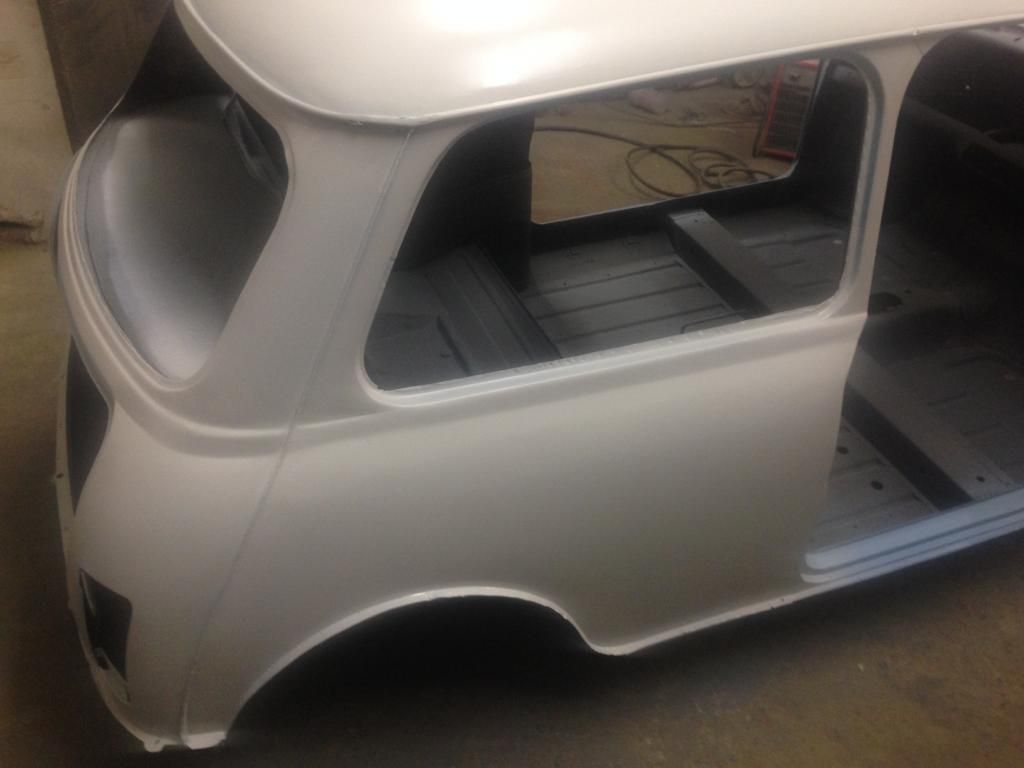

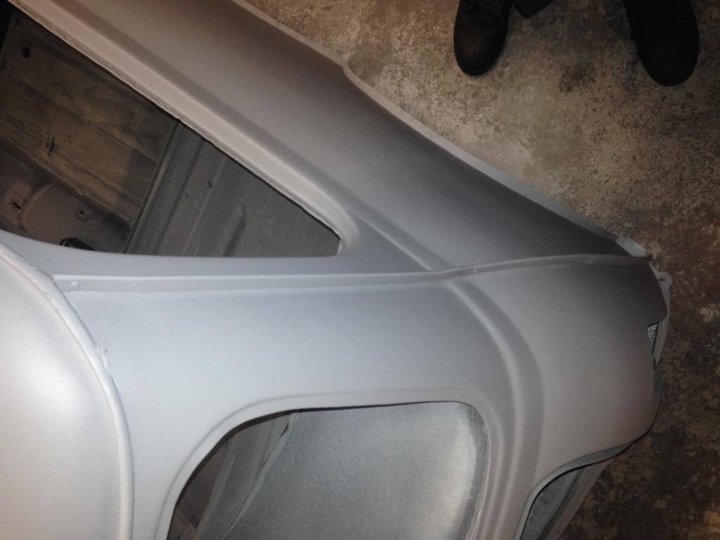

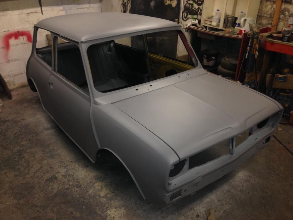

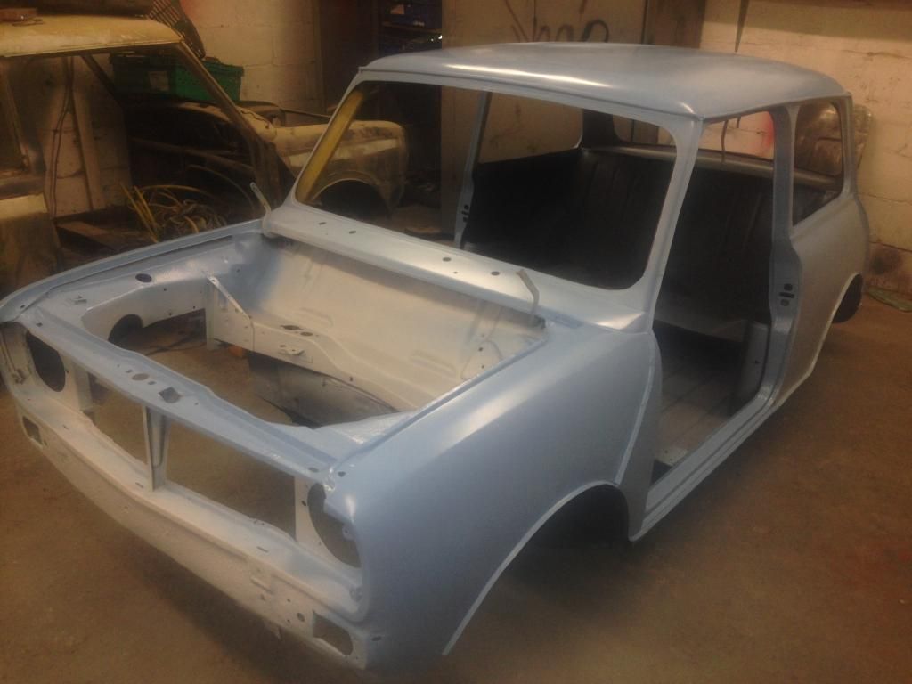

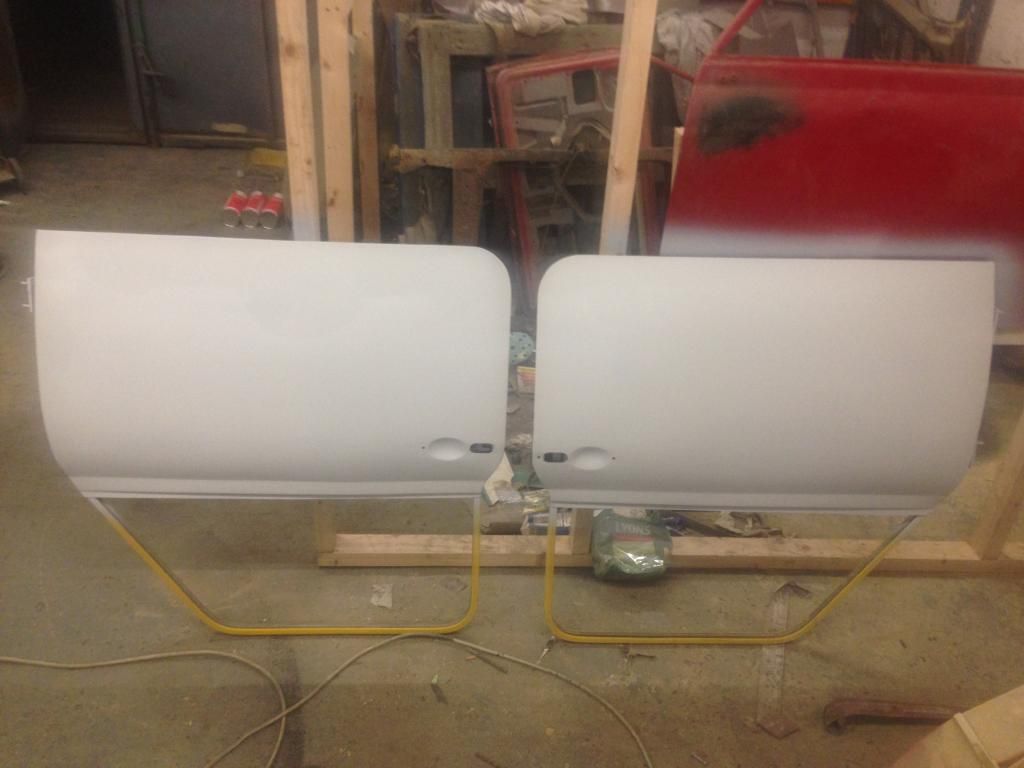

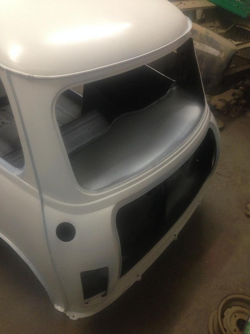

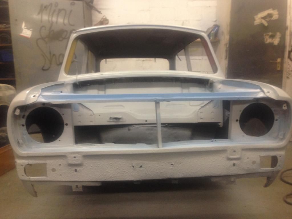

So my bro went to garage yesturday and got the car fully primed up! Jus gotta be wet sanded and she's 100% ready for paint :) few pictures I got on way to work
As u can see , a rediculous amount of time and effort has gone into the body work :) as we have everything else there for it so! Hopefully will be fully painted and dry for Monday so we can put it together! Then send few bits an pieces off to get modified! Then get it running :) getting there

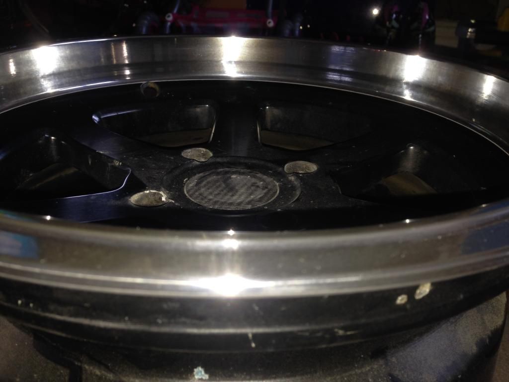

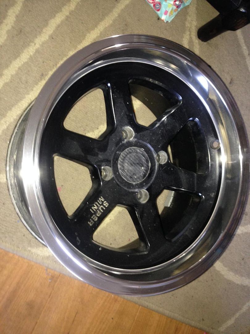

Also went and got these done today :)
Wen I got em
Cleaned em and got polished lip
Tires fitted :) ready for burnouts :)

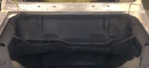

Comming along nicely. Don't know what your interior plans are but normaly you would paint the inside of A and B posts ,crossmember and rear bins the same as outside.
Re: Clubman shell rebuild for vtec
Yep the bins are black a + b post are going Colour :) hopefully paint Monday evening then partially assemble Tuesday :)

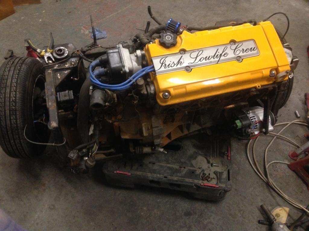

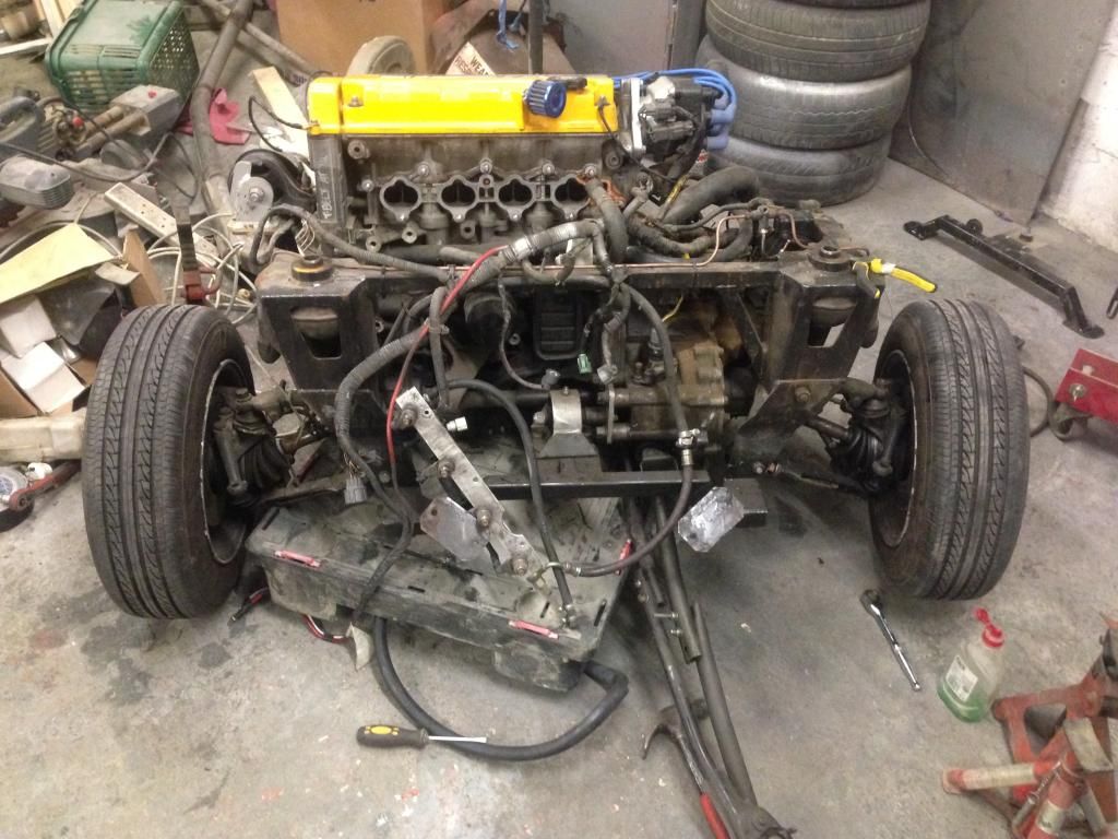

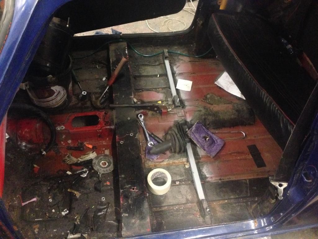

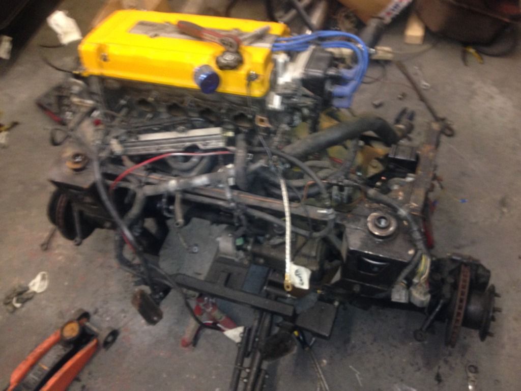

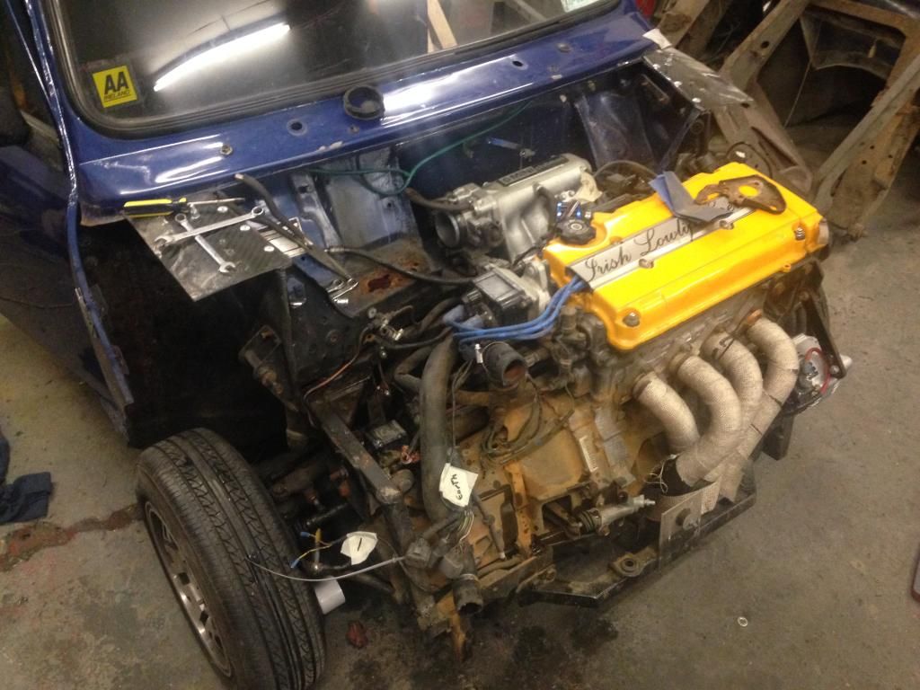

Loads done over the past few days!!! Car is painted! Roof lining in new windows fitted and taken bk out to trim roof liner ;) looks good but no pics!!! Ripped loom from blue one and in the other :) so loads of bits an bobs ready to go in!!! Engine is all apart and nearly ready to go in :) hers few pics
Only tower bolts holding in! Everything else is disconnected
Interior gutted! Seats out! Got new carpet coz red won't go with wat iv got, steering colum being rebuilt, have pedals in new car already :) getting there

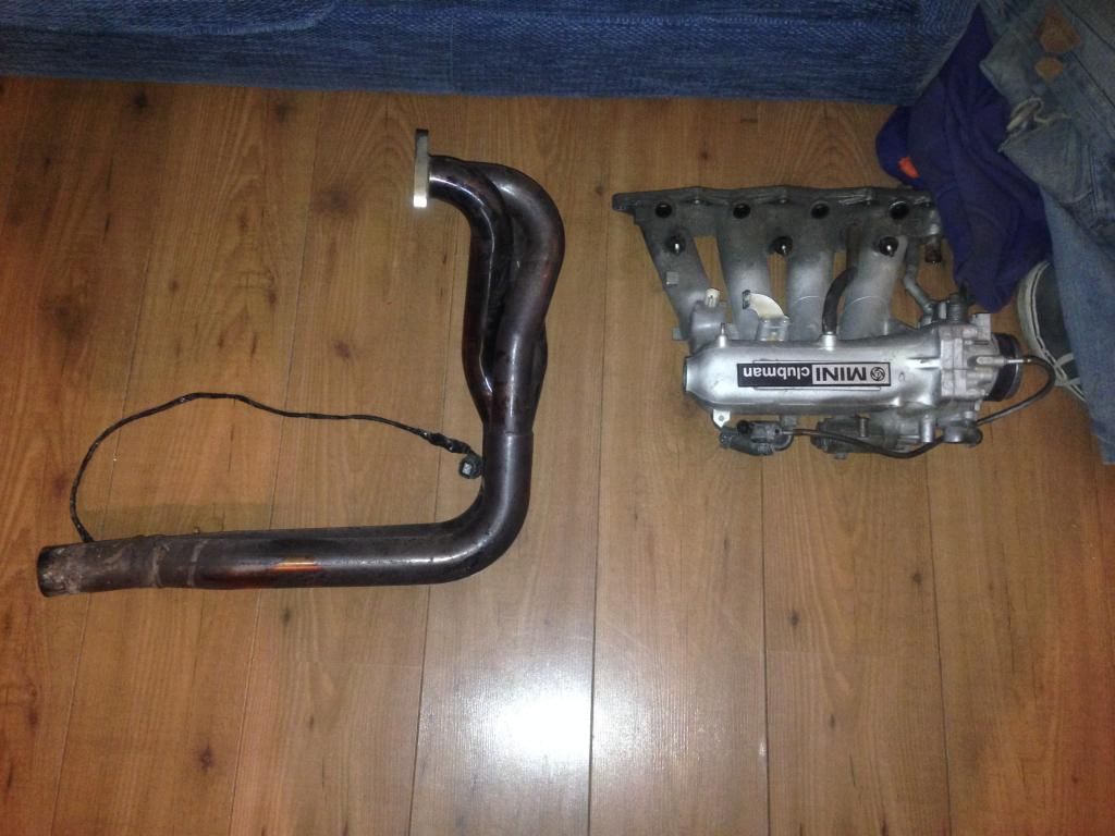

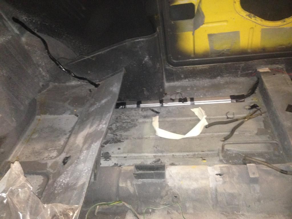

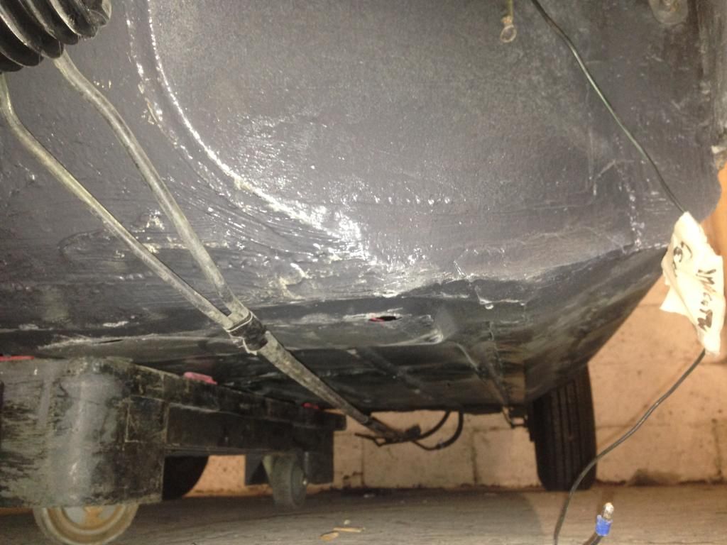

Loads done!!!! Engine out! Brake lines for whole car out and fitted to other one same as fuel lines and full loom gutted trimmed down tidyed up and fitted to clubby :) inlet manifold and exhaust manifold off engine and being sent to a mate and modified :) new shafts coming in morning so I can take the inners off and rebuild mine make em all new an shiny ;) gonna clean up everything tomoro and hopefully get engine in the car :) here's some pics of progress
Loom + new colum :)
Fuel sender wireing
Fuel lines
Mani and inlet :)
That's all for tonight :)
Would you not run the fuel and other lines inside the car?
Also, take the fuel sender wires down through the bottom of the rear bin rather than over it, just my €0.02.
Nope they run on the outside for a reason so I kept it dat way. :)

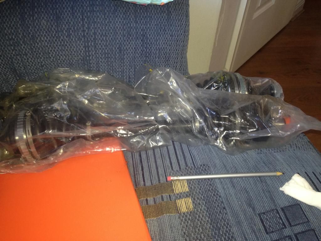

Just got 3 deliveries today
Number 1 is my two new type r integra shafts
I'm only using the inner cv joints for my honda/mini shafts
Number 2 is my gear shift extender for my buddyclub short shifter
Number 3 is my new arches with self tappers and rubber trim
Also my wheel nuts for my super trax,
Iv got no pics as they in back of car and herself is out :)

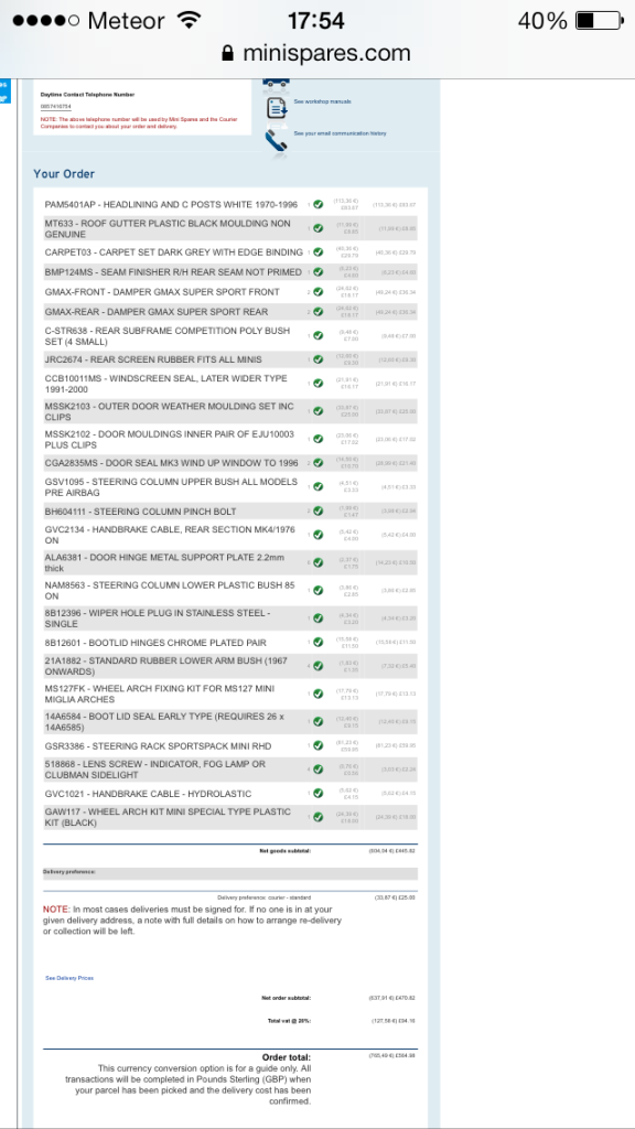

All I'm waiting for is my minispares order, which was placed over a week ago
Lately they're deliveries are taking a longggggghh time

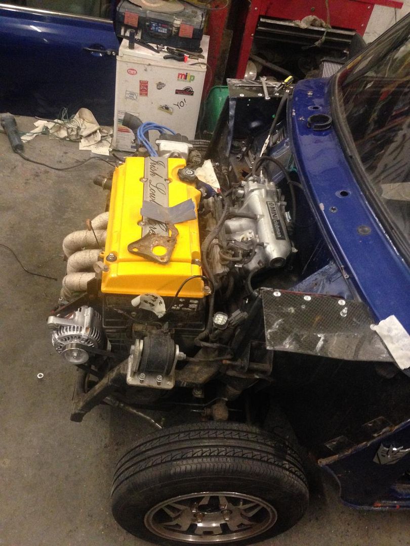

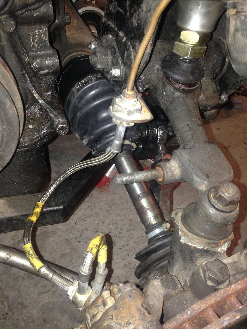

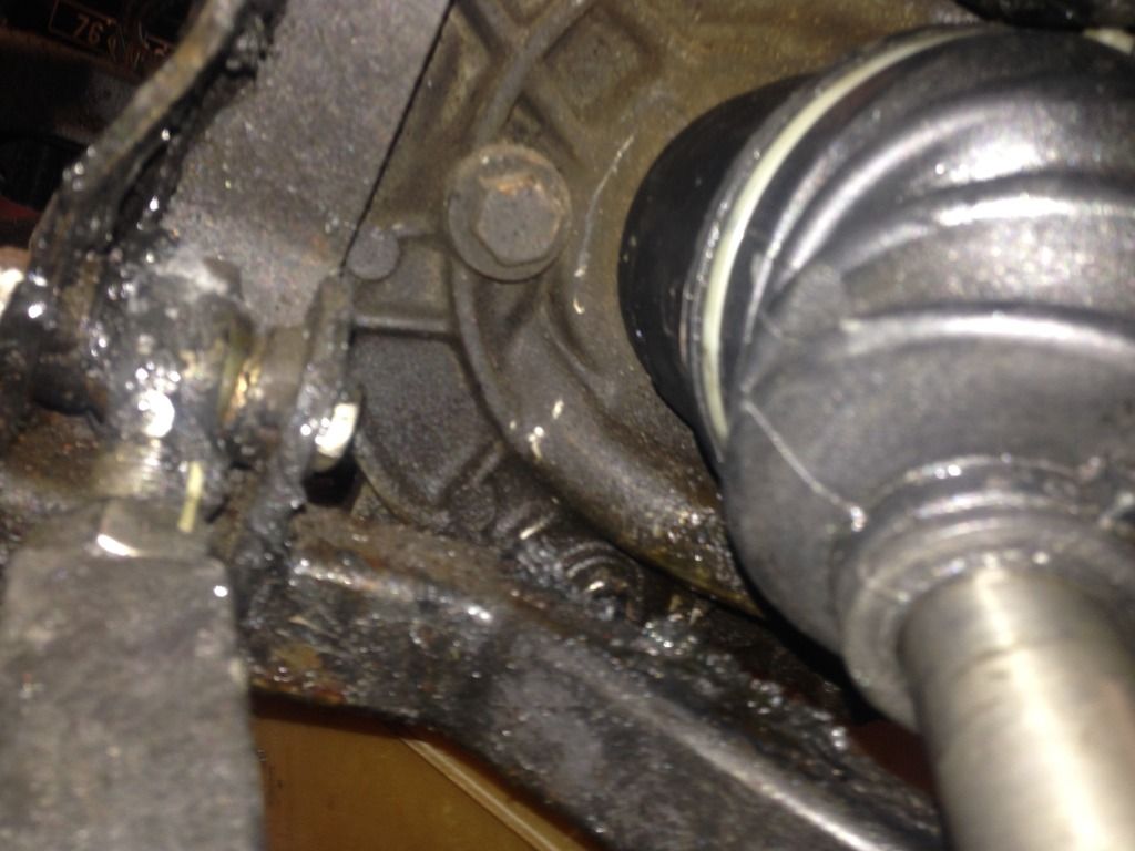

So got to it again tonight!!! Brought the new shafts down and split them :) and stripped the vtec ones out and cleaned em and refitted em :) cleaned up everything, fixed one of my lug bolts as one snapped and took the bottom arms off and adjusted a little then cleaned em up ! While I had everything stripped off(hubs,arms,brakes) my bro got cracking on the hi los and suspension cones ;) all in and looking great :) didn't take many pics as was full of grease :) but got few :)
:) I'm happy with how it's going, inlet and exhaust mani sent off today to get modified :) so until I get those back the engine cannot go in :/
