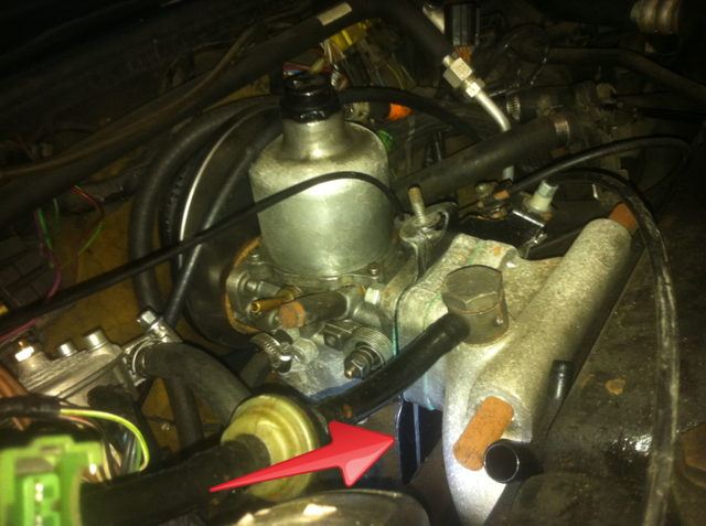

Also It seems the throttle sensor was removed when the carburettor was modified. Pic below, just in case I'm wrong!

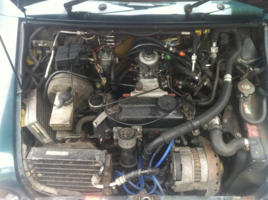

Looks like it a Filter King fuel filter o the left there below the fuse box. There should be a screw and wire clip underneath it to remove the bowl, careful now, as it'll have fuel in it when you do.
- Posts: 2837
Re: 94 jap cooper cutting out
Looking at the picture that looks like a combined filter /pressure regulator which would imply that the injection tank and pump and origional filter under the car have been retained.

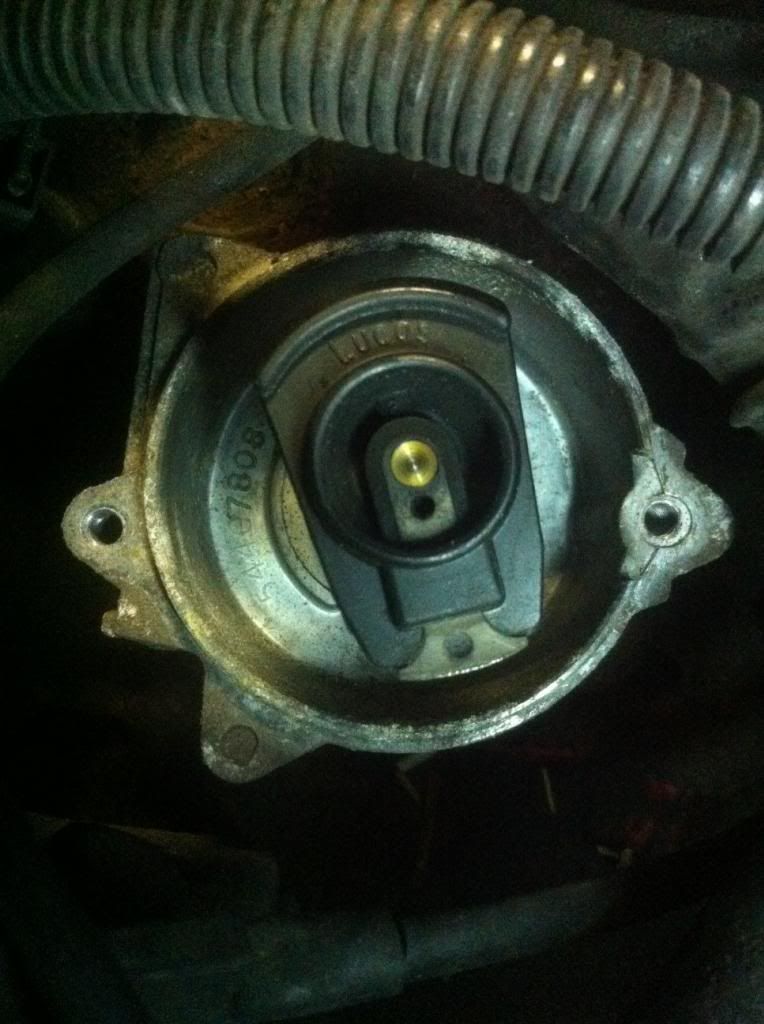

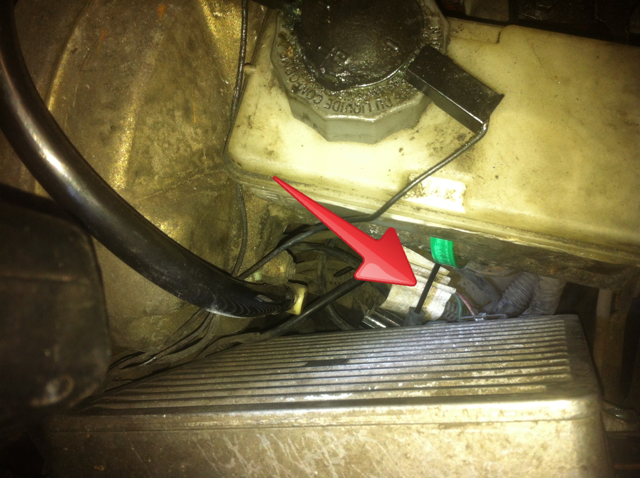

Woody - I searched for the crankshaft sensor, but couldn't find it. Hard to find anything under that bonnet to be honest!
Also I couldn't see any 5 digit number starting with a 4 on the distributor. Where should it be? Pics below of the distributor, it doesn't have points it's a rotor arm
Number reads 54403806 FR3

I'm not sure what the heat shield should look like, but the pic below shows something that looks like one. Not very big though?
Finally the small black pipe coming out of the front of the carb goes straight into the ECU. It sits into a small rubber bung at the bottom. Came out while I was following it - so i pushed it back in. No change
Pic Below
Number reads 54407808
Pic Below

Looking at the photos it isn't too cear but you may have something there that I've never seen or heard done before. Usualy when the injection system is replaced by a carb the dizzy is also replaced and the ECU removed along with all the redundent sensors. It appears that the ECU and SPi Dizzy may have been retained to control the ignition timing. Yould would need the dizzy number which is on the side of the dizzy( may need a mirror to see it ) to confirm this.

agree with woody.. sure looks like the injection throttle body & manifold was swapped for a carb & intake manifold.. everything else looks standard jap spi. if thats the case the fuel is fed from a high pressure pump in the tank. - hence the pressure regulator and return pipe.
the small black pipe from the manifold (or carb) to the ECU is a vacuum feed to the load sensor circuit in the ECU, it wont prevent the engine starting or running - it will run like a dog though - little or no advance, as the ECU thinks the engine is at full throttle.
if the ECU is still controlling the spark then the crank sensor is still needed.. I think if the crank sensor was faulty the car wouldn't start or run at all. this is looking more and more like fuel starvation - depends how it dies. does it shut off clean or sputtering? I assume the fuel pressure regulator is adjustable, perhaps its set too low as was mentioned before?
