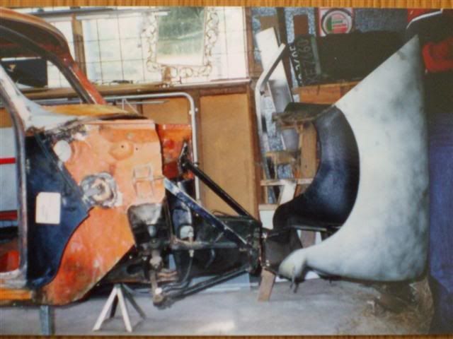

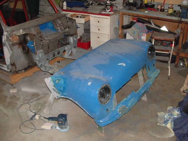

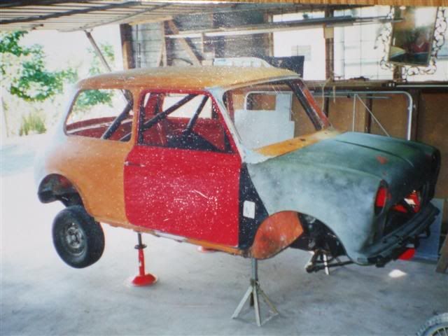

I had one on my race prepared mini back in NZ, it was lighter than any of the fibreglass ones others were using and also stood up to damage/repair far better than the fibreglass ones also. We made it on the car by welding the bonnet/wings and front section together (tacked) and then cut it off the car (front wheel arch). Then we cut, joined and welded the seams together.
Here is some photos
