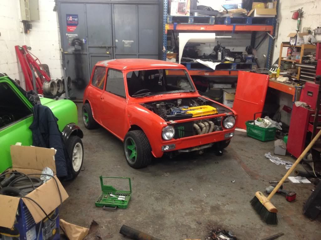

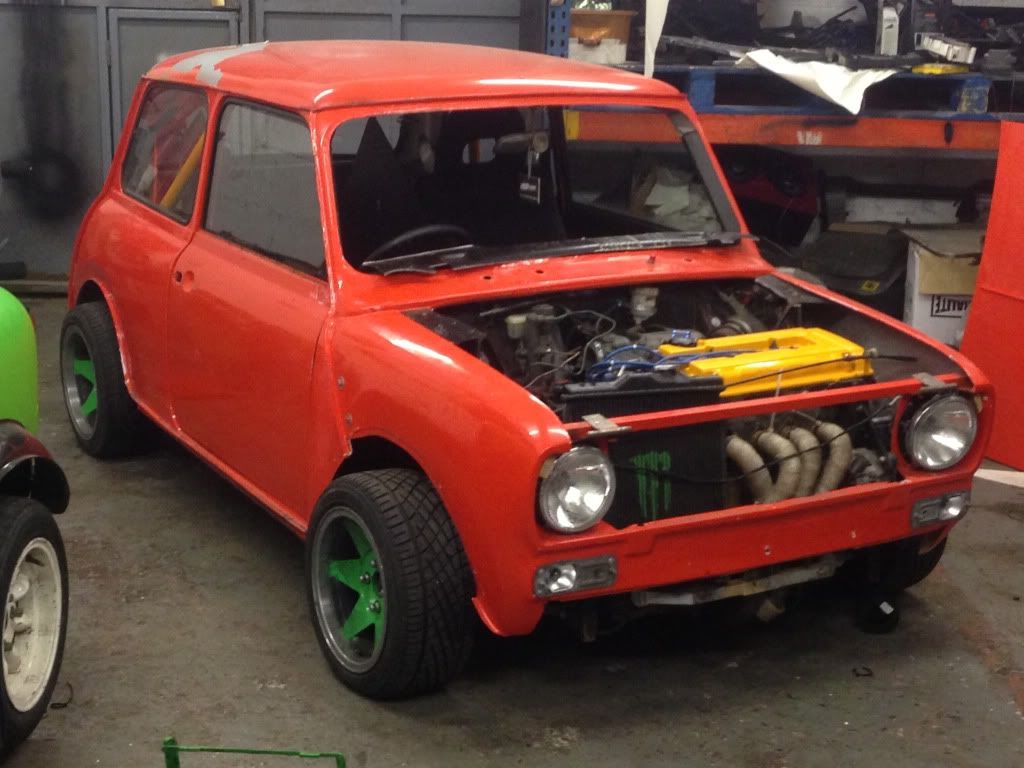

Few bits done! Gear shift shortens so I can reach it and short shifter extended :)
Indicators on, headlights in! Grill painted and on everything connected up and
Working fine! Just air filter and bonnet an windscreen need :)
Few more bits will be done tonight as I'm off work :)
Cheers and enjoy

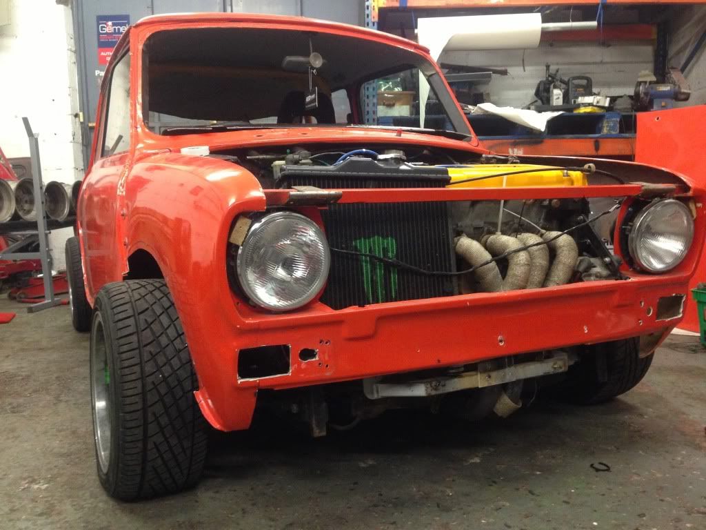

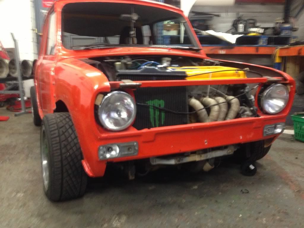

Great work so far, but those headlights look a little twisted to me. 8)
Re: My monster b16 dohc vtec mini project small update 16/2/
The Marcos Graveyard wrote:Great work so far, but those headlights look a little twisted to me. 8)
was just about to say that myself, show us a pic of the headlights straight on?
No dude there flat :/ they bang on :)
purplehaze wrote:No dude there flat :/ they bang on :)
yep they look flat alright but the light pattern when you turn them on looks like it will be all over the place,
the lines that run through the glass lens should all run vertical but they look to be off

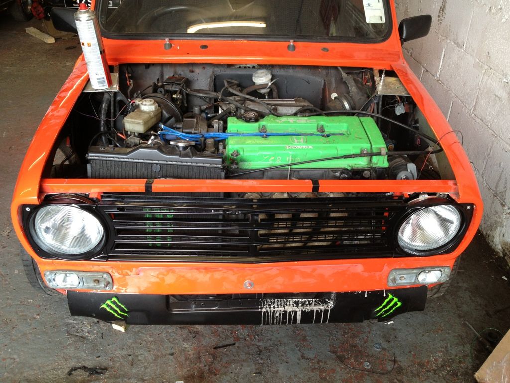

Nice n green
Another few lil bits to do! Find an altenator belt somewhere very hard to find rite size
:) enjoy
just get an old worn belt that is too long and cut it to the size you need (make sure the alternator is in all the way on the adjustment), then bring it to a motorfactors and ask can they get a belt that is the same size or very slightly bigger, you don't want to go smaller :wink:
Already did dat dude they either to big or to small!!!! Bit ****! Got a 737 one in halfords an is bit small! Next one up is 750 and is too big!!! No in between sizes! Il figure something out
Reason: language
can you get it to adjust a bit more?
Nope! Not that much room
Fit a different pulley or add an extra idler pulley ?

Plans plans plans ... None will be done lol. As for the headlights there not on strait I need to make plates to hold them the rite way round not good for nite driving but there in place for now

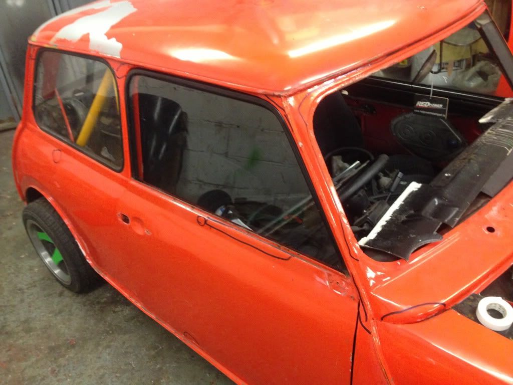

So the minis been Lying up for few months due to a problem :/ brakes!!!!!
Go rid of the servo ! Bled them and in the process burst a brake pipe ! One if the braided hoses was twisted and kinked so it let go!!! Ordered new ones an got em a while ago

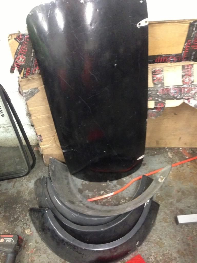

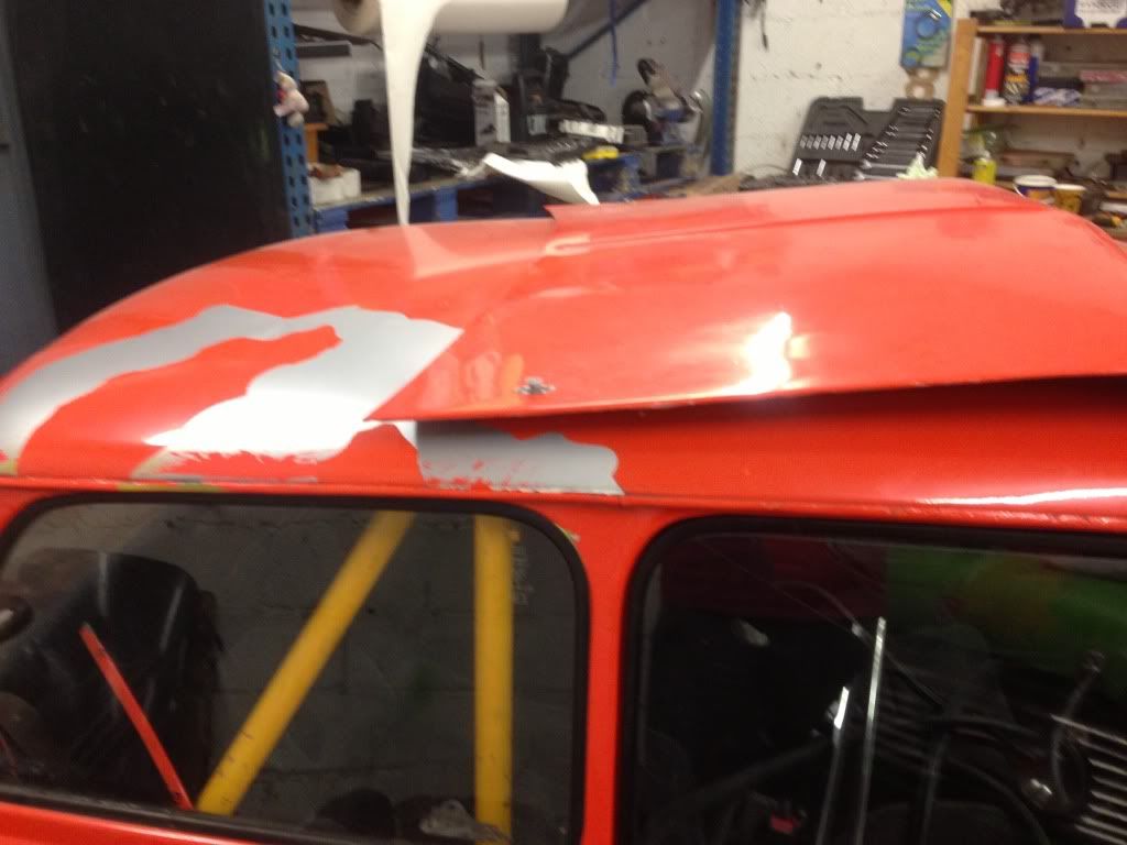

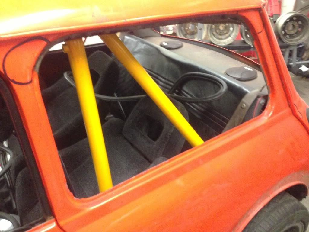

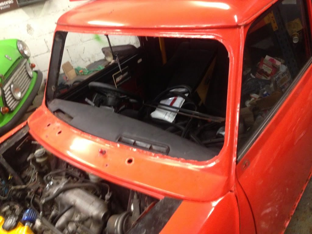

Ripped the monster stickers off and start stripping the car get it ready for paint
Got carbon arches an boot lid that need work so will be sprayed gloss black same as roof
Loads of work to do but will keep updated :D

Actually you can buy any alternator belt size you want. You might have to buy them online though. 742 should be easy to get. Are they 5pk's ( 5 grooves )
coolmini
Posts: 241
Joined: Mon Nov 07, 2011 9:45 pm
Whats your location?: Claremorris
Mayo
What Minis have you?: none right now
Modifications: sold that one, looking for a new project
Location: Mayo
Re: B16 mini rebuild time
Post by coolmini »
Sorry that was meant to be 745.
Generally intervals in 5 are easy to get.
