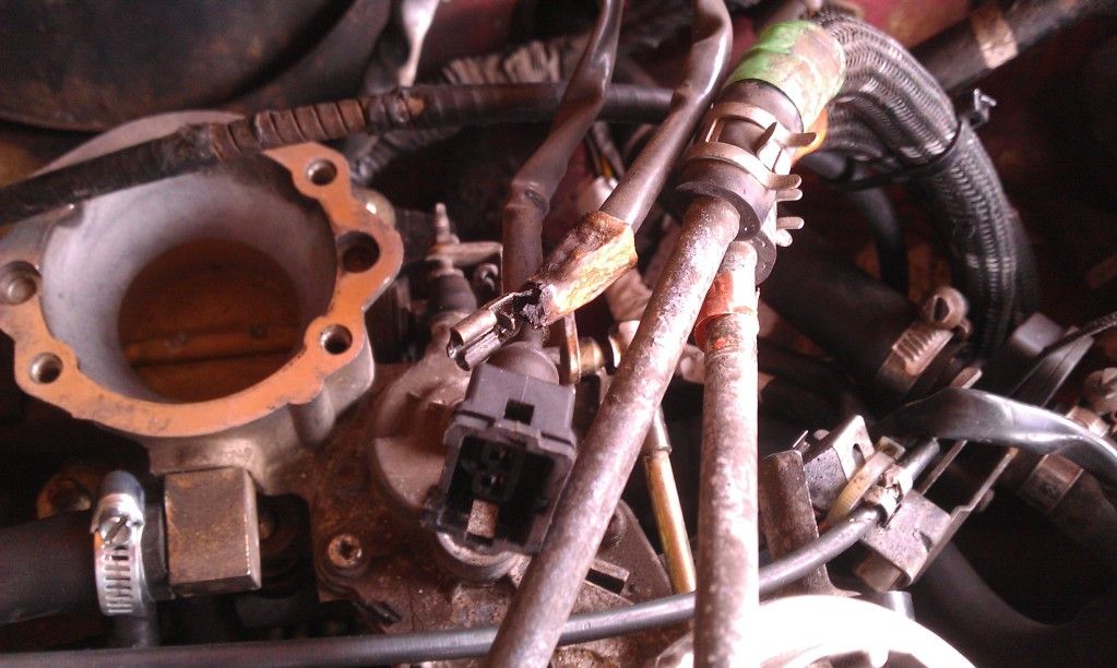

Im still putting this1380 into my mini and running it on spi injection system so I'm just connecting it all back up. But I've hit a snag as I've spare connectors and I'm not getting any power to the ignition not even dash lights. The connectors could be nothing as its a jap import and they could from the air con which has been removed I'm hoping I've just missed something and and electrical problems are related if people could identify these connectors it would be a great help

Top pick looks like the single wire goes to the bottom of the throttle body vissable from under neath and the the other black one looks like the one for the airfilter not sure about the bottom pic
Re: have a bit of troublewith the mini again!
THink the single one is the manifold heater underneith the inlet manifold.
Black plug may be thottle motor just below it in the pic.
Brown plug looks like lamba sensor located on exhaust manifold.
Can you tell us the number and colours of cables in plugs.
None of these would prevent the dash from powering up.I sujest you look at the brown connections at the starter motor,

single wire is the manifold heater underneat the carb the black one goes to the injector on the side of the carb near the green conector for the air box the red one looks like air condition conector as its not on my spi lamba sensor has four wires and is black no power is your earths or starter motor not conected properly

Will check the strter motor connections tomorrow. The throttle body is already connected but don't reember if I plugged in the lambda yet will have a look on the manifold for the single connection aswell. Thanks for the help

brown 1 looks like the 1 that goes into the air con bottle thats up bside brake servo,

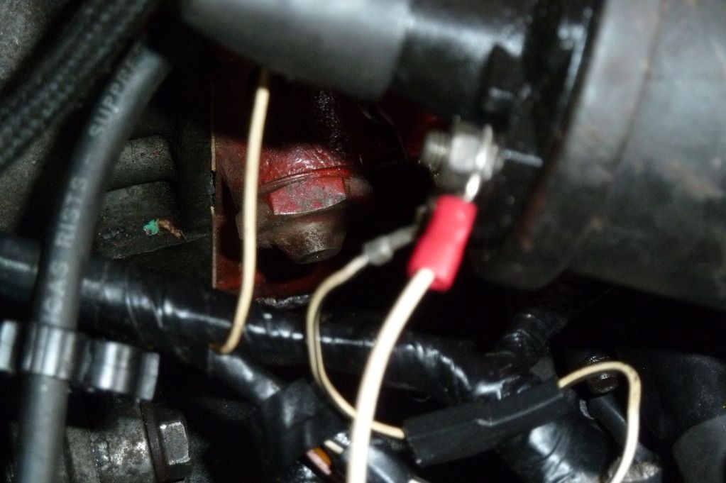

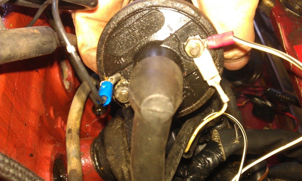

I haven't found any connections for the above pics but i did have the starter motor wired up wrong lost a connection int the mess of wires. My new problem is I'm not getting any spark now I'm sure its something I've done rather then a problem with the car so if someone could post of a picture of how they have wired up there coil on an spi I would really appreciate it thanks

I checked the wires theres 3 black and white wires which come out of the the loom and the black cable for the ballast for the coil.
Need more details here.The car is a jap import ,there are two types of jap SPi, need the year and was it auto or manual. Need a picture and any part numbers of the coil and connections.
Give me the colours of the cables in the connectors in the first pictures.

its a 96 although I think it wad manufactured in 95 its a manual
the connectors are black
I will get the brand of coil in a litle bit buts all standard spi
I can see its a Ducillier coil, there should me a number stamped on the bottom of it.You said there are 3 black and white wires but in in the picture I see only 2 white/black wires ( Its important to note the main wire colour first and then the tracer colour) .Need to see where the black wire is going, you mentioned a ballest. A general picture of the whole engine bay may also help.

The wires are exactly the same white with a black tracer there no.s are 1 with a up on the other side of the connections and the other connector has 15 with +bat. the black wire is just going to the ballast
