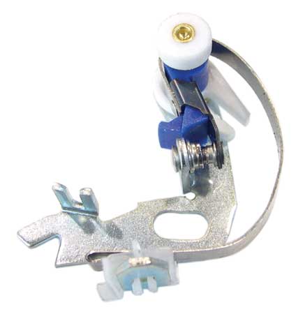

If you take the dizzy cap off and look underneath the rotor and you have a set of these, then you have points.
http://www.minimania.com/imagesbig/gcs124.jpg

1989, Metro engine, 9.75:1 compression ratio, leaded head.
Probably a Lucas 45D distributor with blue points.
