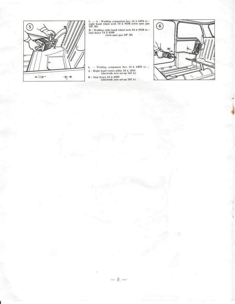

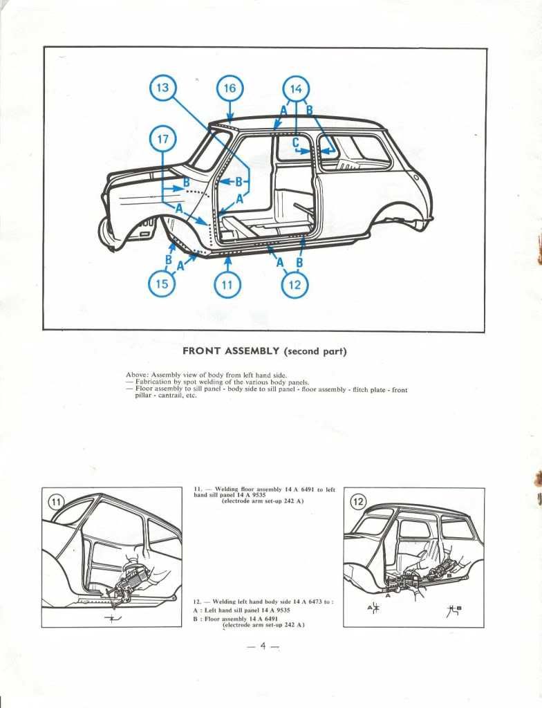

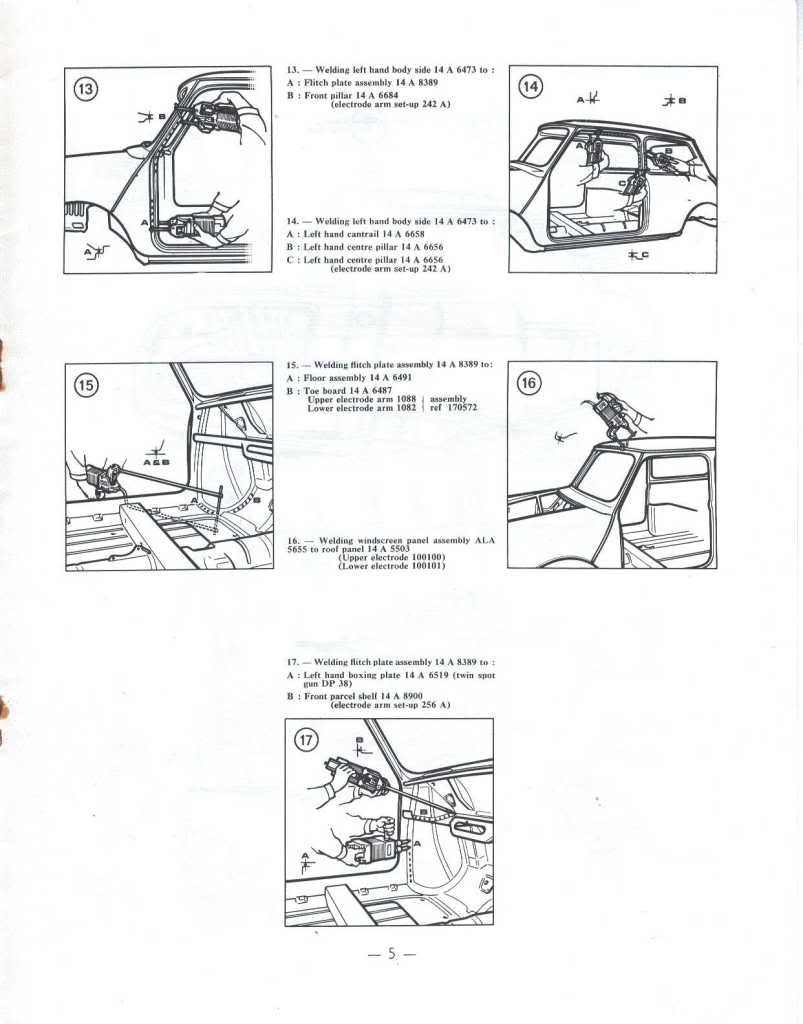

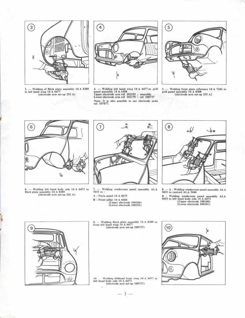

got this ages ago.... 8)
just a pity i dont have a spot welder... :roll:
steven
some day....
