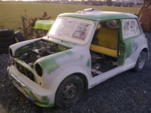

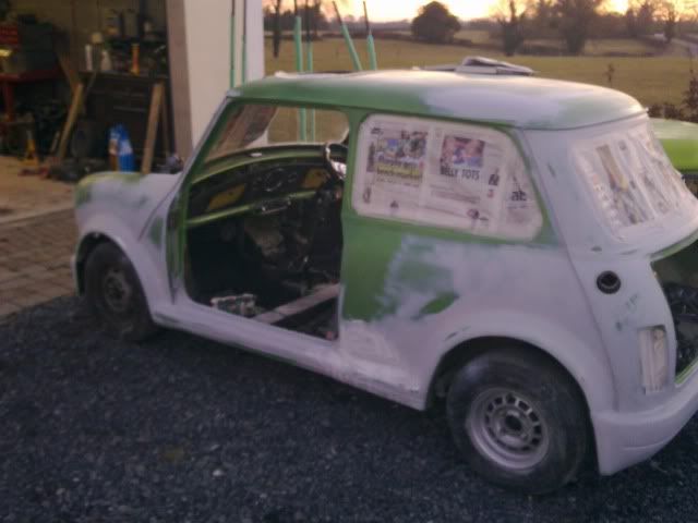

this is mini city, got it few months ago was just ashell.its an english car, came from there start of last year ithink.
it need new drivers wing a pannel an small patch on the floor. it had abody kit fited but the previous owner took an angle grinder to it and cut it off, igot it an pieced it back togelther on the car, got an engine from an 86mayfair, its fitted to the car now just needs wired up. have the wing a pannel and the floor all welded up. the body kit is moulded on to the car, just have to finish sanding down the car now ready for some primer, my neighbour is going to paint it for me in his body shop, hes keepin me right getting it ready for paint. car is going to stay the same colour with yellow an black interior have yellow bucket seats igot with it. heres afew pics

nice nice... so this is the car you were on about 8)
get some more pics up and make em a bit bigger :P

itook them on the phone icant get them to go any bigger,

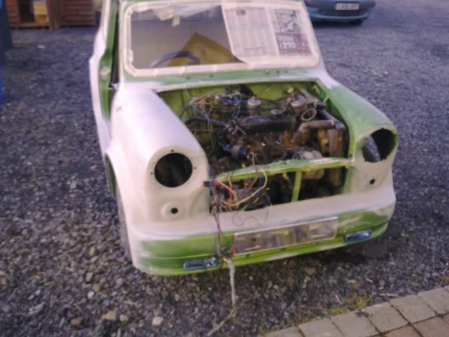

the engine i put in the car has a pre-engaged starter. the wiring in the engine bay had the solinoid for the older starter. i removed this and took the wires direct to the starter. ihave power in the ingition wire going to the starter solinoid but when iturn the key theres nothin. not even a click. the starter is working perfectly so its not that. im not to well up on wiring so im not sure what to check to sort it out :? , any ideas have igone wrong some were removing the other solinoid any help appricated

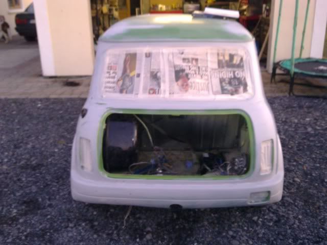

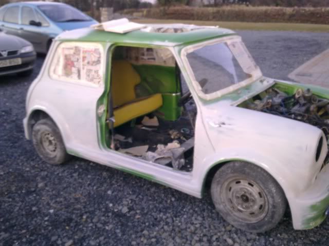

few pics of the car now,
its got a coat of primer needs an other coat yet,
still tryin to get the engine running its turning over now but havnt got it started yet.
changed the carb as it wasnt the best looking when took it apart. goina try a differant
distributor on it as well.its not the in best shape either. gettin there slowly.

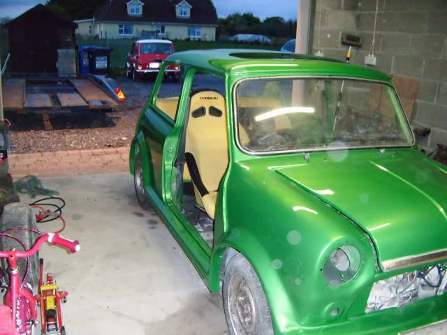

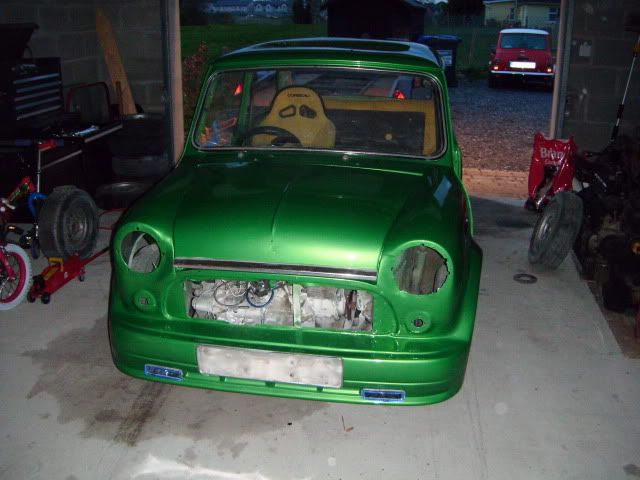

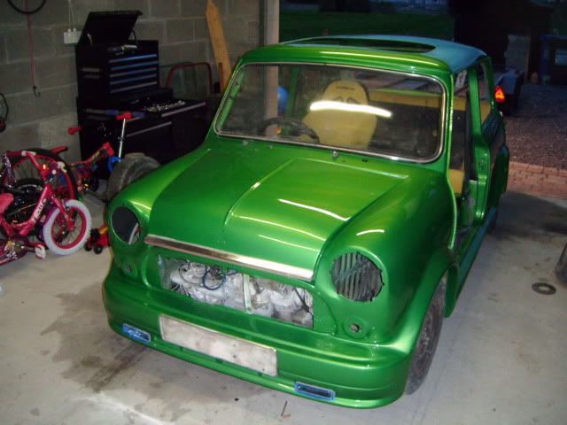

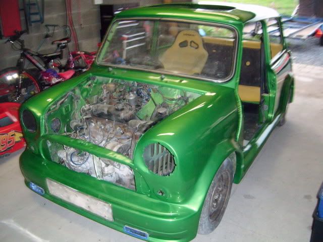

got the car back from the painters lastnite, looks really well. painted nissan apple green,
same colour as it was. geting the four seam strips painted anice shiny black,
just few bits to get now so ican get it back togelther

Re: 82 MINI CITY E
Great colour :D
Re: 82 MINI CITY E
lovely paint job danny, id say ur well chuffed!!!!
Re: 82 MINI CITY E
LOOKING good there Danny.. .. . 8)
Re: 82 MINI CITY E
You should put in a blue interior to make it realy stand out
where did u think of dAt colour ?
Re: 82 MINI CITY E
joeyfinneran wrote:You should put in a blue interior to make it realy stand out
if he's gonna use the yellow interior i saw in it last it'l defo stand out!!
i'd saw u'r delighted not to have to do any more sanding on it, it's looking really well

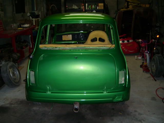

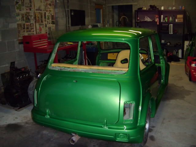

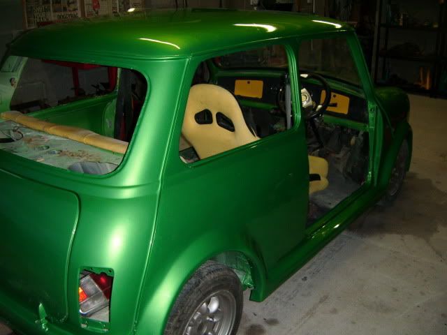

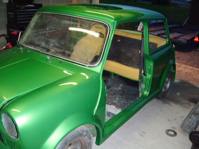

Few bits for 82mini city
Post by skelly »
Yea the im doin the interior yellow and black. Seats are all yellow an getin yellow door cards with black thro the middle. It turned out better than ithought it would. Lota sandin 2get the archs 2look right. Its not perfect few little bits imissed. Never did body work like that b4 so realy happy with the way it turned out.
