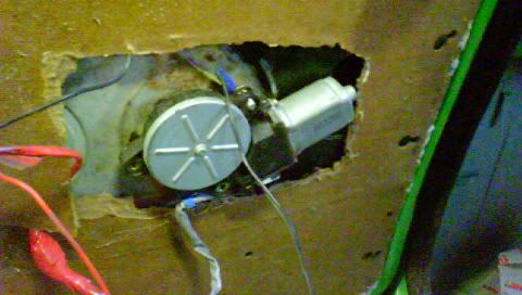

i have electric windows in my mini, modified a set from a honda integra!!!!!!!

whiskersdolmio wrote:Electric windows can be fitted to all minis apart from MPi minis. These had additional side impact bars fitted and so don't have the clearace.

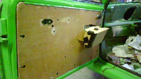

the honda ones fit behind the door card against the reg! i'll get up a pic of mine l8r, door card has to be modified

Re: Electric windows.
mine is a 88 door, the motor bolts to the door inside the car instead of inside the door!
bit of everythin really! integra motors and fiat punto switches!!!! honda ones are more complicated
AS PROMISED

Kenneth Murphy wrote:AS PROMISED
thanks Kenneth, that's an mpi yeah? Are you using switches or the old winders?
its a 79 usin switches
